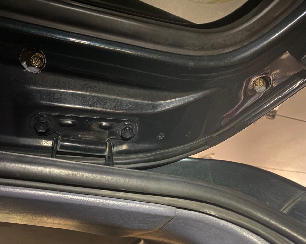

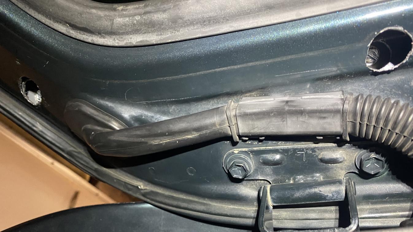

Covering the holes
Hey guys, has anyone figured out a good way to plug the holes up on the inside of the hatch? So far I used some Dorman diaphragm grommets and they work alright, the problem is that the holes drilled are more ovular than circle so it was hard trying to find one that fits in the hole in the first place but they still don't really fit that well
Here's an example of what I used :https://www.oreillyauto.com/detail/c/dorman-conduct-tite/dorman-conduct-tite-diaphragm-grommet/cti0/90303/v/a/7921/automotive-suv-1998-toyota-4runner?q=dorman+grommet&pos=4
They aren't exactly supposed to be used for the purpose I used it for but gotta make do with what you got.
Here's some pics of what my hatch holes look like. I could remove more material to make them circular to work better with the diaphragm grommets but I don't feel like taking more material off & I don't really like the grommet fix anyways.
