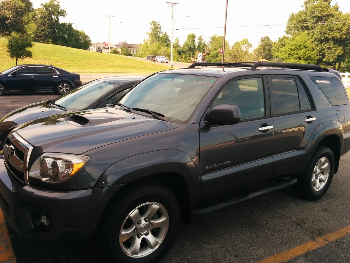

Good news is I found another one just as good if not better it's an 06 Sport with about 85k. Just picked it up yesterday. I'm a happy camper now :D
