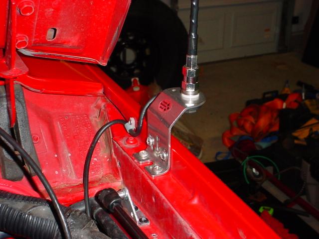

the fender bolts between the hood and fender is a popular one as well.
