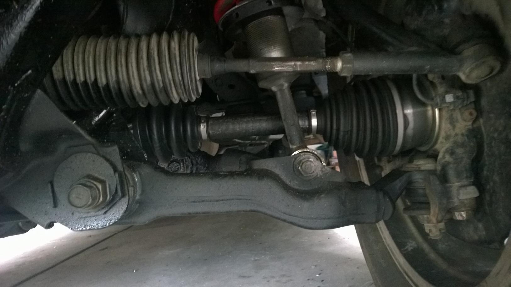

I'll find out how they hold up with a 2.75" lift and no diff drop. CV angles look good to me at 2.75", the pic is in the garage on level ground.
