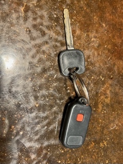

I’m trying to upload a pic but it keeps telling me upload failed. The top of the key is thin black plastic. Nothing like the thickness of our 2016 highlander or 2017 tundra. It’s also generic. I don’t think it has a chip in there. Does that mean it does not have an immobilizer?
Your image is too big. If you resize it to a smaller resolution/file size you can upload it.
