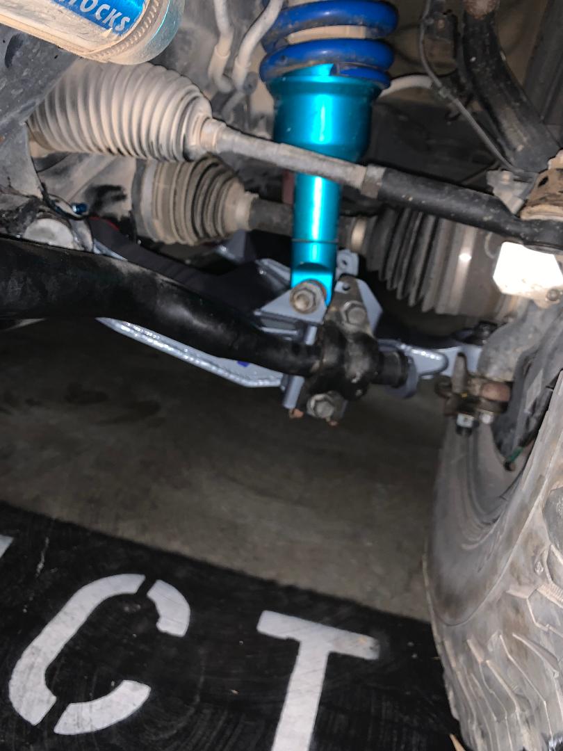

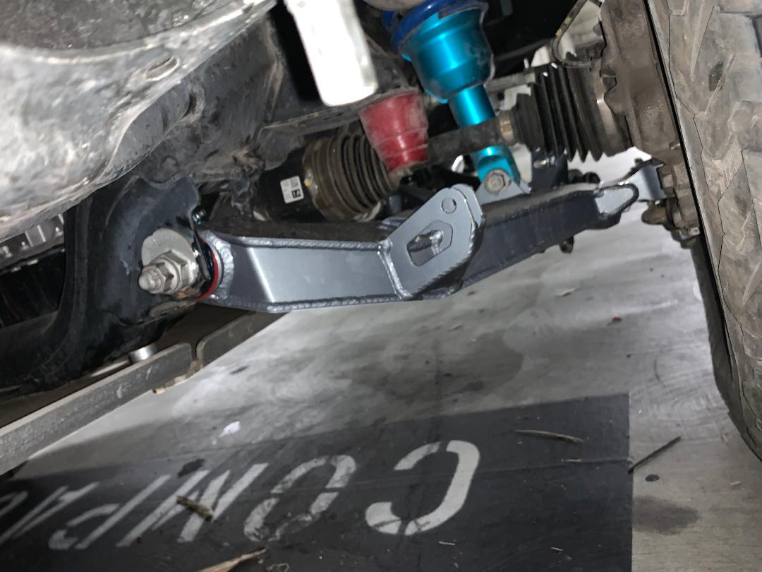

Would these lowers be compatible with a Icon delta joint UCA on a KDSS truck?
KENNY POWERS! lol.
the expedition lowers should be compatible as theyre standard length or the same length as OEM.
im still on the fence if i want these and pair with the tundra 3.0 coilovers. :\
I’m interested in getting a set of lower control arms. How are the bushings greased without throwing off the alignment? Since the cam bolts get loosened when to bushing maintenance.
I painted reference marks on the cams with a small brush and loosened the retaining bolts just enough to take the pressure off the bushings. If your careful the cams shouldn't move at all and you have the marks to make sure they aren't.
Correct! 3.0s will work with the Expedition Series. We offer both KDSS and non-KDSS models. You can run the larger diameter shock with either
