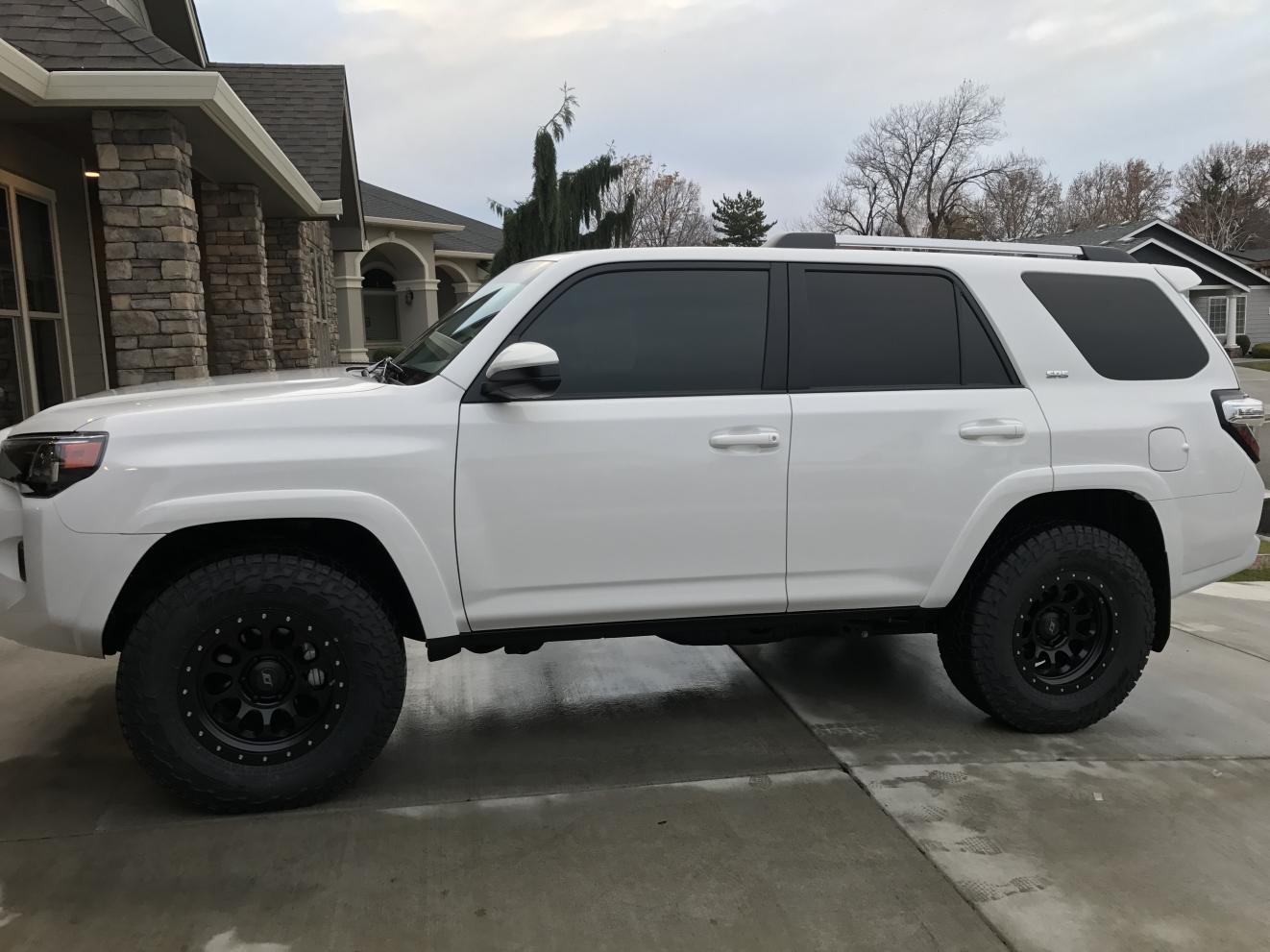

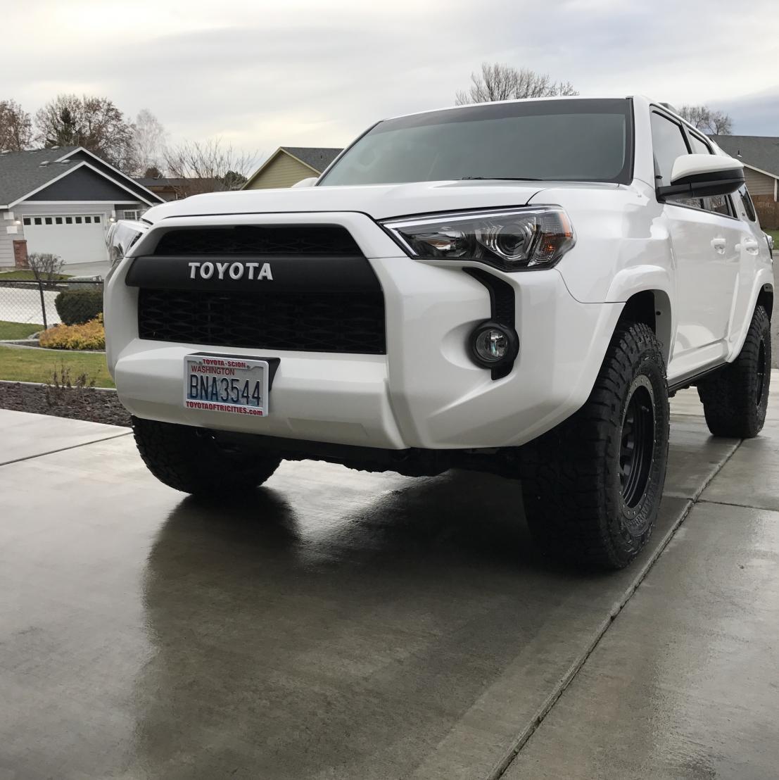

On my wifes runner..275s on ray10s on stock 2019 sr5..been waiting for my Lift to show up but couldn't wait anymore so we threw on the wheels/tires.. had to remove mud flaps.. but no rubbing exept for a tiny tiny bit on front bumper when goin in reverse at full lock..other than that they fit no problem.. now would i go wheel hard off road with this set up probably not.. but for daily city driving it works! Love the set up smooth and quiet!!

Looks good [MENTION=288290]Sledneck05[/MENTION]! I just ordered a set of 275's and waiting for them to come in, so thanks for giving me an idea of how they look.
What size rims are your Ray10's and are you running a spacer??
Thanks!! They are 17x8.5 -10 offset and no wheel spacers
