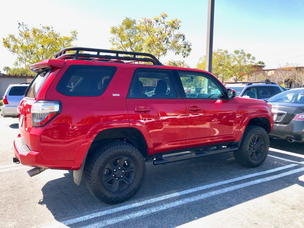

the only regret for me going with AT3W's is that i got the 265 instead of 275. just because if i wanted to lift it, the smaller tires are gonna look stupid.
I don't think the 265's look stupid on a 2.5/2 lift, but that's just me. I just installed the lift this weekend. This was the day after the install so it may settle a bit more.
