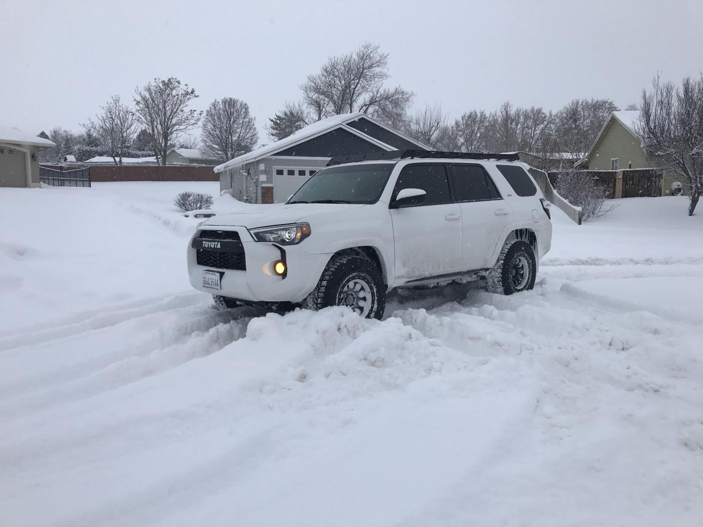

Just installed 275/70/17 on trd 17×7 wheels. I have 2.5/1 inch spacers and zero rubbing.

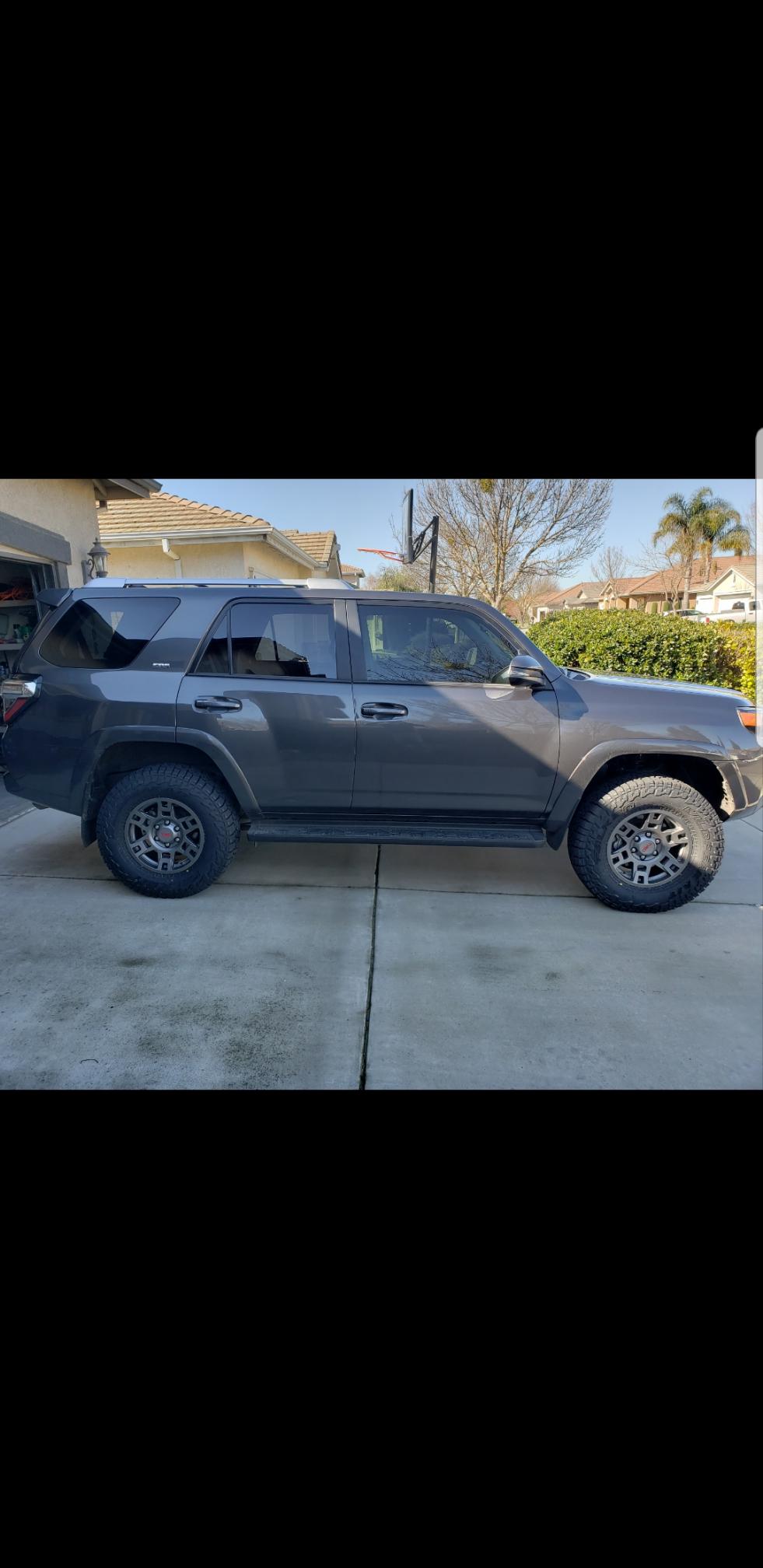

Installed fn fix pro wheels with 265/70/17 and I’m getting rubbing on the front mudflap at full lock out. I’m surprised since I’m using the same tire size as stock. I understand the wheels are a different offset but figure I would still be fine.
Does everyone usually do the heat gun trick or is there a third part mudflap that looks good?

Spacer on there as well?
Most seem to trim or just remove mudflap.
I tried the heat gun method. Didn't work for me and I basically ruined the mudflap. I just took both off. It's possible that the heat gun method would work if you had more room than I did. I am ok with the result with them off. Gets some dirt on the doors during rainy weather but I can live with that.

No spacer. It just rubs when I fully turn to the right. Think I’m going to try and sand down the mudflap and see if that does it.
