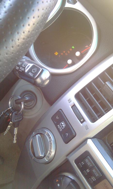

Finally, I installed my body lift and had time to check this mod. I was surprised when discovered that it works perfect in 2wd mode. You do not need to switch it to 4wd and 2wd back to make it work. :banana:
