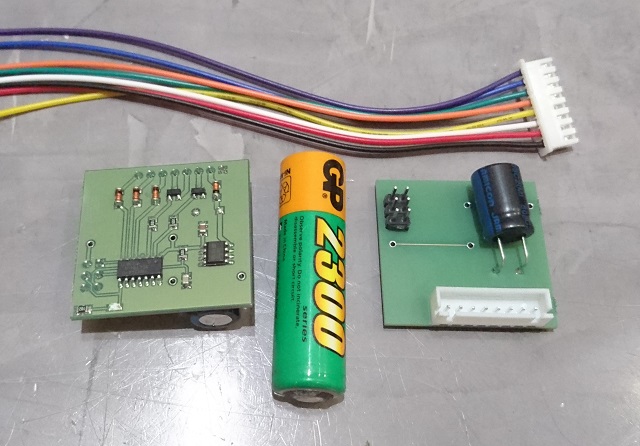

New fine-grained VSC OFF Mod for V6 1GR
Kliv
For these of you who do not really want to surf through the whole thread:
Link to install instructions:
Install Instructions_4.3 - Google Docs
Shopping list for FJ-like install: https://www.toyota-4runner.org/997844-post120.html

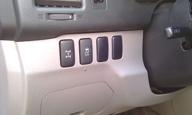

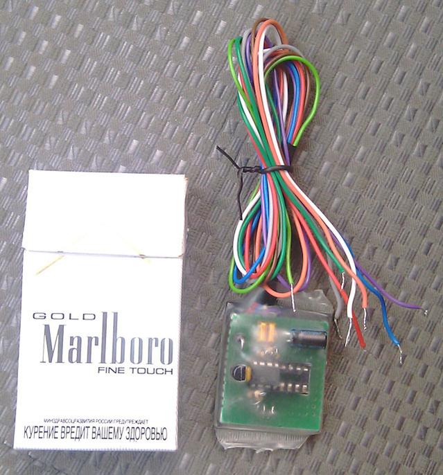

We made small box 35X30X10mm with 10 wires adopted to work with 03-07 V6 4WD 4Runner!!! It connects to FJ like Trac off button (or any button with no locking), VSC ECU cable and combination metter. It has 5V red LED for activity indication.
As the result we got:
- Ability to switch off Traction control with no center diff locking. It does not affect ABS or A-Trac. There is no confusing lamp about center diff lock lightening as well !!!!
- Block does not affect other systems. It switches off with power off and with center diff locking.
- It is small and can be easily installed. All you need is a button and an hour of your precious time.
I tested it on my V6 4R’04. It works perfect! Originally I planned it for personal use, but, if you are interested in the mod we can discuss it :naughty:
Some pictures below (I quit smoking, just found a pack to compare with :) )...

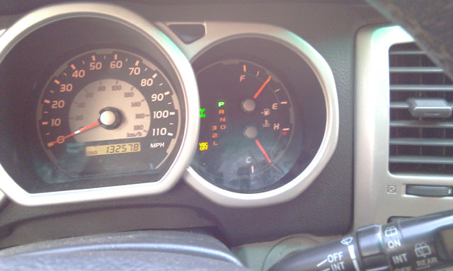

Combination meter with VSC off block working.

how's it wired in?
It is based on the mod I linked above. The only difference is that it manages center diff lock lamp plus several useful options like switching off with ignition off or after center diff locking, do nothing when VSC is off already, etc..
Installation takes about half an hour - hour. There are 4 wires to connect behind cobination metter, 1 to VCS ECU under steering column, 1 to center diff lock button, 1 to trac off button, ground point and LED. As for other Trac off button wires (lightening & ground) - I took them from center diff lock button.
