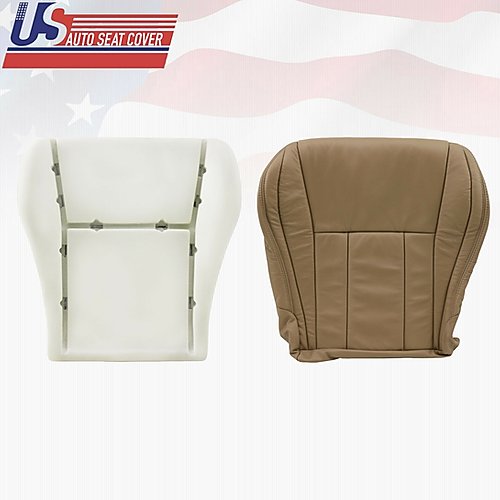

Exactly. The foam below breaks down pretty badly even though it's protected by the covers. I just replaced all my front leather and the company sold me two brand new bottom foams which are very high quality and fantastic to sit on. When I got in the truck my head almost touched the headliner like it did back when I first bought it! :cowboy:
For some reason, this company doesn't offer the uppers and I'm pretty sure they are NLA from Toyota.
As far as the cloth seats, I'd be a little surprised if the frame/foam wasn't identical to the leather versions.

Found them on ebay, but did the deal through their website to customize my package. Had it narrowed down to 2 companies but went with US Auto Seat Cover. My interior is Oak leather, and these covers are absolutely spot on to the rest of my interior.
This was my first time to mess with any kind of upholstery and it really was pretty easy. I added heated seat inserts or it would have been even easier. Just need a cheap hog ring kit off amazon and then it's strip off the old on slide on the new.
The bottoms fit perfectly and the tops are just ever so slightly bunchy. I really suspect that is due this very issue of putting new leather over old worn out seat uppers :wacko:.
