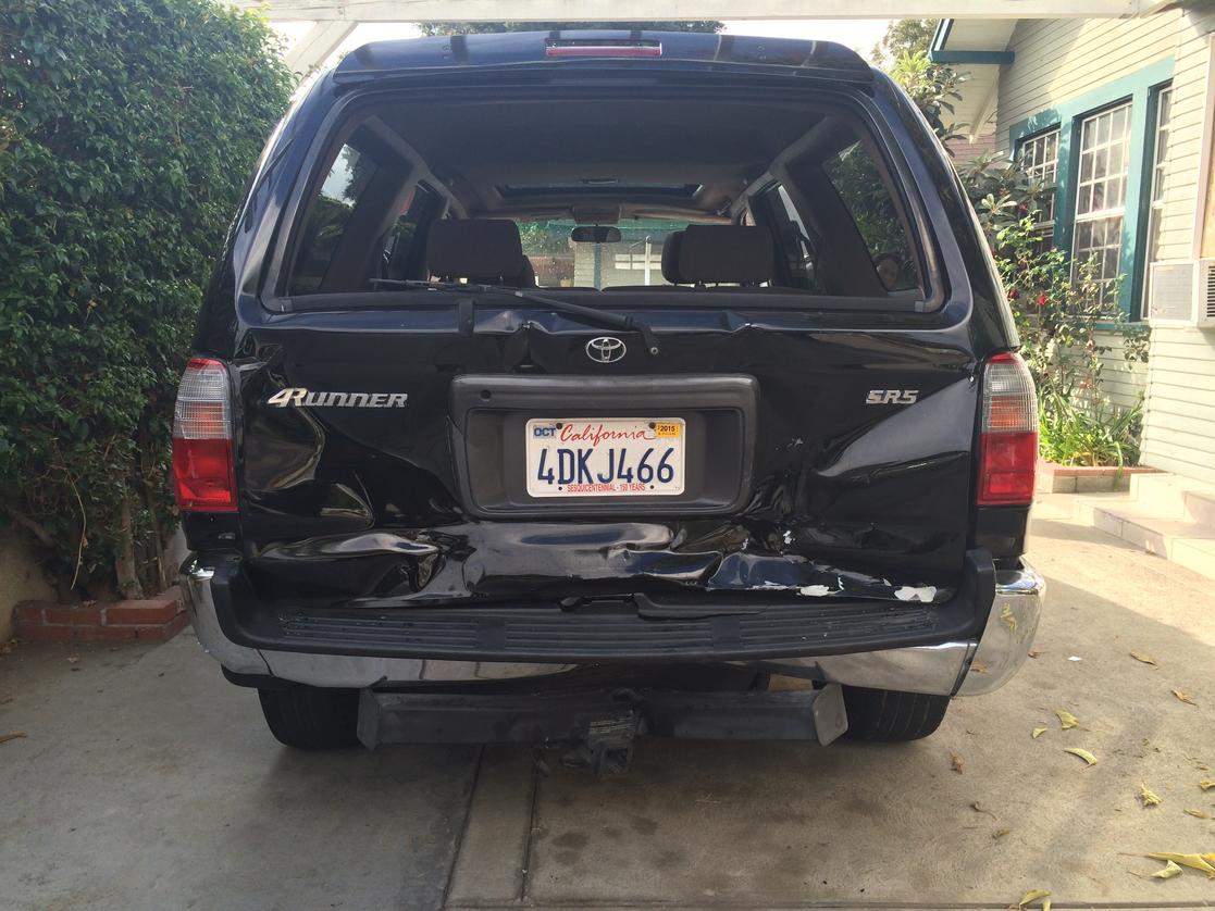

Well, here's the scenario for starters. I'm waiting at a red light and this guy (possibly drunk) rear ends me at about 40-50 mph. My tailgate is pretty much useless. I have to take the battery out after using it to prevent it from dyin because the door isn't marking that it's closed. It doesn't latch. Right now my solution is holding down the door with ropes tied to the rear seats. Had to work with what I had. The window also shattered. Like I said the bumper, tow hitch, and spare tire took a lot of the impact. Also, apparently the hit was so hard that it knocked my audio and ac control panel down. I also felt that the driver seat was loose and thought it was just a screw that might have come off, but the whole metal broke and now that's just more stuff to add to the list of things wrong with my truck. :(
I know it doesn't look that bad! But trust me my heart breaks for my baby.

Can almost guarantee you've got a bent frame, just from looking at that tow hitch. May not be the end of the world, because you've got a solid axle in the rear and no alignment to mess up, but before you go spending money on parts somebody needs to crawl under the truck and have a good hard look.
What does the body look like under the tailgate and bumper? I'm worried you've got some damage there too and the new tailgate won't line up.

[MENTION=118530]Jackiee[/MENTION], KidVermicious is right. After looking at your photo, I agree that you really need to get the frame checked out. That bent tow hitch means that your frame took one hell of a blow and it very likely will need to be straightened out, which I am sorry to say, your husband will probably NOT be able to do without the right equipment (the sort that is only available at a body shop). That being said, while your bumper may be salvageable, that tailgate is NOT. I would definitely check out auto salvage/used auto part shops to replace it. Yes, a used tailgate will probably have to be painted to match, but so would a new replacement; not to mention that the used part will already have all of the hardware and ancillary parts and mechanisms already installed. Sorry that happened to you: been there before, myself.
