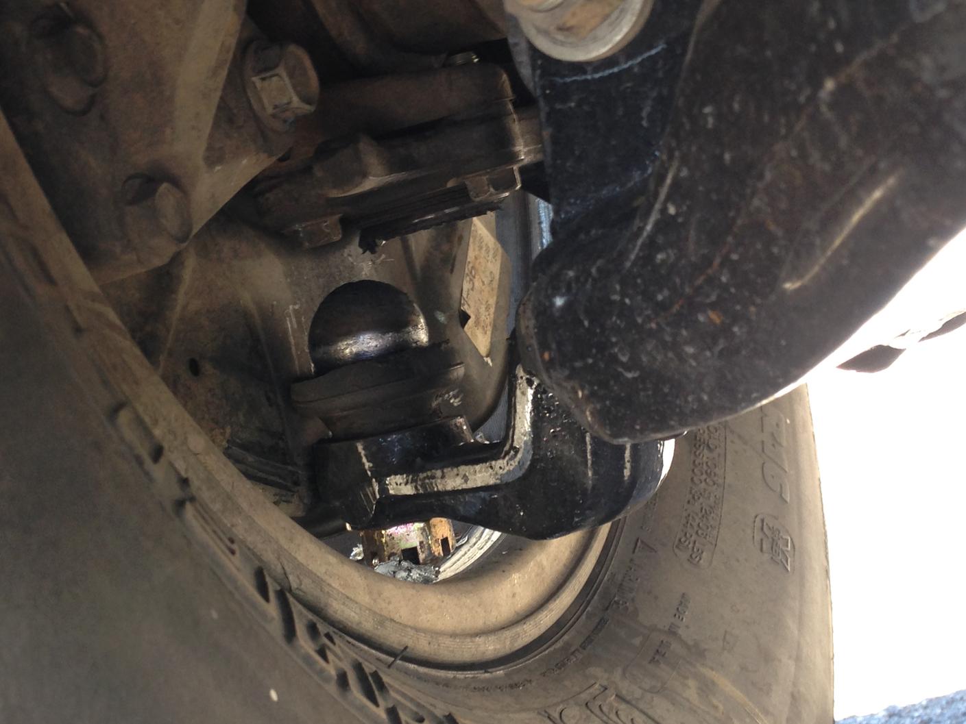

At 128,000 miles in Feb 2015 the right lower ball joint (same side the lower control arm was replaced 1,000 miles ago) failed. Luckily in a parking lot. The dealership replaced the right lower ball joint.
Failed lower ball joint photo.

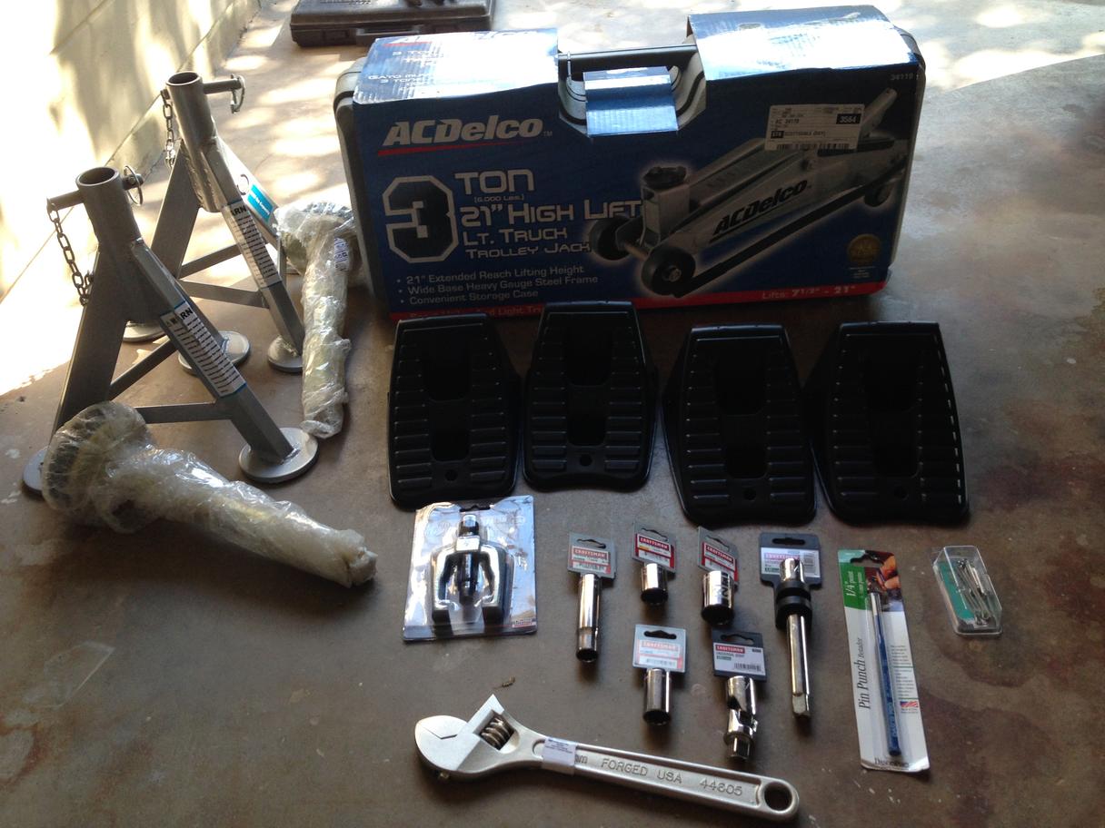

I didn’t own a jack or jack stand so I got to buy some new toys. And based on the posts here I knew I also needed a few new tools. I spent a few hundred dollars but I can use this stuff for many years.
Here are the new toys I got for the project.

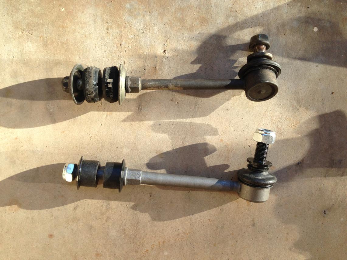

I would buy OEM sway bar end links if I had it to do over - I was not impressed with the Adelco links I bought. The bushings and plates on top an bottom of the bushings were lessor quality (I actually re-used the OEM plates).
OEM vs. Adelco sway bar end links

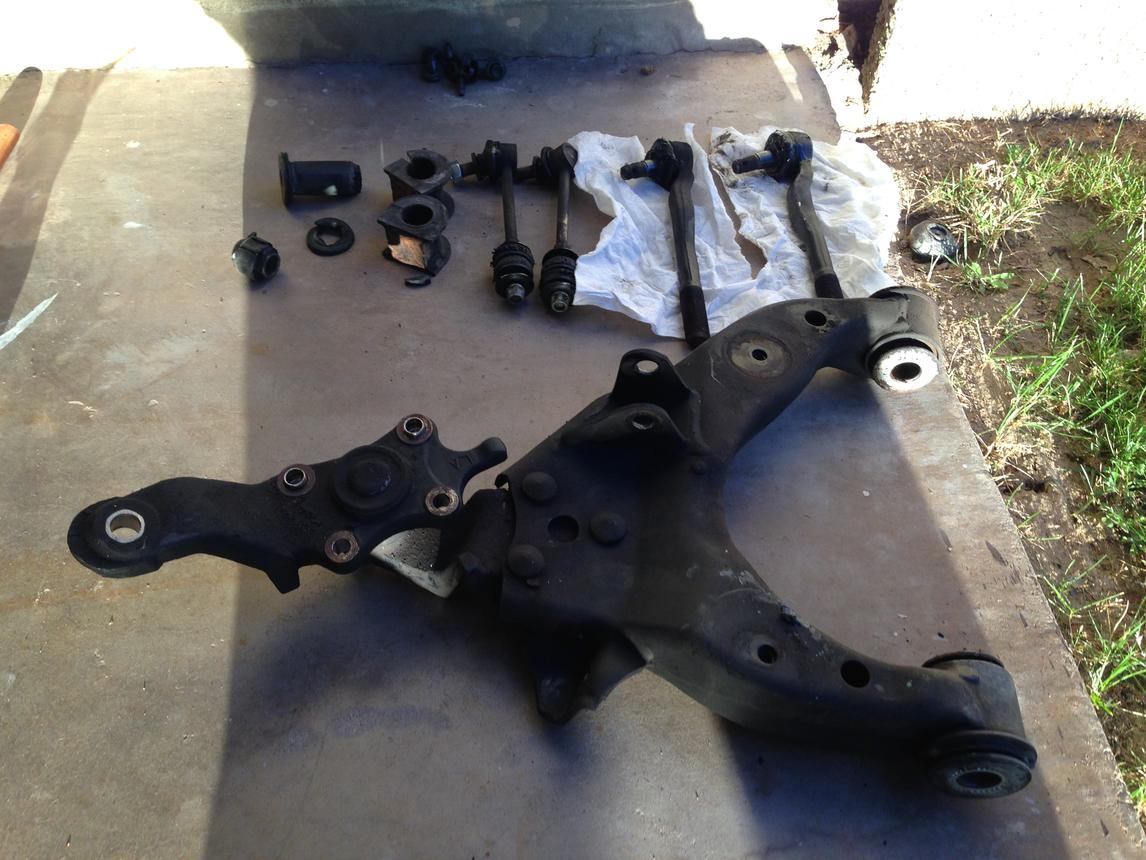

The parts I took off the truck.

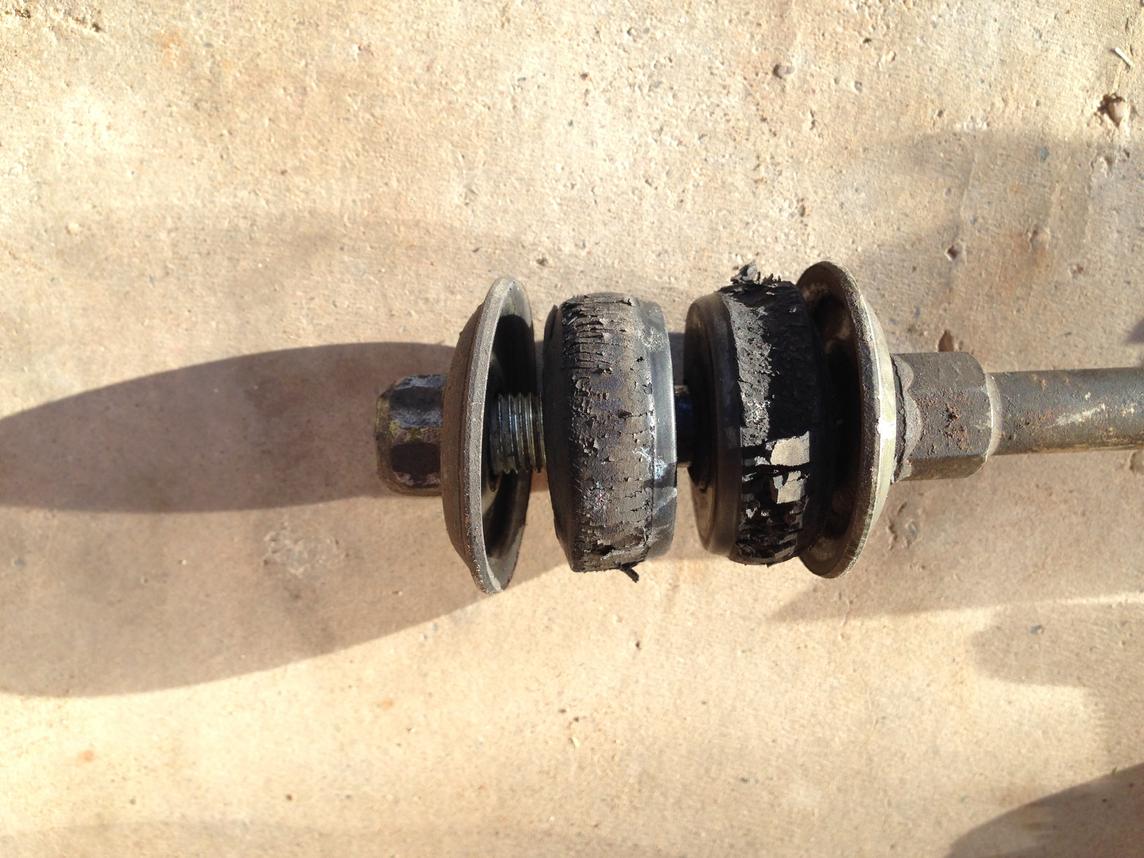

Worn sway bar end links

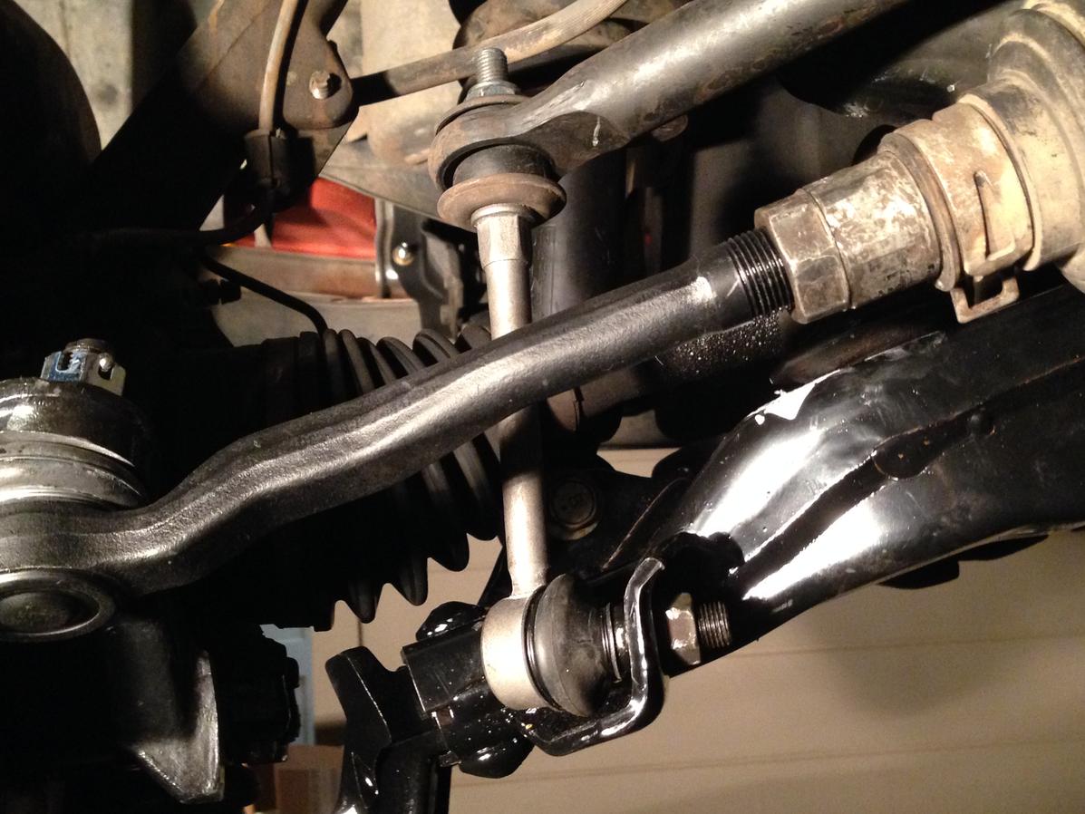

Here is a shot of my new front-end.
