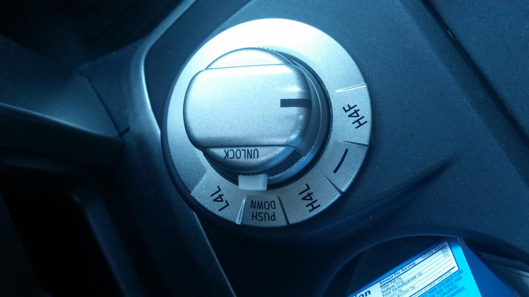

1 - it's a limited. It's either full time 4wd or AWD, don't know that there's much difference.

Here's a picture of the 4WD h/L control.

So, it's not as noticeable if you accelerate faster than normal? If you're at full lock, you may be feeling the torsen center differential engaging. This is also normal.
I'm going to try and go to the dealer on Friday. It's full time 4wd unless I am complely missing something.
