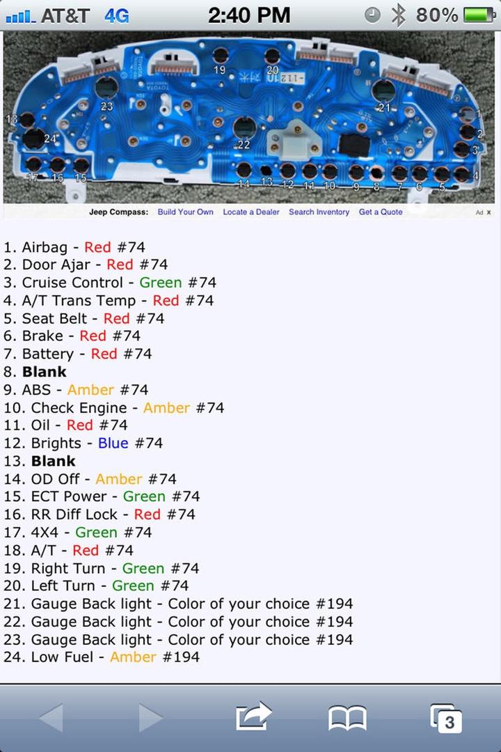

Here's a list of bulbs for the dash...I thought I had the center dash saved also...but can't seem to find it now. If I run across it...I'll post it for you. Good luck!
Picture courtesy of Cytronus...

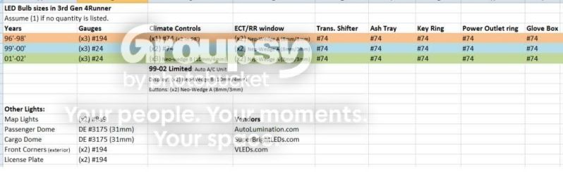

This should help you. It breaks down the bulbs by year. I really wish I would have had this when I was buying and returning bulbs for a week.
If I could just see this pic it would be one of the best LED bulb replacement thread compilations I've seen. :second:

here you go!
http://www.toyota-4runner.org/3rd-g...-climate-control-dash-bulbs-2000-limited.html
edit: it looks like the chart (host of the chart has exceeded his bandwidth for this month. keep checking back, when it does come back im going to save it in my own photo bucket library so its there and never goes away like it is now)
What year is that? They are different for the mid gen upgrades right?
Edit*** What tha hell? Pic wouldn't come in when I refreshed the page a few times but it's working now. :first:

I have a 2000 and it does NOT match mine...so if I'm not mistaken this is for 96-98. Sorry I don't know for sure.

If you look at CJ80's cheat sheet..it show how many of what lights it takes. And although mine is I believe for 96-98...it's basically the same, just in different places on the dash.
I'm sure you were hoping for more...sorry! But, I hope this helps a little. I'm going to do this one weekend this winter...I'm felling pretty confident these are correct.

Refer to the picture I posted and you'll be fine. You can even go to the link I posted for my build and get the links to the exact bulbs (at least for the #24 bulbs).
