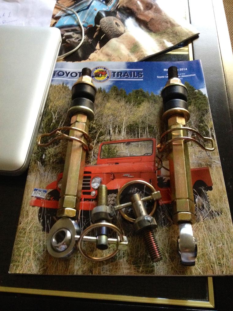

One last question for the day, does anyone make sway bar disconnects for this truck?
Physical disconnects? Yes, if my post-chemicalized brain remembers correctly, I saw a post a while back, I will edit when I find it.
I think [MENTION=76550]cbielat[/MENTION] has some.

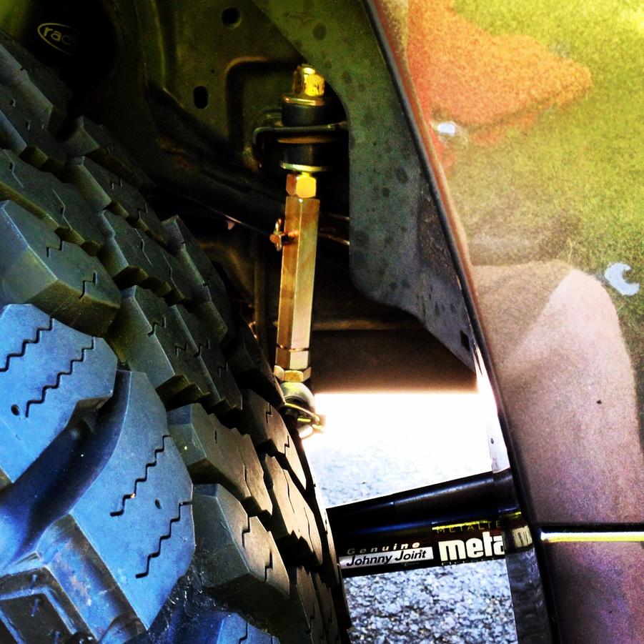

Mike [MENTION=98153]MStudt[/MENTION] makes them. Give him a holler. I have the double disconnects on mine
