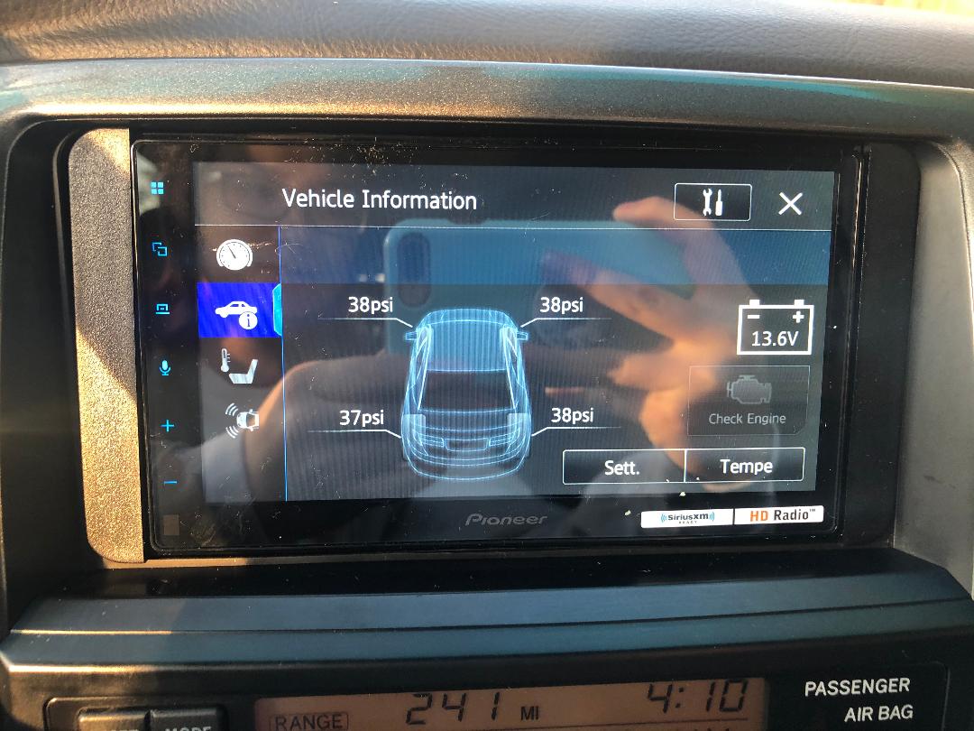

We just installed the DMH-2660NEX with the Metra 95-8202 Dash kit (non-JBL), iDatalink Maestro, with required harnesses, with their Crutchfield wiring service.
All the above was plug and play. (just watch a video). No issues whatsoever, no mods required.
I used a Camera Source rear camera for the OEM look. This install took a bit longer to install than the head unit.
I suggest running the wire starting from the hatch. Use silicone spray to snake thru the rubber hatch conduit. Use a heat gun to soften rubber sealer / trim pieces etc, for removal.

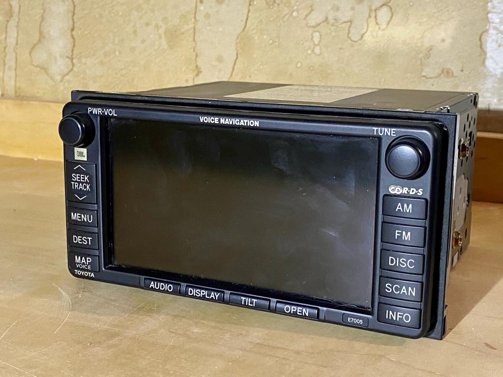

I can’t tell you what to go with but would help you offset costs by purchasing your old one. I have exact same year and trim. My disc drive seized in mine.
@%1;I have a JBL with Navigation unit from an 05 limited if you’re interested.
