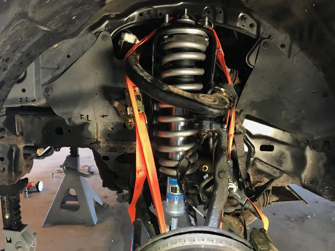

Hmm, i wouldnt think it would be mushy. tire psi? is your sway bar on? post of pic of shocks and springs installed.

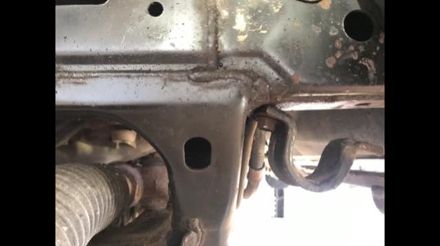

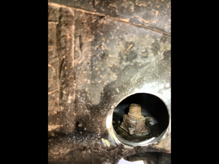

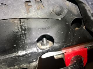

Tire pressure is about 35psi. I did have an issue on the front passenger side rear sway bar bolt. The threading or Welded nut inside frame broke so the bolt isn’t tight, or even close. Only the front bolt is. Would this cause a lot of sway? Maybe I’m confusing body roll with mushy? It acted and felt close to the same with the stock size tires and wheels as it did after new tires and wheels.
I do need to order a new set of sway bar bushings and get a plan to cut a square out of the side of frame, cut bolt and reweld a new one and weld plate back on to frame to get it tight. Maybe that’s the problem? The 2nd pic is of it back with the back bolt not Able to be tightened.
Here’s the only pic I have of the Coilover with the wheel off and we were putting it back together. Took a bit of “influencing” to be able to get it sandwiched back together lol.

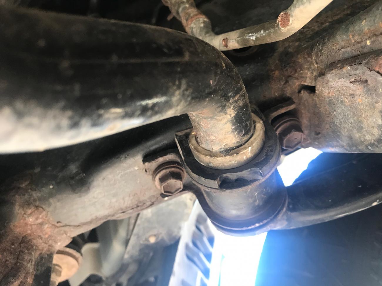

So I started with the rear and replaced the sway bar links with MOOG for a 2nd Gen (1” longer), they were definitely preloaded a decent amount and red energy Ploy rear sway bar bushings and sway bar link bushings. This alone seemed to help quite a bit reducing the sway and stabilising The whole truck a fair amount.
Next drilled out the frame in the front and was able to get a the open end of a wrench on the weld nut that was hidden inside frame. Replaced the weld nut with a regular nut and able to get the box end of a wrench on now. Replaced the front sway bar bushings with red energy Poly and a ToyTec sway bar relocation kit. This helped improve a bit more and reduced sway as well as seemed to tighten the steering response.
