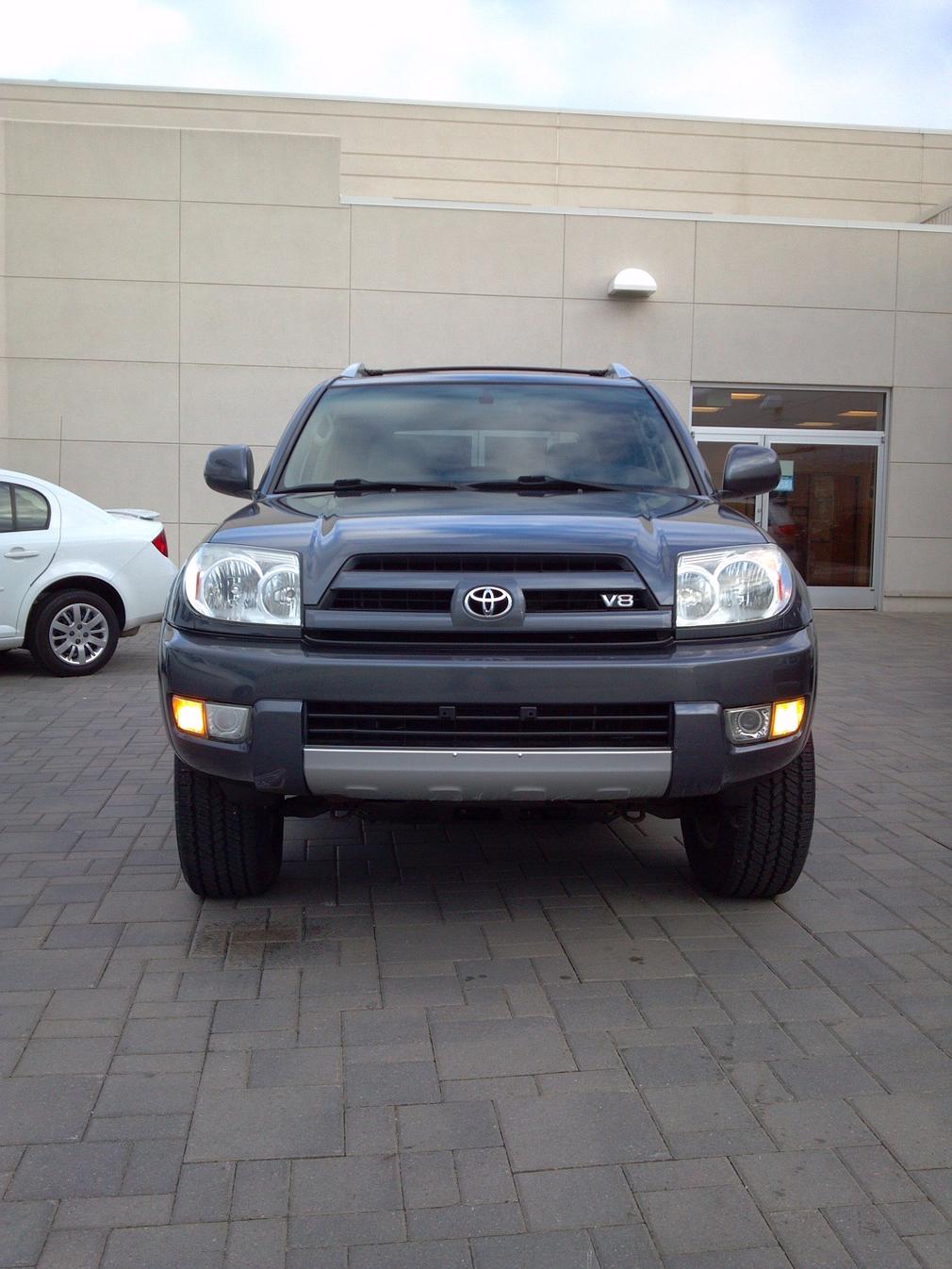

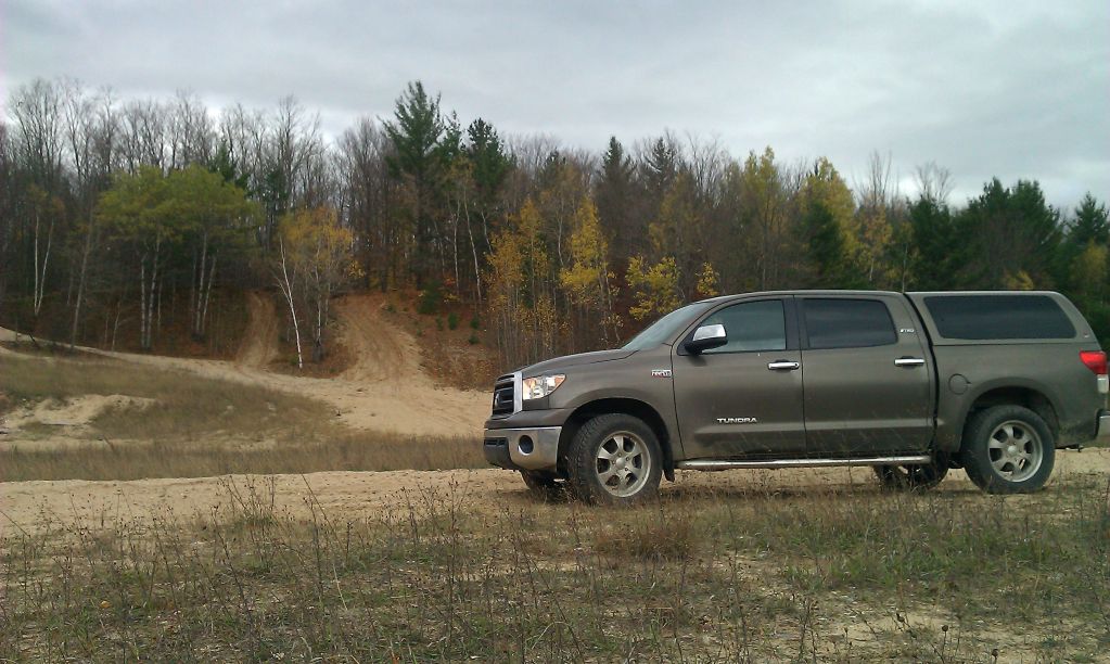

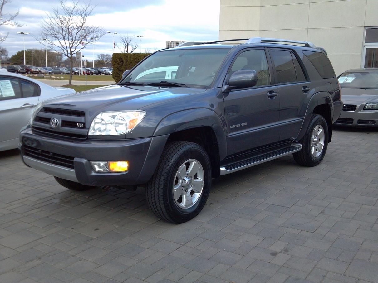

Oh, here's the new ride, and one of my old Tundra:
that's a nice 4runner, looks like the front has a lil bit of lift on it already, I'd watch for seized brake calipers, and rust around sunroof if you have it. that seems like pretty good avg gas mileage w/ the v8 and full time 4wd. hope you enjoy it.

It looks like my truck had a "front leveling kit" installed - there was a receipt in the glovebox for it. I took a look, and it looks like just a 1" shock/strut spacer in the front. Hopefully it doesn't cause any issues. Hmm.... I should probably check to see if they did put a diff-drop in along with the spacer :beatsme:
