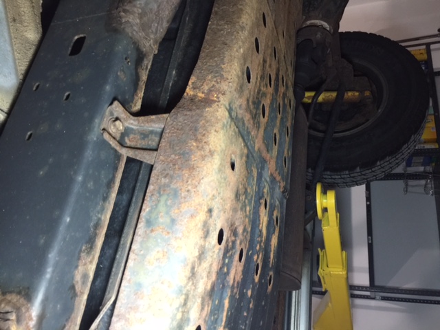

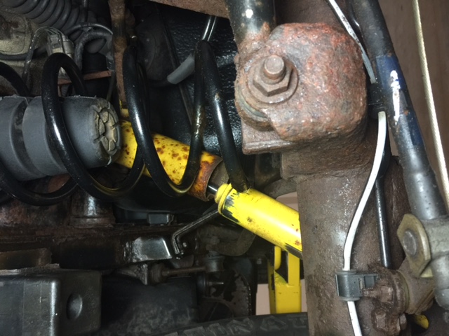

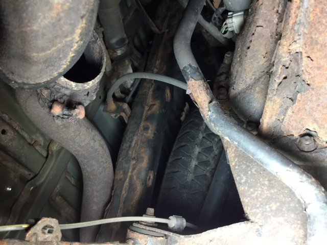

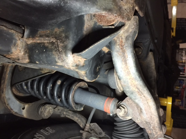

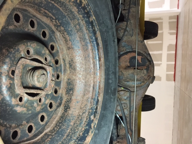

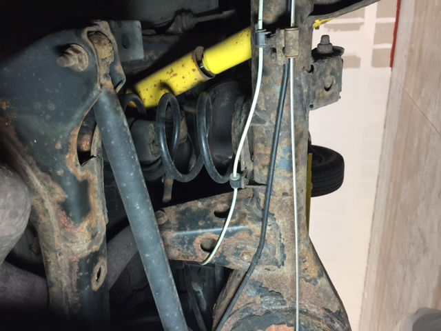

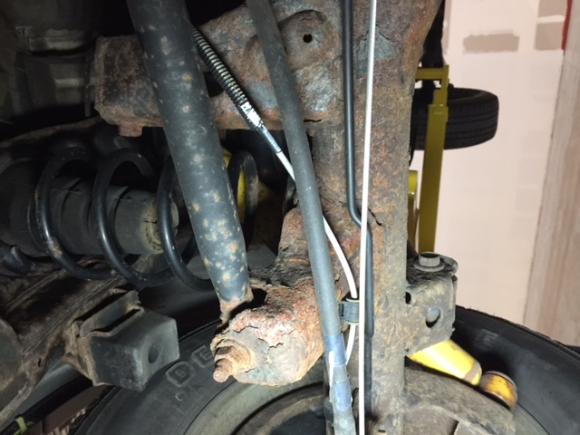

Hello,
I am new here, I just purchased a 2000 4Runner Limited from a dealer in PA with 130,000 miles about a week ago. I was hoping to get it, fix the exhaust they told me had a problem and have fun with it. But when I got it I realized I'd have to spend the money to fix it before I can buy any serious mods...
The dealer told me it only needs to have the exhaust repaired. When I got the car to Florida and put it on a lift, my jaw dropped. Rust EVERYWHERE and the exhaust system is so rusted I will need to buy both cats (CA emissions), muffler and new O2 sensors... Plus one of the rear shocks is completely broken.

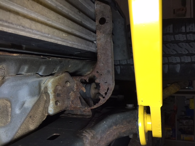

That's not the worst. After lifting it, I also found a 3inch rust hole on the side of the chassis. Besides that the axle, suspension brackets, brake covers, and a lot of other areas are rusted pretty bad (see pics).
After reading through the forum, I know people from the northeast have problems with rust in these models. But since there is so much rust, I'm thinking of buying a complete used frame from a junkyard and swapping the frame and other rusted parts. I never did a frame swap or anything even close, but I do have access to a car lift.
I also contacted a welder I know who does this work, he can cut, patch and weld it for $200. I'm not sure how much would a complete chassis be from a junkyard here, but I'm sure I'll find one with minimal rust here in Florida.
Any recommendations? All the money I planned to spend on tires, a lift and suspension will go to fix the rust :faint:
Thank you and happy thanksgiving

Did you buy it from a dealership (that sells new and used cars) or just a used car lot?
Used car lot.
I wasn't able to look at the car, and I signed sold "AS-IS". I purchased it because the body and interior looked (and are) clean, and also history showed only two owners and no accidents. Wasn't expecting this amount of rust though :(
The worst rust in those pictures above is just a running board bracket, and new running boards aren't hard to come by (or just remove outright.) Is that the worst spot?
I've heard frame replacements quoted in the low thousands (mainly due to the amount of labor involved), so if you've got a guy who can mend things for $200, that's the deal of the century.
Easier to replace the engine than the frame. Glad they don't use much salt around here.
Honestly that rust isn't so bad. I bought a 95 last year with less than 94K on it and the rust was twice that bad (Indiana - 2nd only to Ohio for rust damage!). You can probably improve a lot with replacing running board bracket and wire wheeling the rust. Frame swap sounds cool though.
It's not ideal but I've seen (and fixed) a lot worse. Do a search of some rotten frames on this forum then you won't feel so bad about yours...seriously! It's fixable, just trash the running board bracket and knock off the loose rust everywhere else and give it a coat of POR15, Fluid Film, or even black paint. Pay close attention to the mounting points of the rear control arms on the frame, that's a bad spot from my experience. Good luck!
x whatever the counts is on the rust. It isn't bad at all.
What's up with that muffler/tailpipe junction though? Did the tailpipe disconnect from the muffler output? If so, that needs to be corrected ASAP to prevent carbon monoxide from getting inside while driving.

Where's the picture of the 3 inch hole in the frame? I'll bet it's next to the muffler. Your situation sounds just like mine (even the same year and model) except my rear axle housing was leaking which I spotted the night I bought it. I've been battling the rust ever since. You can get it taken care of, it's just a lot of work.
I think following the replies, I will not do a frame swap. I think my best optiont is take the body off the frame and restore the entire frame (and do the hole welding in the frame while I restore and repaint it).

Doesn't look too bad.....Spend some time and do a few POR15 treatments and you should be golden....
Yep, need to see how to take the body off, and just restore, fix and paint the entire frame.
Thanks riddler, do you know any people in South Florida with experience in this? I researched the forum but I don't know if I can take the body off the frame by myself with no experience. I didn't see a DIY for taking a 4runner body off the frame (is there?).
Yep, the points you mentioned are rusted pretty bad. Seems most people vouch for POR15.
The muffler is completely rusted out and fell apart. Yeah the output is completely disconnected.
It's not being driven right now, I ordered a full Walker muffler (both cats, muffler and pipe I have apparently the CA version) plus the two oxygen sensors (one of them was over $100!). I'll install them after I deal with the frame rust I think.
You hit it bang on, the hole is exactly there but I can't take a good picture of it with the muffler still on.

The rust by the muffler can be fixed as long as it hasn't hit the control arm support too much. Even then it can be fixed, but may require a lot more work and maybe some fabrication.
