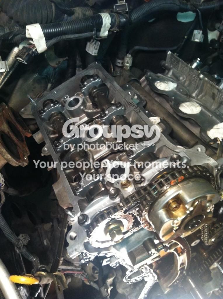

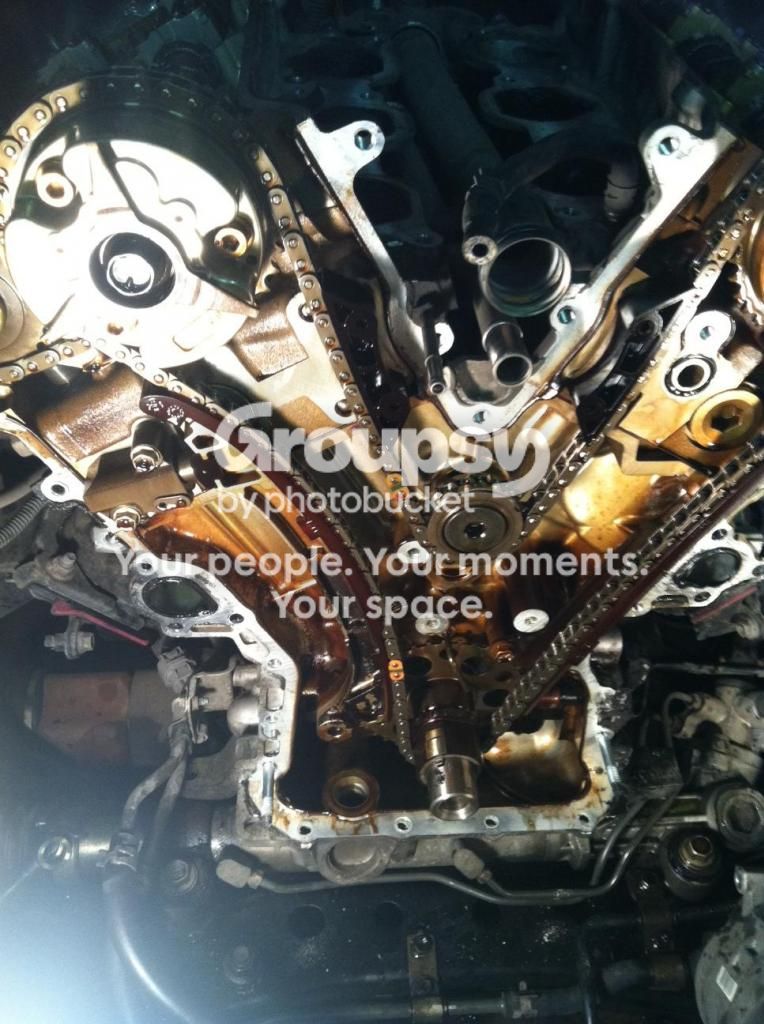

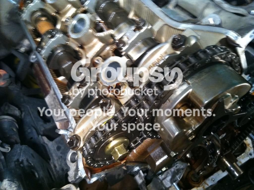

photo2.jpg~original
Above is a picture of the front cover removed prior to pulling the cams and timing chain.

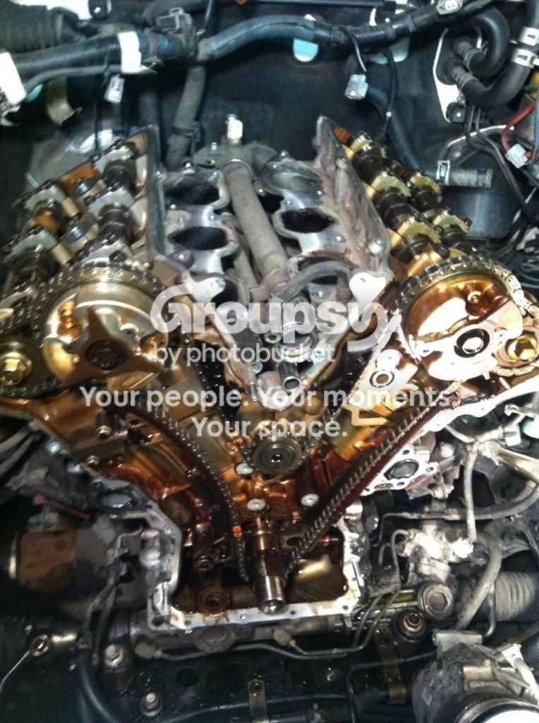

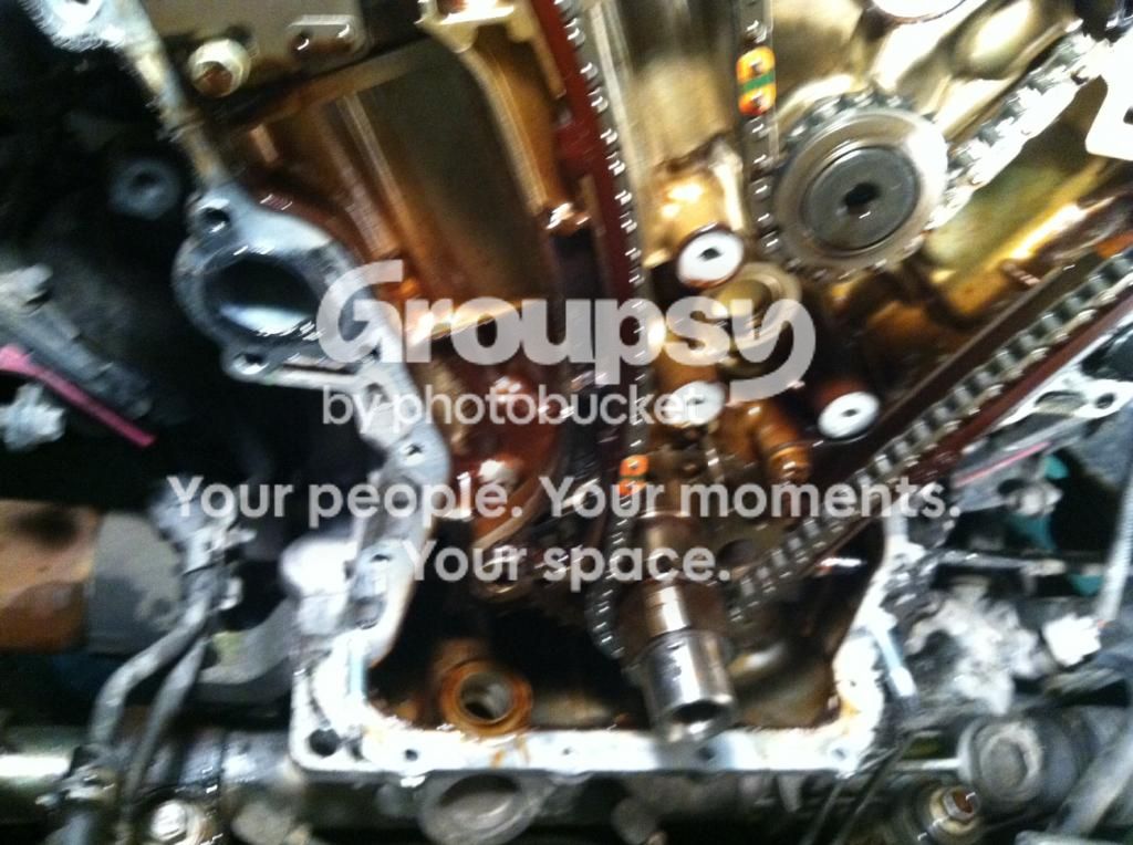

image2-9.jpeg~original
Another....

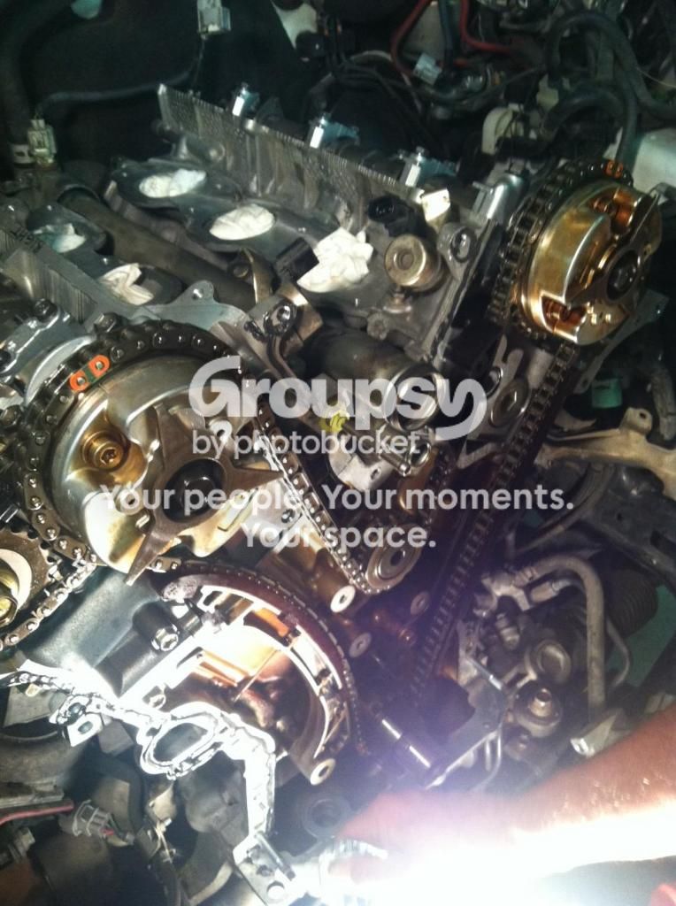

photo3.jpg~original
For reference of you forget what side VVt unit goes to which side.

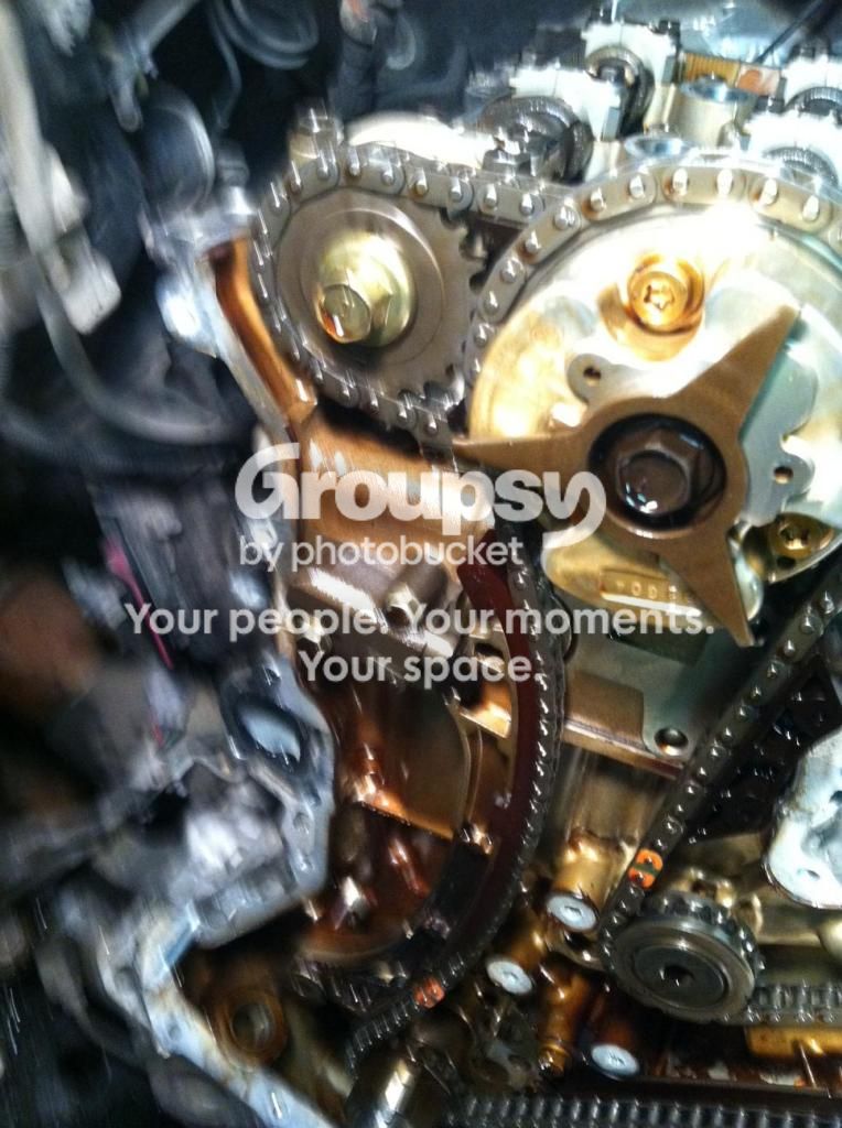

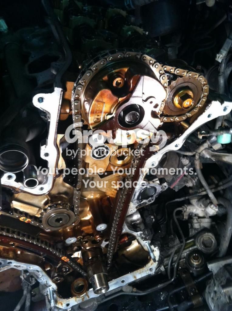

photo5.jpg~original
Pic of driver side timing marks at TDC, and cam lobe position before removal

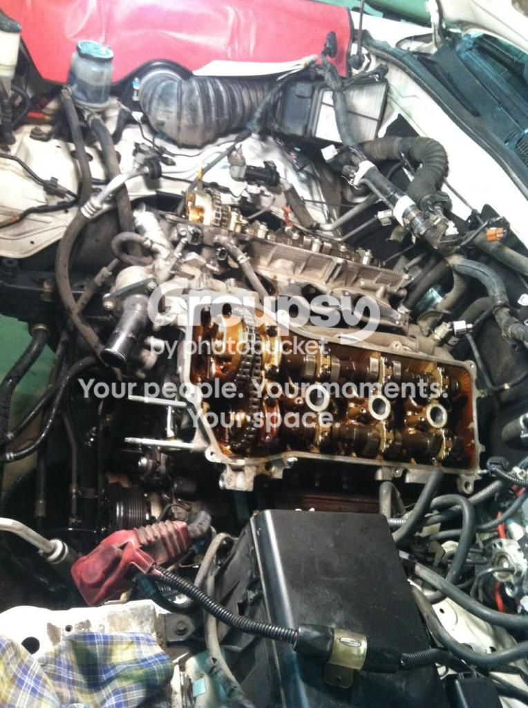

photo4.jpg~original
image3-7.jpeg~original
image4-3.jpeg~original
Pic of the driver side before removal. Timing marks and lobe position at TDC

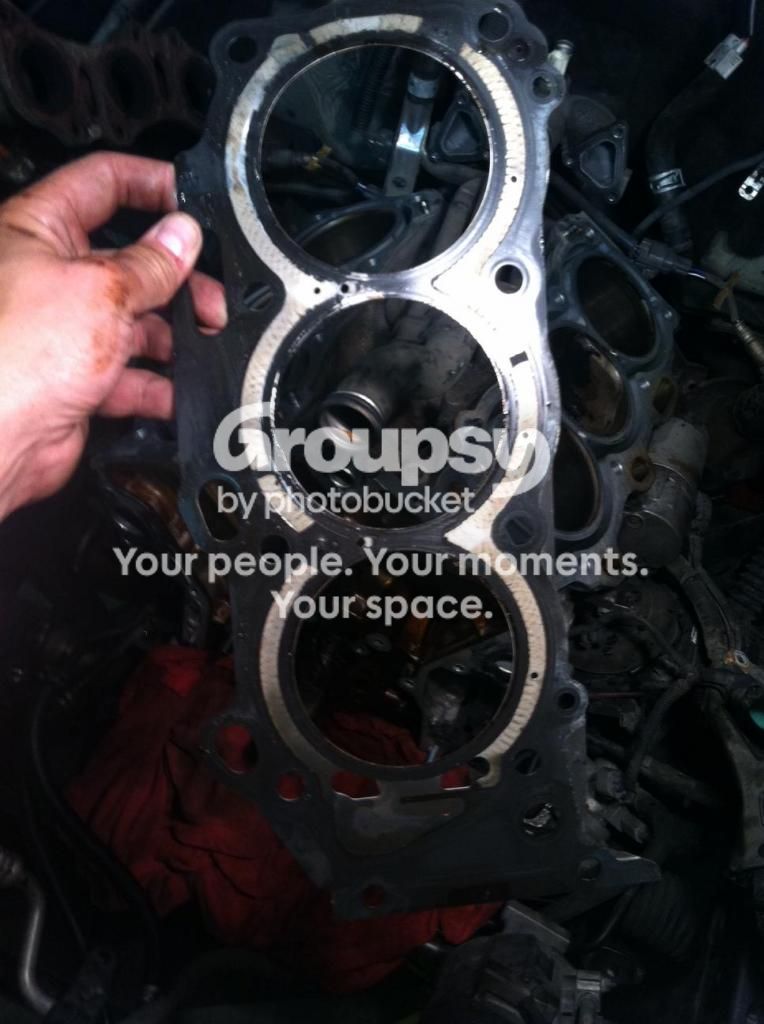

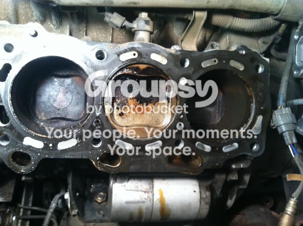

image7-1.jpeg~original
Yup that was the wet cylinder!
image8-1.jpeg~original
Tiny little leak caused all of this!

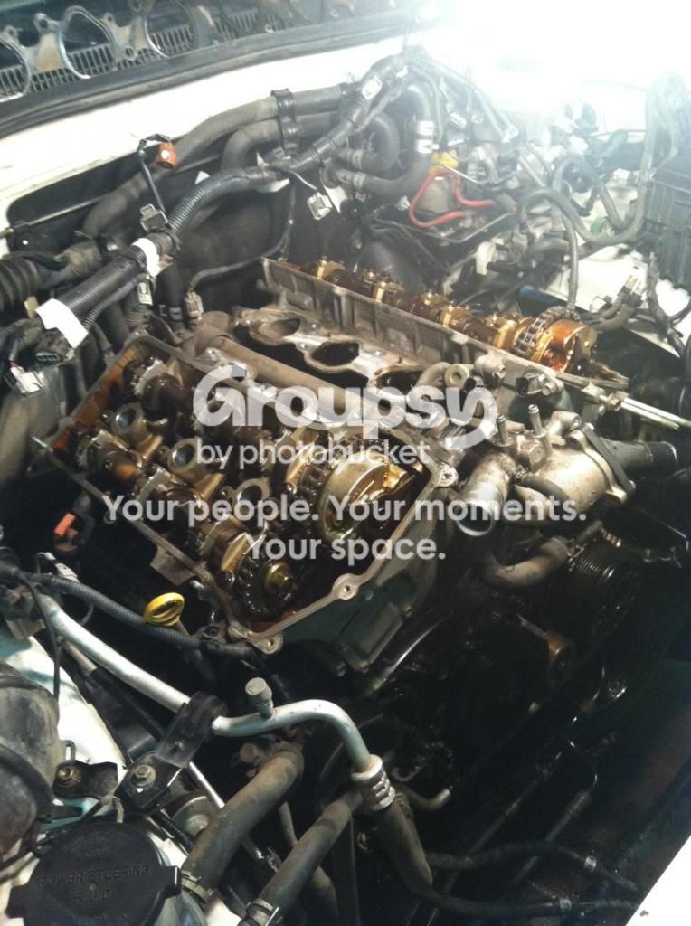

image11.jpeg~original

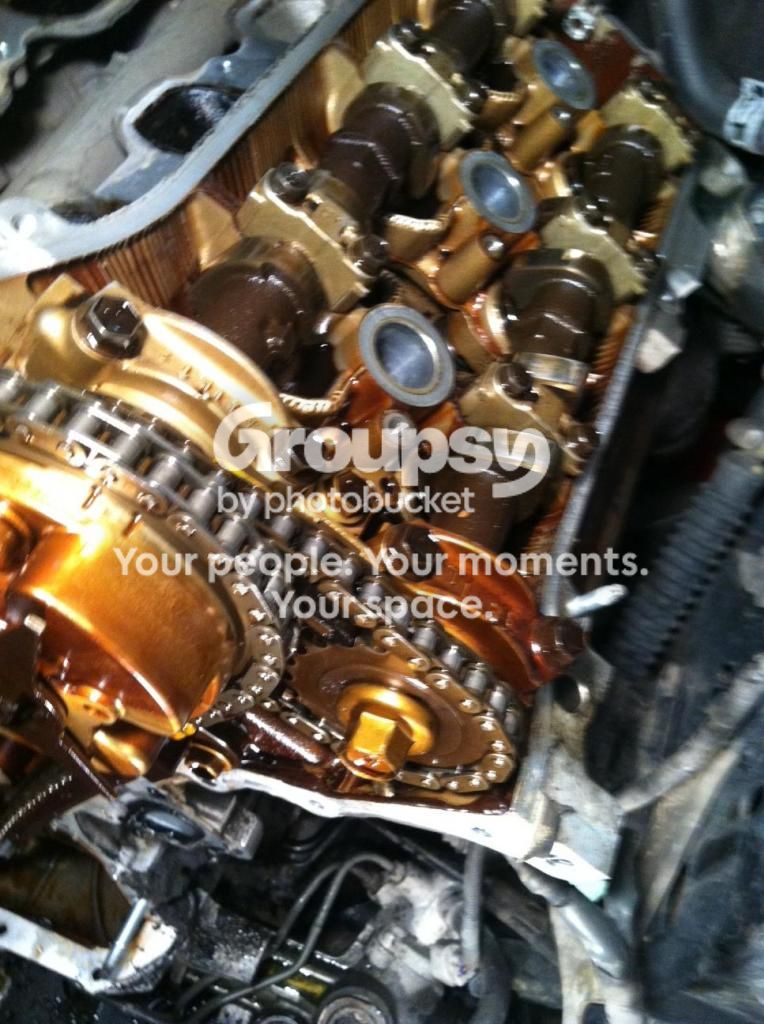

Pic of cam chain installed with all timing pmarks and links in the correct position.
image12.jpeg~original
Cam lobe position and timing marks upon re-install.

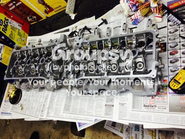

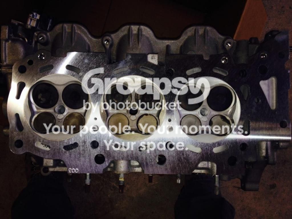

image10.jpeg~original
Cleaned up and ready to install..
image6-1.jpeg~original
Process of dropping the old caps back in.

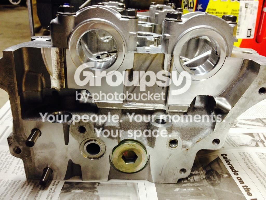

image9.jpeg~original
Removed 3 thousandths on both....

Great question on the VVTi phasers. Un be known to me, I did not touch them at all. Don’t believe it was in the service manual to do anything to them, and not sure how they would change, they were marked and went back on the exact same way, as they can only go on one way. I’d like to hear how they change… That being said they are required to be removed off the end of the cams if I am visualizing what you are talking about. Go ahead and add to the writeup about the chain and phasers as I won’t be and you sound like you have extended knowledge of them.
Regarding the oil pan, I guess I’m the guy who did the job the wrong way then. No I didn't pull the pan as I did not think it was necessary. Wasn't leaking then, and after 4800 miles it’s not leaking now, we will see if that holds true for the next 100k. If it leaks down the road. That is easy enough to do. This wasn't my vehicle and the funds were limited for my sister, as was my time. I would like to know why this is necessary, I’d find it hard to believe after seeing how the front cover comes off and seals?
Regarding the cost. Cam chain and associated tensioners were not included in the parts quote and labor quote we initially received, I figured if they didn't quote it for the job, why would I after being told by their tech it wasn’t necessary. Hope I wasn’t wrong, time will only tell.
I am not bashing toyota, as they have a great track record. My first post was venting with frustration over a really shitty response from a dealer in the springs. Maybe its Colorado's weather, but there were a few other 1grfes that lost head gaskets under 150k recently at a local trustworthy import shop that services my wifes subaru, and they stated they are starting to see more of them than they would like. Driver error??? I don't know, I am just stating what I have found out, and from some of the other threads it seems to be a common problem on the 04.
Best motor in a car we have ever owned was a Yota 3000cc-v6 in an 98 Lexus es 300, replaced the valve cover gaskets and a couple other small things and put 160k on that car after purchasing it with 175k, and only changed the oil. I was surprised it never let go, paid the same for the car about what the parts cost to do this job.
Yes, that explanation helps.
I meant the 2 long studs facing forward near the bottom of the front but there obviously isn't an issue because it worked for you.
Thanks.
Oh gotcha. I originally though you meant off the bottom of the block. Best of luck!
Good to know you do not need to take out the oil pan.
22hrs to do the job means that's the maximum hours they can bill the customer for the job. If the mechanic does the job in 15 hours than they still bill for 22 hrs as each mechanic is different. I highly doubt that the Toyota dealer will doing everything by the book to maximize and make sure they work on the vehicle for 22 hrs.
This is a business and fixing the problem area correctly but doing a short cut (but not harming anything) to get it done faster is the preferred method.
Example.
My friend had a 1993 Nisaan Altima. His knock sensor was throwing a code. He got quoted $650 to change this $50 sensor. I checked the repair books and sure enough it was 6 hrs or so to replace. Had to take out the intake manifold, etc to access..
What I did was, put the car up on a lift found the knock sensor. There was barely enough room to access it. There was a long metal coolant pipe running across and in front of the knock sensor blocking it. What I did was took a long pry bar, bent the coolant pipe 1/4" away from the knock sensor just enough so I can access it with a wrench. Changed the knock sensor in 15 minutes. Moving this coolant pipe had no negative effect on the car whatsoever.
Blackworks. You think the dealer will charge you 15 minutes or 6 hrs to change this sensor?? My money goes to 6 hours.. Again this is a business and if mechanics get it done sooner than its better for them. Maybe not them, but the owner of the shop.
Example.
I understand. Like I mentioned I'm well aware of how many hours can be logged by the book, and how many it takes. Been there and done that. I however only charge by the hour, not by the book.
This is why I had mentioned in my first post " tips and tricks" to the original teardown. There is typically a much quicker way than a stated book time.
I would also like to hear how to time the VVTi units... I find this pretty interesting, and indeed a sweet concept. I figured all timing had to be done through the ecu and Hall sensor readings, not a "hard" part adjustment?
