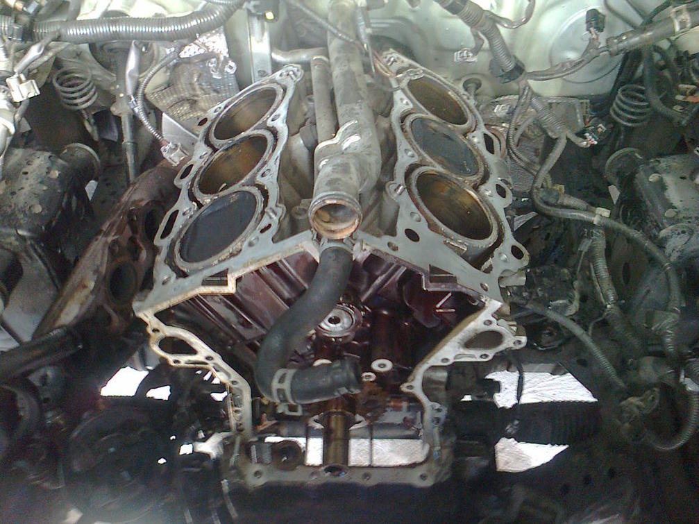

Photos
Thought I would post a few pics so you can see the 2 piece sump..bottom sump has been removed but upper sump on...Sorry pics a bit poor quality

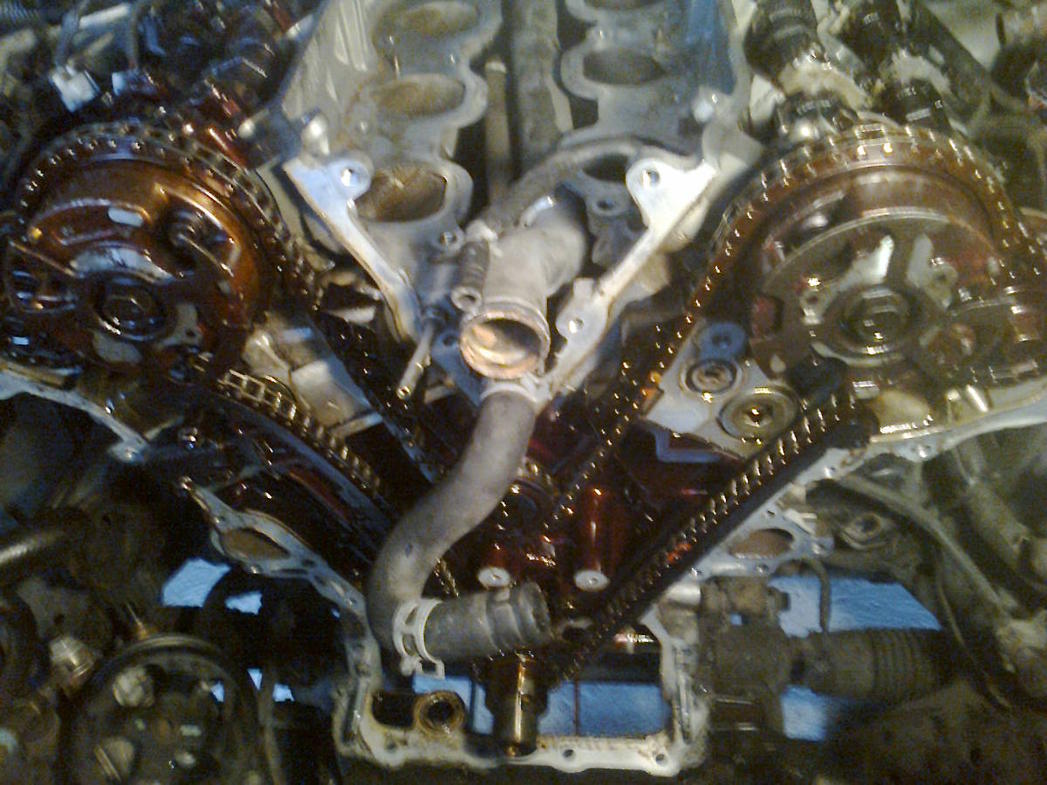

This thread is a work in progress while I have time to add onto it with pics and what not….
Well, I will try to start a write up on doing the heads for a 1GRFE motor. I will upload photos and progrees as it comes back to my memory. Car is up and running and out of my hands to a happy sibling. It is very straight forward and surprisingly quick job all thing considered. We were quoted over 4k for the job by Toyota in CO Springs, after they told us we needed a new motor. When I first dug into the car I simply wanted to be educated with what tricks may be needed down the line, and is why I joined this site. I received little to no help and just figured it’s like any other motor rebuild, and was much easier than expected. Dealer quoted 22hrs of labor, I did this not being familiar with Toyota motors in well under half the time. It would take an intoxicated blindfolded inbred 22hours to do the job, so don’t feel turned away by the labor. It is not rocket science and with the correct tools, focus, good service manual, and patience anyone could do this. I have only seen one other individual do this on the entire net and post about it. He was doing a full rebuild, and after 3 different motors had a running car. \
I did not write this during the process, but from memory of doing the job post completion. Your manual will cover anything I missed.
Yup that was the wet cylinder!
Tiny little leak caused all of this!
Cleaned up and ready to install..
