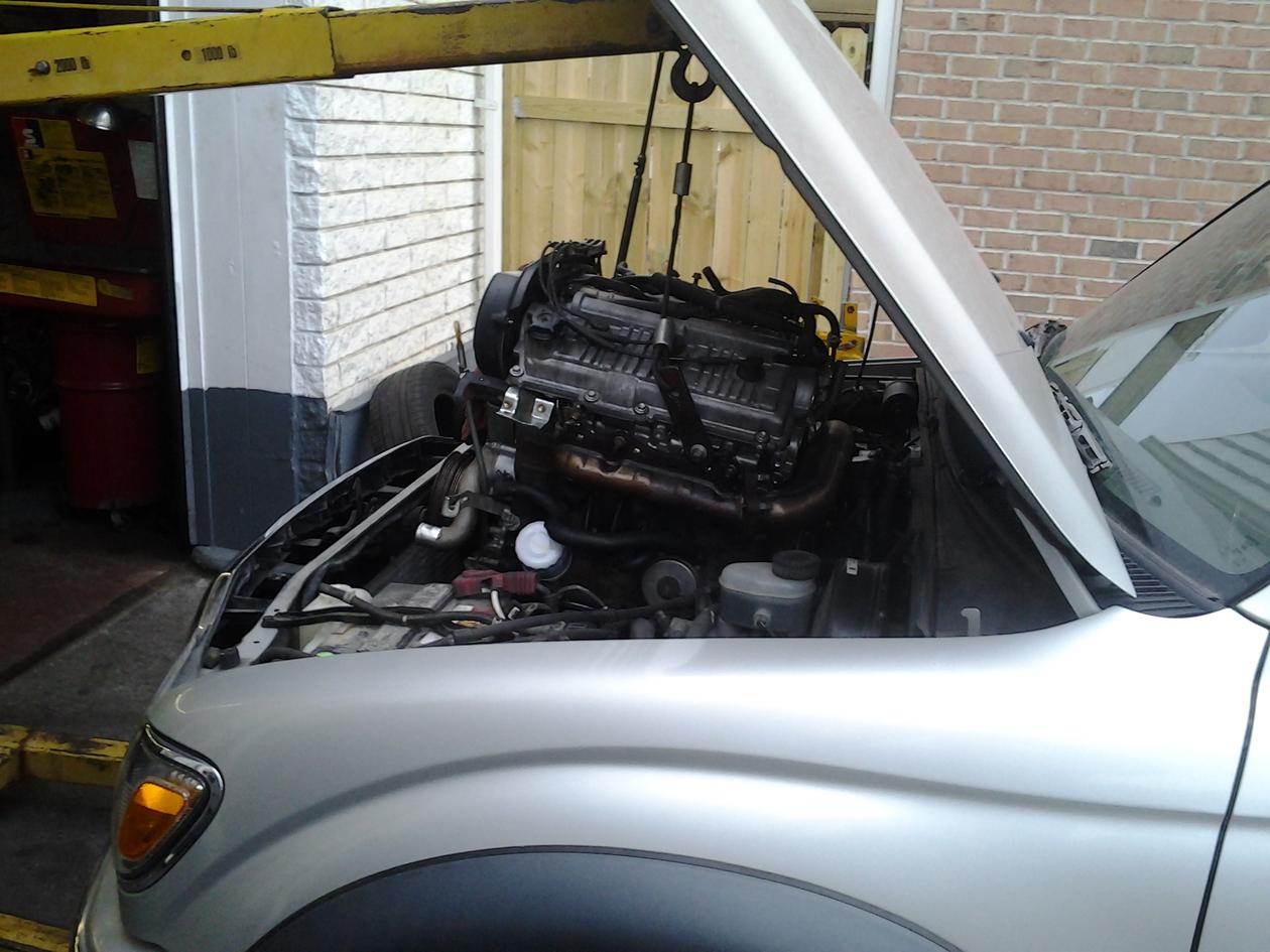

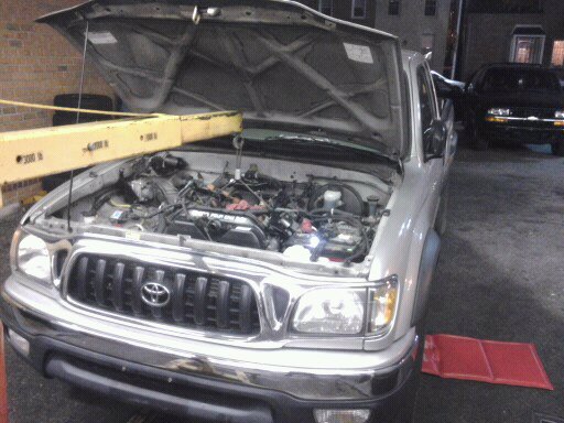

Why are you pulling the front clip off? When i did a 3.4L engine swap in my 04 tacoma 4x4 i didn't even remove the hood.
Just fyi in case you haven't yet seen some of the other threads where people did this. There are some good ones.
It's easier to remove the engine with the wiring still attached to it than remove every wire from every sensor, IMO. It also makes it easier to install, knowing that you aren't getting hung up on wires hanging in harms way.
If you have nevery performed these things before your plans sound optimistic. I would focus on the motor only instead of tearing into mutiple things at once. Good luck.
