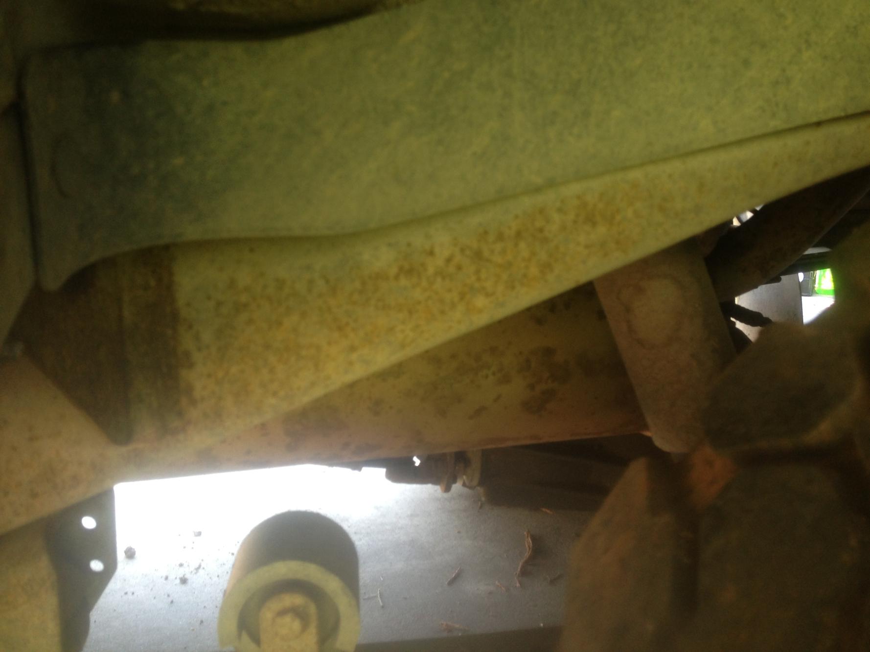

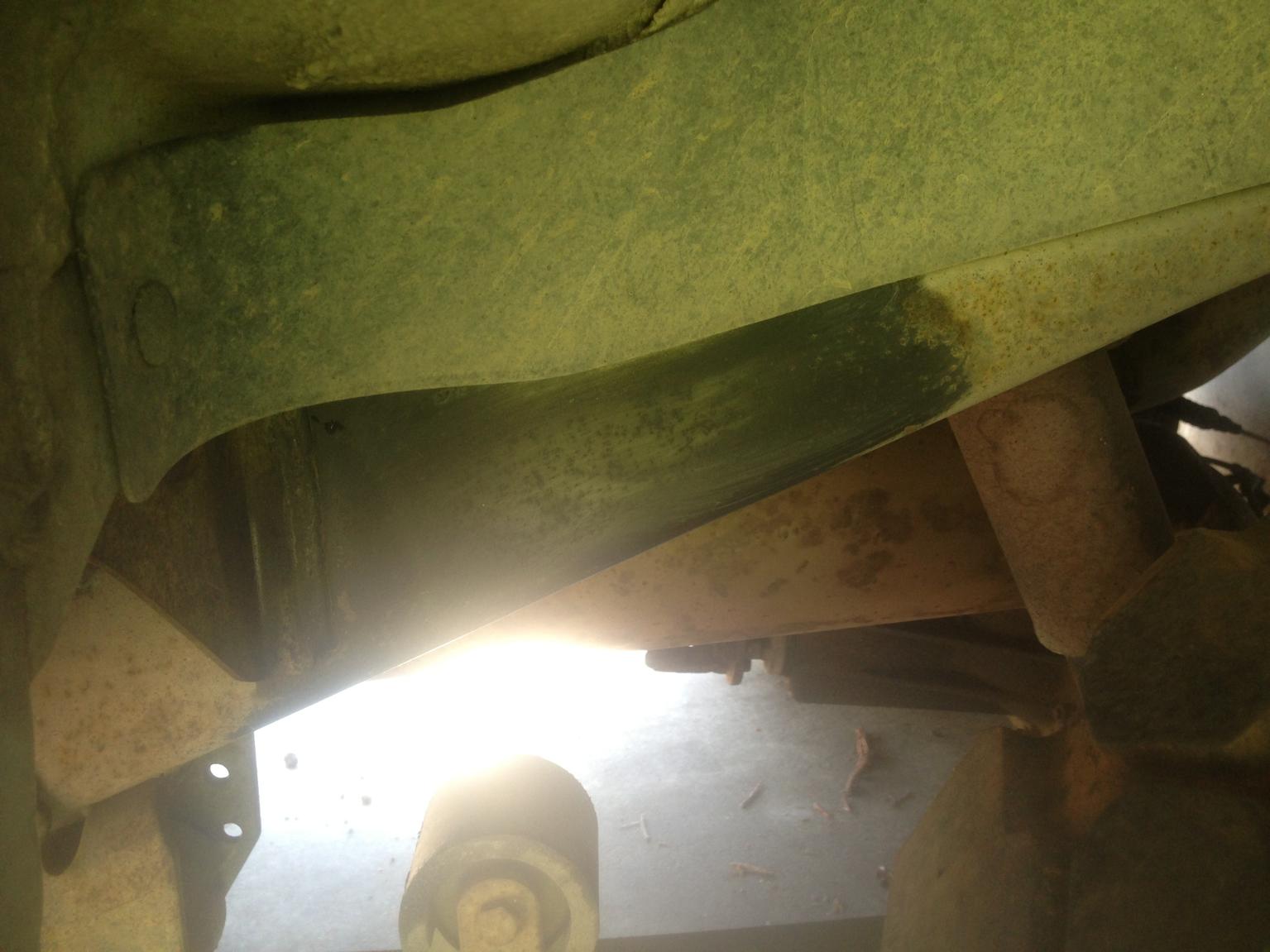

Another part of the frame...
....again, was very dirty / dusty. And you never really know what's underneath all that.

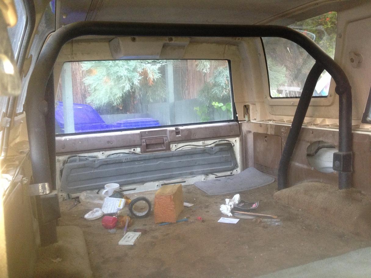

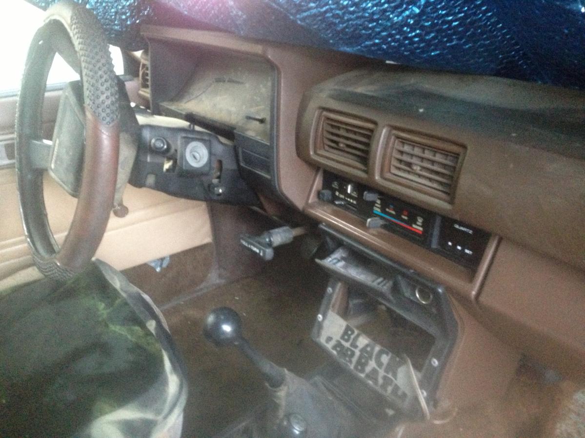

Interior. Tired. Just plain smelled of a fish market. The tailgate must have been stood on because it no longer sealed tight along the inner bottom (since scored a replacement). But surprisingly it had a factory tach and clock, and even the rear window worked!
