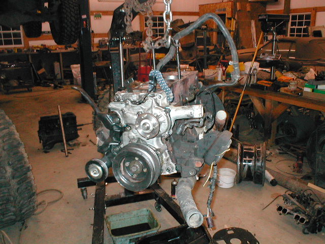

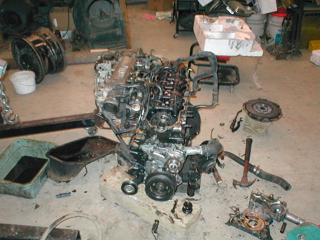

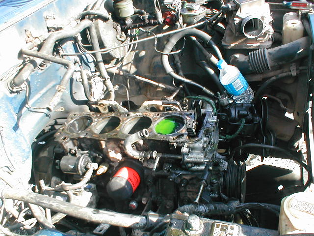

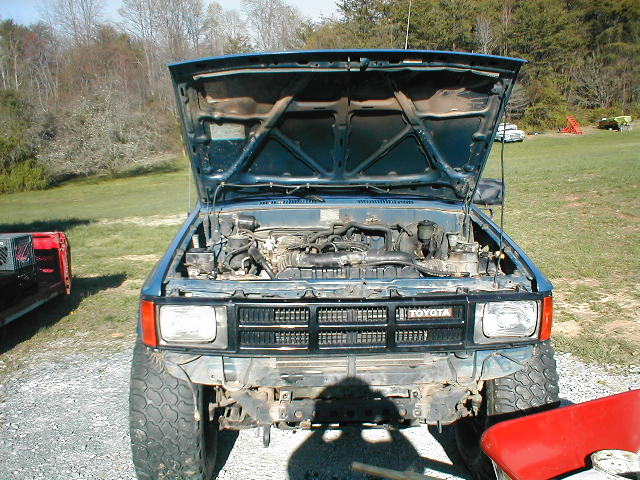

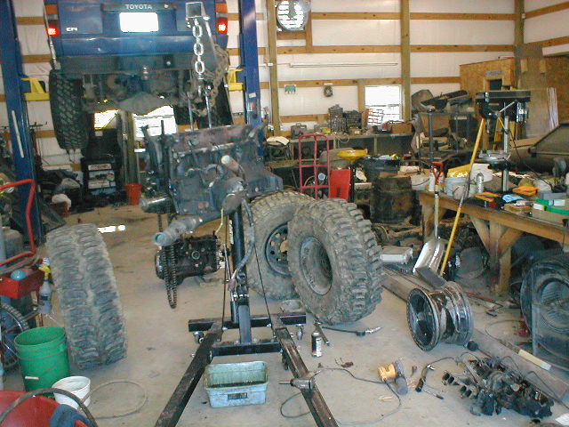

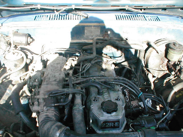

just finished rebuilding mine here are a few pics
total cost, 70$ for timing set, 90$ for complete engine gasket set, 55$ to have head shaved and 1 valve fixed, had to rebuy head gasket 18$, rebuy timing gaskets $9, rtv silicone $3, 20$ for more then enough parts cleaner, 12$ for 5 qts oil, $4 for oil filter, 9$ for coolant, $15 for fuel filter........305$ give or take $20 for something i may have missed..........Helped by having another 22re donated so i could use the lesser of 2 evils for the project....btw have many spare 22re parts for sale if anyone needs anything

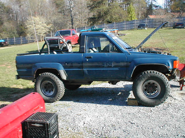

How did you get 35s under there? does it Rub? it doesnt looks like a lift... unless im really as dumb as I look. I have 31s on mine now... its stock
check the sig man......8in shackle extensions in the rear and cranked the torsion bars in the front, no rubbing at all.....btw i don't recommend the torsion bar crank, mines only temporary to make room for the 35's until axle swap in the next couple of weeks
