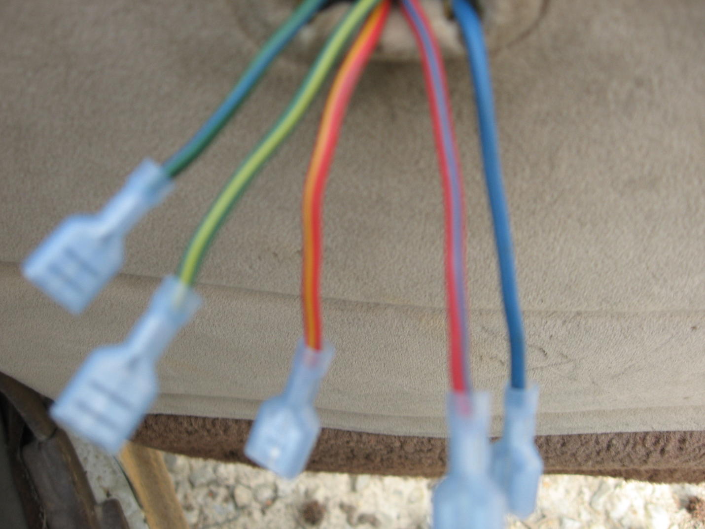

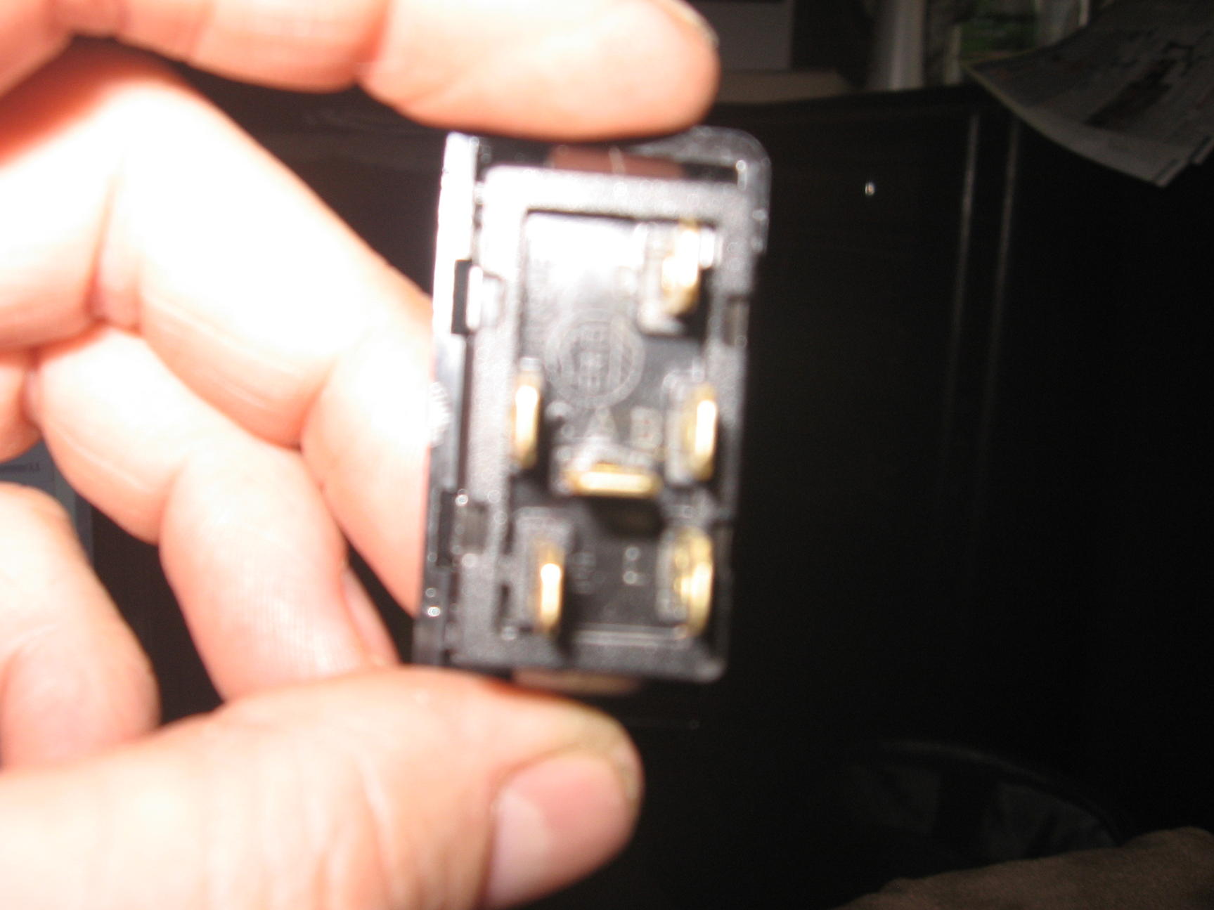

Sick of fighting the OLD Switches so I Bought new 5 Pole Switches .....now I need to know where to go with what wires & will Aftermarket Switches Work ?
Should the Switches have came with Instructions ???
Terminals on Switch are Labeled a b c d e ....& L ( Luminated Switches )
A is ctr , B is rt , C is on left ,D is top rt , E is bot left , L is bottom rt .
Thanks for any & all help !

Ok ...I have got the Pin Out for the Switch , it is a Reverse Polarity switch , that is what the 1985 tr4 are right ?
just need to know which 2 wires are - & which 2 are Motor .
Looking at the 95 FSM schematic, the switch terminals are numbered, not letters, and I don't see any of the color combinations I think I see in your pic. All should have a stripe and a main color of blue or red. It differs f/r and l/r.
The Switch is a Aftermarket Spal 5 Contact & I have the Pinout on it ....now . It shows 1 + , 2 - , 2 mtr .....I am looking for which wires are what on the door side , I know which one is 12vlt ...but not sure on the 2 - ... & 2 mtr.
Switch is for front Pas Door Window , 1985 SR5 4 Runner
Factory wires are Sld Green = Neg
Sld Blue =12 vlt
Green / Yellow =mtr
Red / Yellow =mtr
Red / Blue =Neg
I used a Spal # IB17400049 Window Switch $9.14 ea thru one of my Suppliers . Spal has the Pinout on their Website .
I will have to Fab a Lil Housing for the Switch but ...it WORKS ...now to move on & Replace my Back Window Switch Too !
Thanks for All the help !
