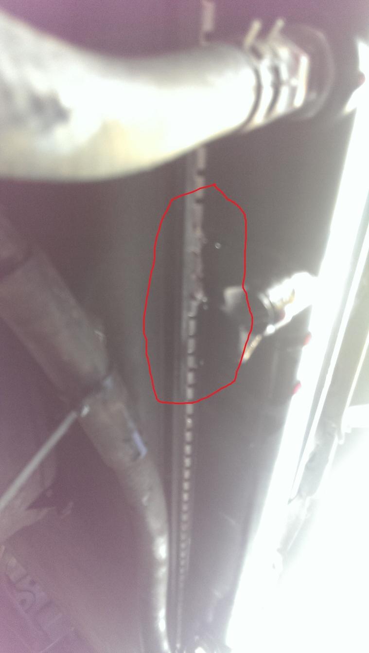

I recently had a new radiator installed after dealing with the strawberry milkshake. I was on the road so I took it to a dealership to fix. About 2500-3000 miles later my temp was climbing and after I pulled over I noticed coolant everywhere near the front passenger side. I took out some tools and tried to find the source.
After taking off the front skip plate I noticed it seemed to be leaking out of the drain plug. I unscrewed the plug (about a pint of coolant came out) and applied some teflon tape. I checked it after I started it up and noticed it was actually leaking from just above the drain plug. Specifically, the spot where the plastic bottom reservoir and the aluminum meet. I stuffed that area with teflon tape using my finger and it seemed to slow it down enough to drive the two hours home. I had lost 4+ gallons of coolant over who knows how long. See the picture below.
Is this because a faulty radiator? Because I had it fixed 2000 miles away at a dealer what are my options?

This was at a dealer I called them, they said bring it to a local shop here in DC and it'll be replaced if it's the part they installed that's failing. The shop in DC said it's aftermarket so they can't replace it for free. I didn't even call the dealership I brought it to in SLC back, I called Toyota corporate and said they feel it's important for a dealership to tell you it's not a Toyota part, their is no requirement for them to do so. They will have the dealer in SLC customer service rep call me to resolve the issue.
Anyways the SLC dealer called and they are just going to refund me the money for the radiator and labor. Apparently they bought the radiator from 1-800-Radiators and initially told me to contact them for a new one. I told them that's BS, and I expected a better resolution than calling around to have it replaced.
