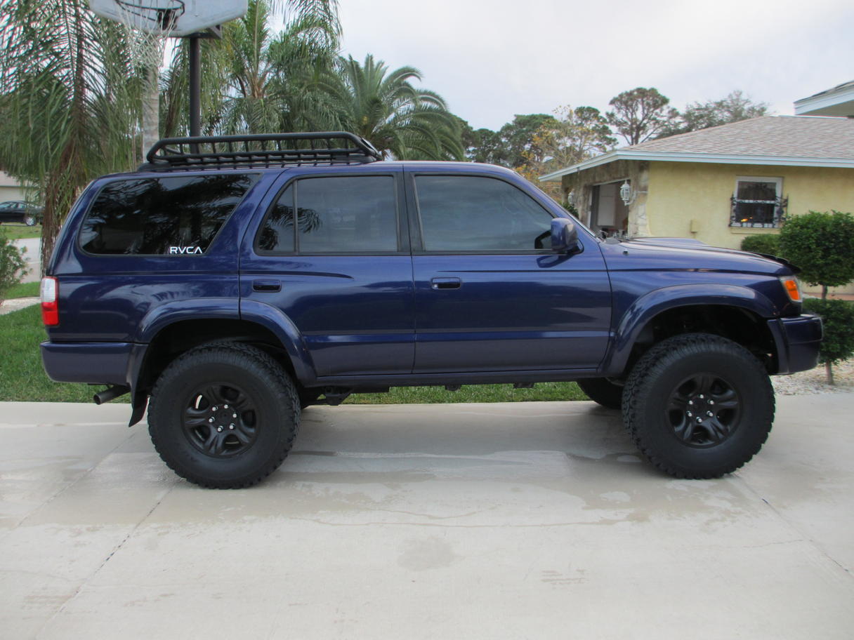

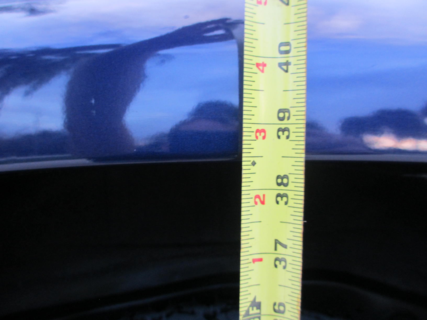

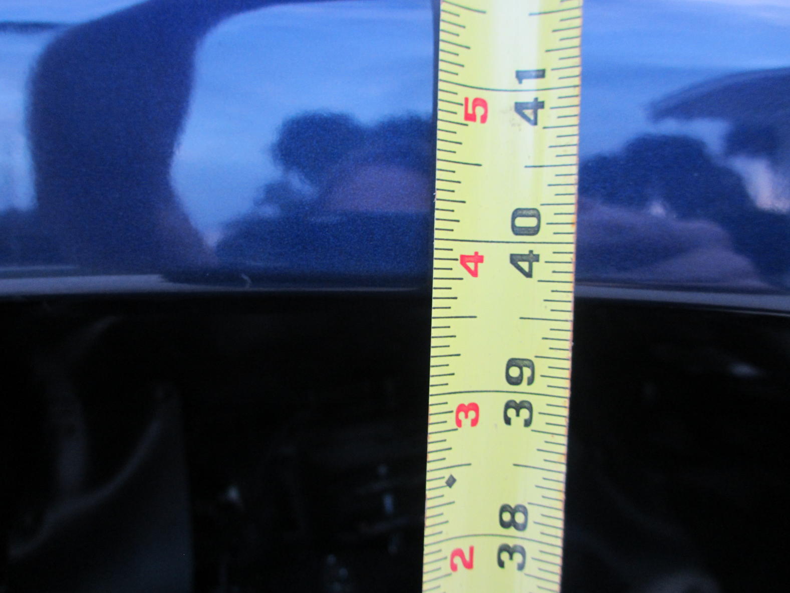

well i put the 5100s on and gained a bunch of lift, like some guys were telling me. I had the toytec 3" lift with stock struts. This is a not something you want to do, it was pinning the front end down. I was at 36 1/2 " all four corners. Im at 39 1/2" in the front and 38 1/2" in the rear, with the new 285/75/16 bfg i added today also. The rear was 36 1/2" because i had spring compressors on the rear to level it out, when the front didn't get the lift because of the stock struts. Its a little high in the front know, but I'm thinking it will settle, and getting it a alignment tommorow. Thanks to all for the info on the struts, i finally got the lift i wanted.
I have no rubbing and I'm using 1/4" spacers in the front
