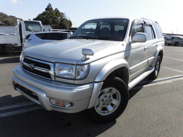

Here is a pic after being unloaded from the auction.

wth is that on the hood?
Parking mirror, common on RHD vehicles from Japan.
