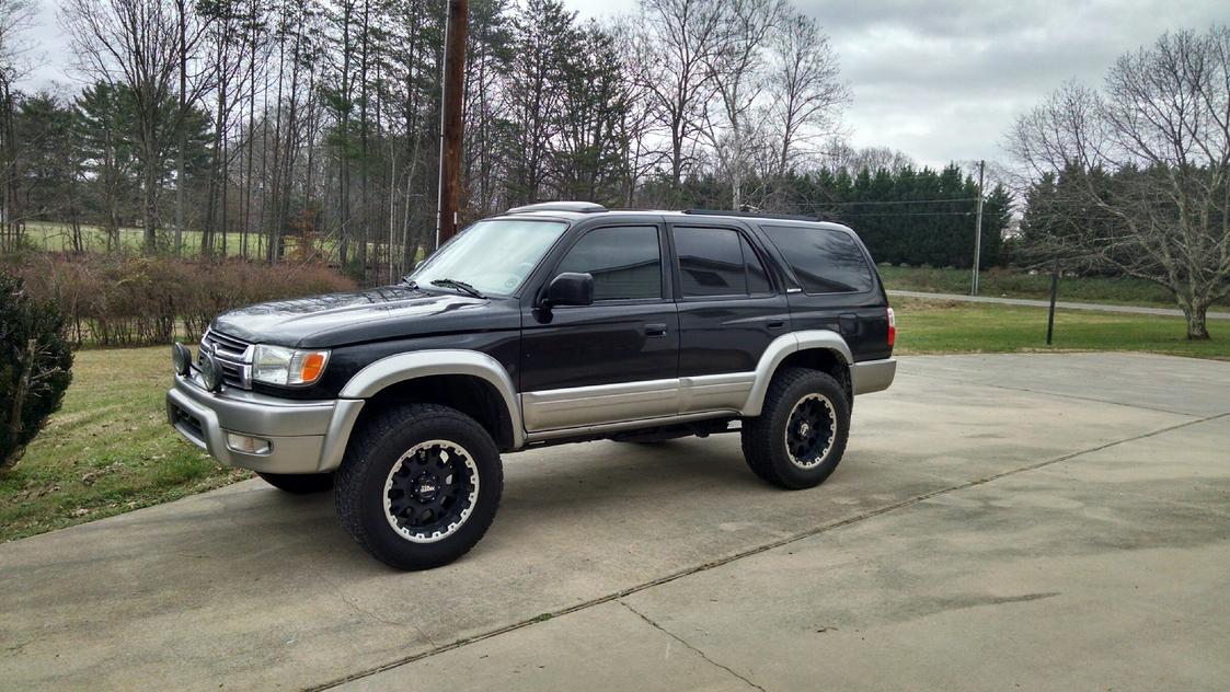

I haven't purchased it yet, I'm going to check it out but here is the potential rig. It looks like there is a slight lift already but I don't know what it is. Any advice on things to looks for?

If you're curious about the lift, you can measure from the center of the wheels to the bottom of the fender and see where you're at. To me that looks like it has at least a couple of inches of lift already.

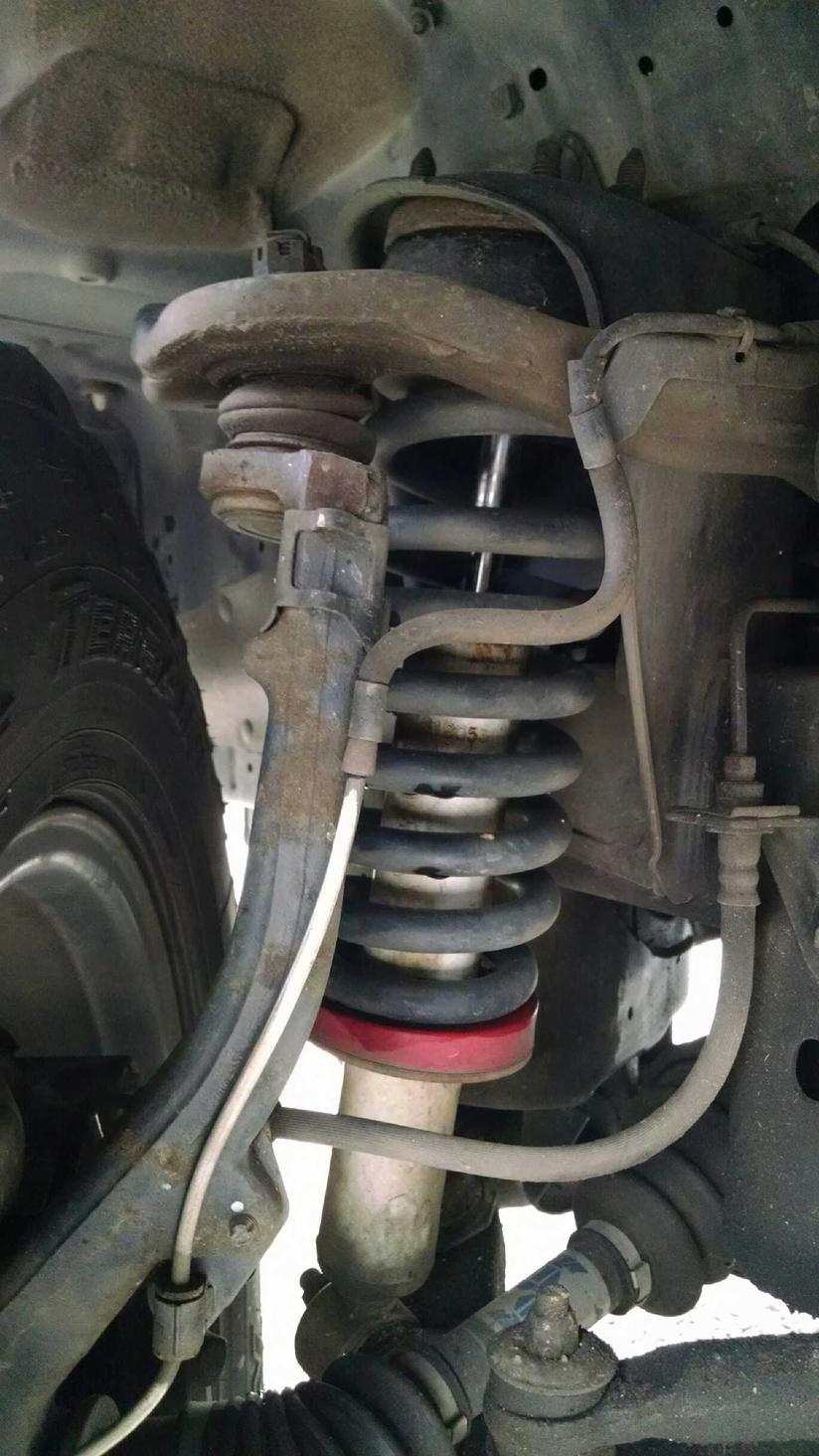

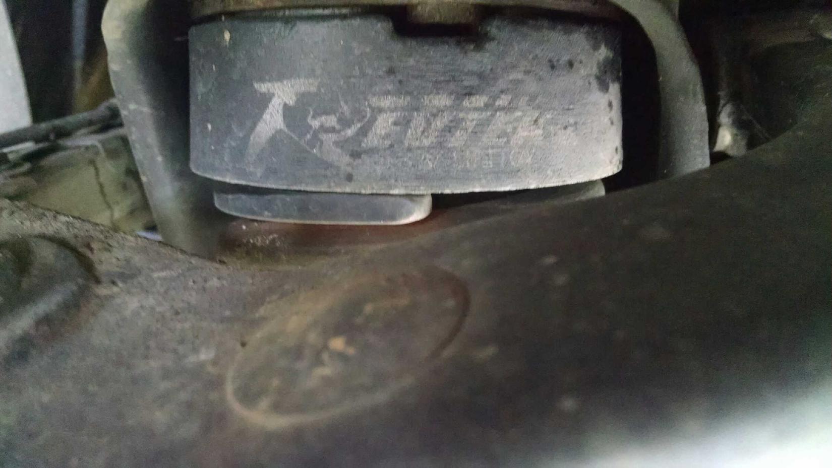

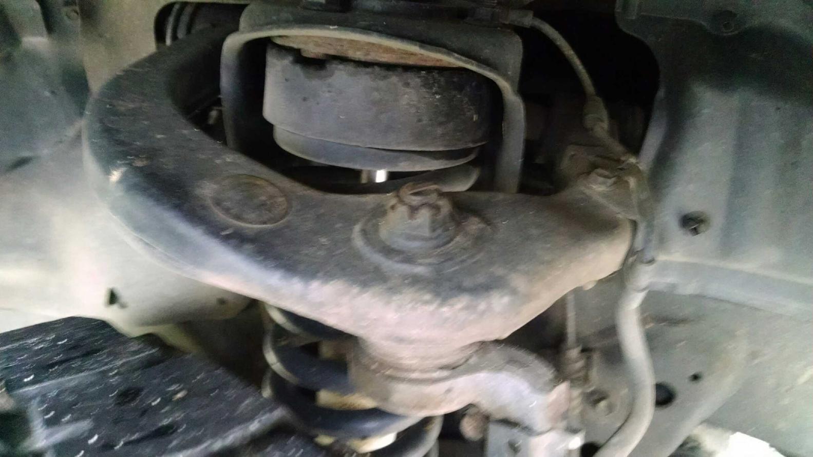

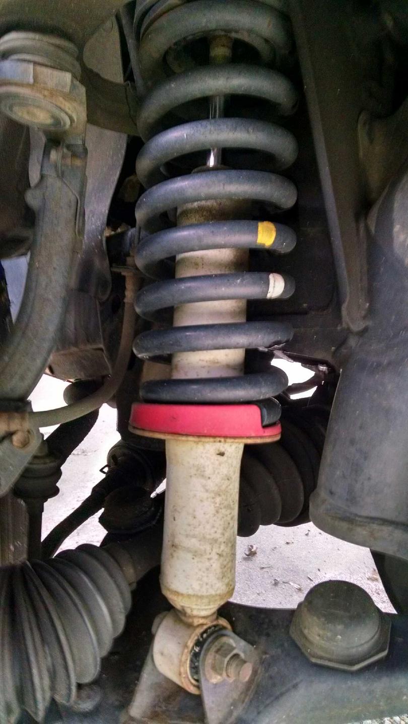

Can anyone speak to his at all as far as quality goes? I've never heard of it before.

Looks like a cheap spacer lift, not the best solution. I wouldn't run one. A real lift with new coils and shocks is the way to go.
You've already got some sort of replacement CV axles in there as those aren't OEM.
She looks like a clean platform to start with though. I hope those wheels are the first thing to go though. Not my style at all. :thumb3:
Yeah the wheels are pretty ugly. I think he got them for his kid who was in high school and lifted truck with big rims were cool.
