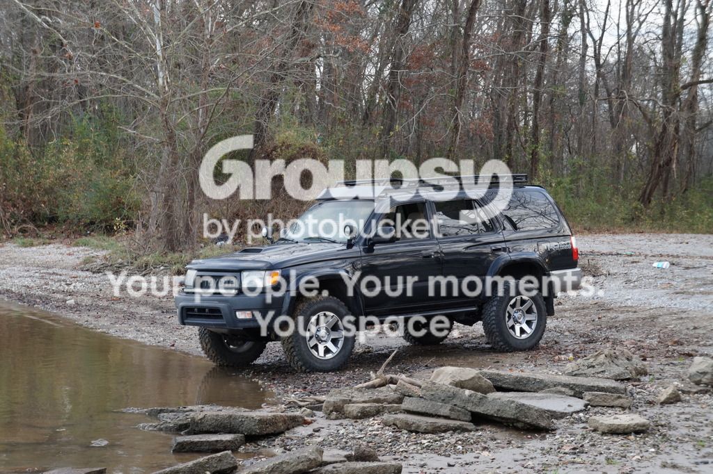

Here's how she sits right now. The LC coils are known for being really flexy also.
That looks like a solid height what size tires are you running?
The only thing I'm worried about is how much it is going to sag with a tire carrier and camping gear on the back
Tires are 255/75/17's.
I think with just gear loaded in the back it wouldn't sag too bad, maybe level at worst. I've got close to 2 inches of rake right now. With a tire carrier lots of guys run OME 861's which are the OME coils for the LC's. They support the weight of a tire carrier better. That's what I'll probably switch to when I get a tire carrier eventually.

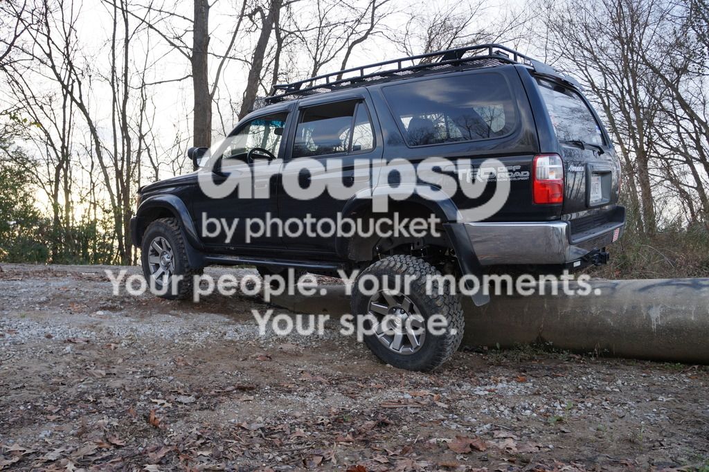

The wheels are the trail edition wheels that you can get on the post facelift 5th gen 4Runners.
