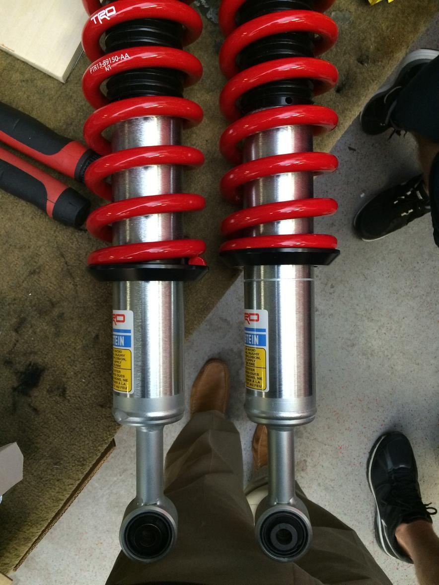

PS: I do not believe the TRD Bilstein shocks that are installed on the TRD Pro have the adjustment setup that the standard 5100's have. I believe they are already designed to accept more lift and wheel travel and the remote reservoirs allow them to be worked harder, but I don't think they are designed for varied height adjustment ala the 4 notch setup of our current 5100's. Of course I could be wrong.

Wow, tough crowd. I'm not trying to start a flame war, but until one of the new owners actually crawls under their TRD Pro to look at the shocks we really don't know do we? I didn't see any confirmation in this thread.
This is all I could glean from any of the press releases or searching for those shocks. It has NO reference to height adjustability. Looking at the picture in Cplturner's sig and looking at my 1.75" adjustment I would say the 1.5" referenced is pretty accurate. And I can use the bold button too! :fencing:

The TRDPRO suspension is not adjustable according to [MENTION=111615]JM4Runner[/MENTION] who actually works on them......post 1530.... http://www.toyota-4runner.org/5th-gen-t4rs/160015-4runner-trd-pro-51.html#post1816884

Huh, that seems to directly contradict all the photos that have been posted so far, unless there isn't a third notch, but they are definitely adjustable http://www.toyota-4runner.org/5th-gen-t4rs/160015-4runner-trd-pro-34.html#post1808060
I'm just going by what the guy that works for Toyota,is a mechanic and has seen them first hand has written......
Maybe he is wrong but he seems ligit and he wrote after being asked
" The suspension that comes for the TRDP is NOT adjustable. It does appear that way because the driver and passenger side are set on two different notches, but they do not adjust higher. For those seeking adjustability in a factory TRD suspension, The Tacoma Baja suspension is the factory suspension that has this. It has 3 settings which should allow for you to adjust. Rumored to have been similar to what was used for the preproduction TRDP, but post production received non adjustable medium setting. IDK where you can get a similar factoryish suspension for the 4R other than the FJ Trail Team Last Edition, which is also not adjustable.'

Yea, its all conjecture, youre right. The preproduction models had 3 notches so I assumed they were the same and set in the middle. Surprised they would change that though

I might actually be wrong. The info provided above seems to imply that they maybe don't have the 3rd notch that the preproduction models actually have.
I may have to eat my words on it, but I was in fact originally told that they are not adjustable. However, the digging and indecision started making me probe a bit more. I don't typically like to look over the shoulders of people at work, but I did in this case. The picture shows the front Driver(right) and Passenger(left) suspension. Indeed they do seem adjustable. [MENTION=103267]Saker[/MENTION] and I shared a few PM's about it, and how the factory preset it for driver side lean maybe. Unfortunately until now I wasn't able to get a first hand look at the suspension alone. Before my information came from one of the supervisors, that it was not adjustable, because it is simply delivered put together. I thought someone here had plans to take it to a shop and make the adjustments.... Based on what I see, I would imagine each side could go up one more notch. Unfortunately we can't take it apart here to find out for sure.:shrug:
