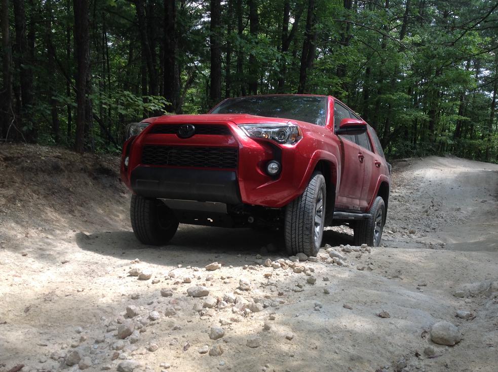

Yes passable without sliders. I read a bunch of trail reports before I went, all seemed to make it out to be quite easy. Its more than a gravel road that is for sure... I kept it in 4 low to keep things kosher. I could have done it blindfolded in my FJ80 but since I was in my 40k truck with 3000 miles I was much more cautious. There were plenty of times where I felt more comfortable with my friend driving and me spotting her. The elevation makes it fun and coming down is always a clincher.
I did not make it to the top, the last climb was a red clay hill so I did not trust my stock H/Ts from keeping me straight and not to slam the sides of the truck. There is another way too the top but we were maxed out for the day so did not look for it.
Pin stripping was minimal, everything waxed out. The bumps on the skids could have been avoided with better lines. We were out there for a solid 3-4 hours so make a day out of it.
I saw 2 new Jeeps and about 50 atvs and bikes so there is some traffic out there. Everyone was friendly. I did get a little worried when bikes flew by kicking up rocks. Facilities are decent. A handful of good looking campsites and the vaulted shitters were clean and stocked with TP.

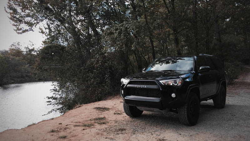

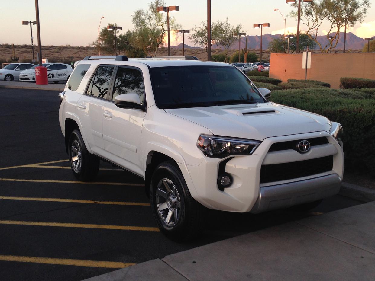

Shameless pic of the rig in question....

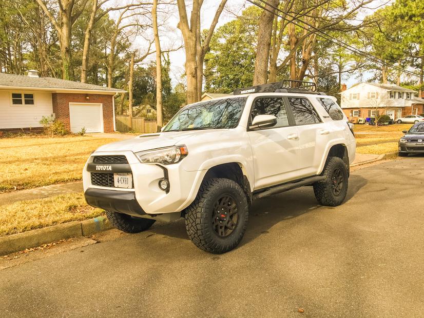

I wanted a TRD pro real bad. Dealer said I couldn't have one unless I wanted to wait 8 weeks to special a order a 2016 for 1K down. So I settled for a 2015 trail and threw down a stage 3 Icon which is in route. I bent over for the black TRD Pro wheels because I wasn't happy with other aftermarket options. In retrospect I am very glad I went this route. I wouldn't be happy with the stock TRD pro setup (not that its not bad ass), and I would be the chump that wasted money upgrading. My new child...
