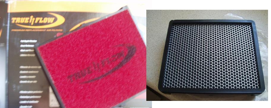

Hey folks. I finally got my TrueFlow filter yesterday that had been on backorder for a while and I could not get it installed. I know it sounds stupid but I tried everything that I could and I could not get it to go down far enough for the lid to close. I tried forcing it, prying it in, everything. The filter is just barely not fitting uinder the lip below the lid that the filter should fit under. I had to put my K&N filter back in and was a little disappointed in the whole ordeal. I am not a complete noob at this stuff as I have had a stock filter, K&N FIPK, and currently a K&N filter. But I have never had this problem before.
Does anyone have any advice or hints? I am ready to start using my nice new filter. Any help would be appreciated. Thanks.
It's been a few months since I did mine but from what I can remember it took me Three seperate attempts. As I can recall on the last attempt I made sure the bottom of the filter was tipped to the fire wall on the truck. Slide the filter with that angle until you feel it contact the back of the filter box and slide all the way down keeping the bottom edge in contact with the filter box until you have reached the bottom. Make sure both Lower Left and right corners are as far down as they can go. Push the rest of the filter straight back so the entire frame now is in contact with the back of the box. Hold it there while closing lid until you can't hold it there anymore. Near as I can remember your lid should still be open 1/2 to 3/4 of an inch. If you did a good enough job holding the filter back as you were closing the lid you should be able to push the lid down the rest of the way. Take your thumb and snap the clips to the lock position. When you go to close the lid in this way it will seem a bit unatural. It's cool, as long as the lid closes and locks you should be good to go. It does take a bit of force, just don't use excessive force.
Hope this helps...Oh I forgot, be patient! Let us know how you like the filter. I still love mine. Good Luck

It is a very tight fit but well made. I also was worried about the fit but You do have to Pressure it in and get one side latched and then press down on the otherside of the box to lock it down. You could always take a dremel and shave some of the plastic off but once you get it in it will be fine. As you can see it is made much better than the stock Yota Filter and alot of the other brands onthe market.
