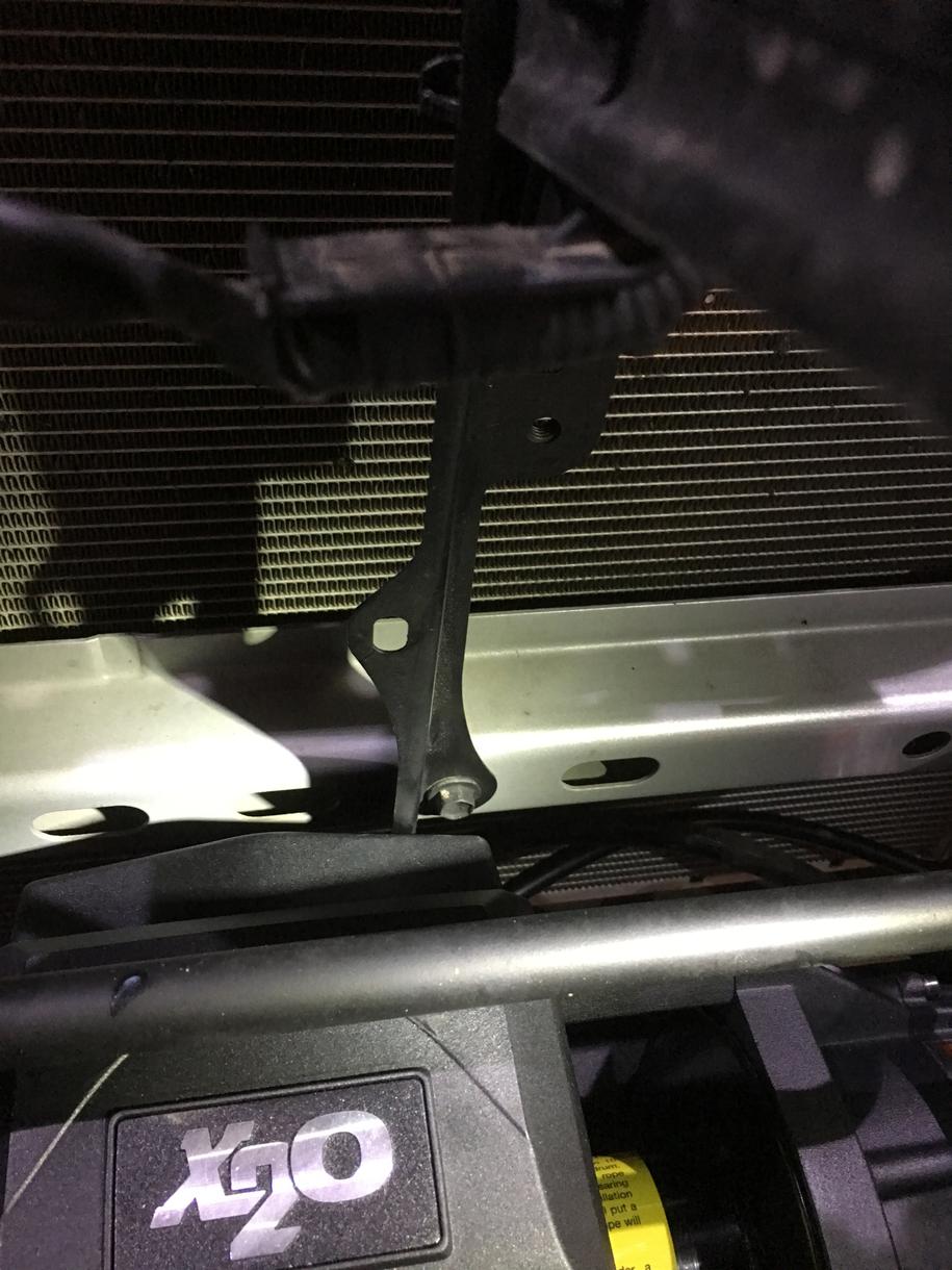

[MENTION=157598]r1verf3nix[/MENTION] [MENTION=145940]24poepoe[/MENTION] looks like both of you have a smittybilt x20. Did you have issues with the control box rubbing on the vertical metal bracket that runs down from the hood latch?

Only pain points I've ran into so far were the vertical bracket running from hood latch (see post above). I ended up just bending it a bit with a wrench (found info on C4 bumper install thread) and I ended up cross threading one of the bolts that goes into the radiator support frame. Will order a tap and try and fix it.

Here's the best picture I can get of the clearance with the X20 series 10K winch (solenoid mounted on top of the winch not on the side).

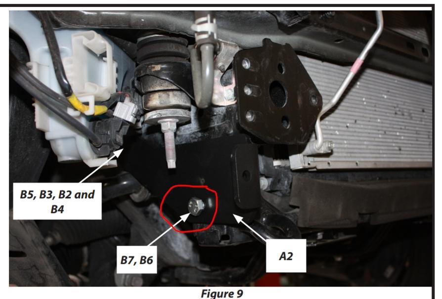

Best way to bolt these three bolt is to get the bolt near the A2 leader in pic below just barely started then get B7 mostly threaded in then do the B5 bolt.

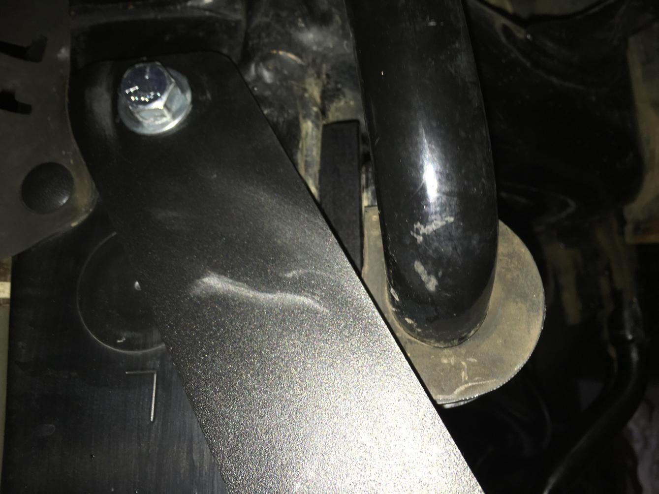

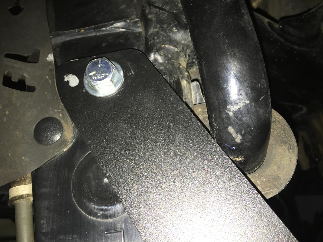

Another concern I noted while doing this install process is the proximity of the frame extension bracket to the sway bar. They were just barely not touching but certainly would be on flex. Luckily I had a sway bar relocate bracket kit from my Icons I'm about to install. Bolted that on to give some clearance.

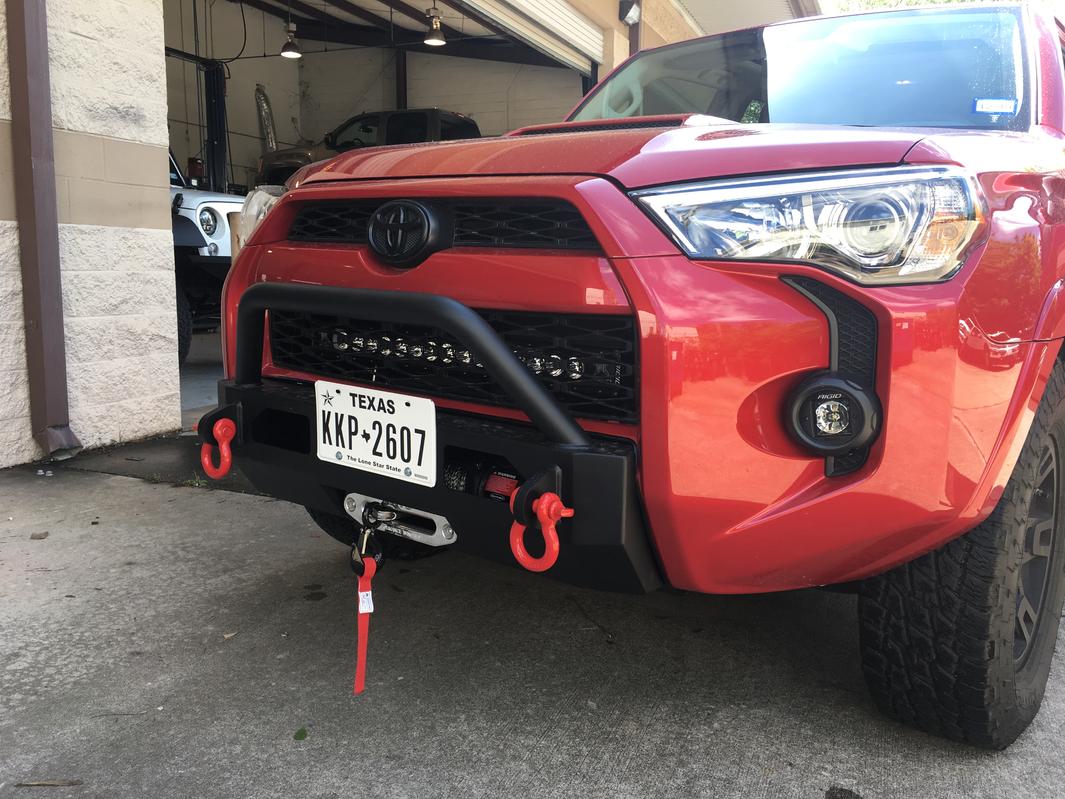

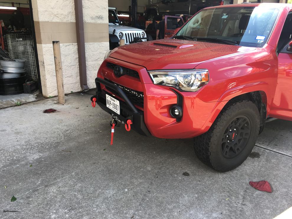

2018 front end *almost* complete. Recommendations??
Got mine installed this week. The guys at 4Wheelparts did a nice job on the install. Looking for recommendations on leveling out the front end now.

Installed mine today. Things I found out, tracing the trail silver piece on the bumper works but the opening could be a little bigger. I had to file on one of the inside bolt holes that goes to the frame horn to get it to start. Warn steel hause style fairlead will be here Wednesday.
