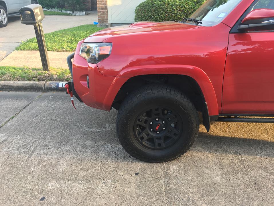

Fixed it....
Now it looks proper.

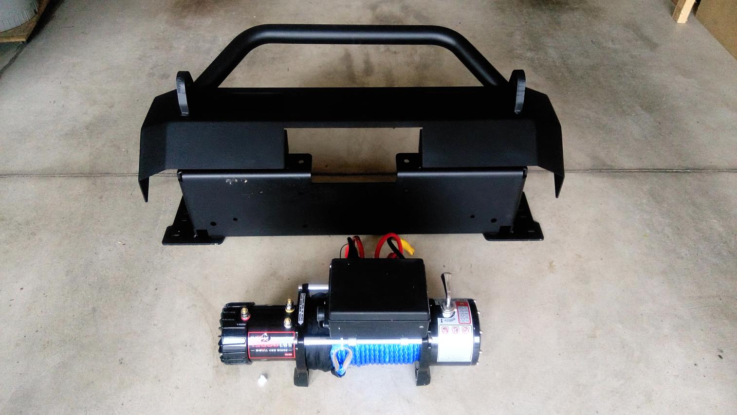

I thought I read somewhere that you can mount this and add the winch later. Is that true or do you basically take it completely off to install the winch?
If they had it to were you could get the winch in without taking it off or at least mostly off (MAYBE) you could remove the top mounting points and "pivot" it down but I doubt it.....I would like to shake that engineers hand.
You can put the winch in the bumper with it mounted if the front fascia is off. That’s how I installed mine.

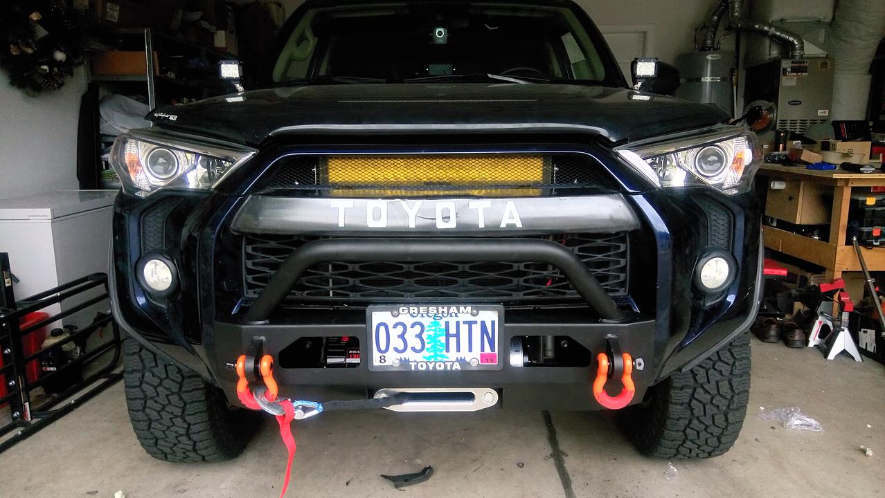

I used a Smittbilt XRC 9500. Bolted up to factory holes in bumper.
Couple things I noticed while installing:
If you have an Icon Shock Resevoir Bracket, the bumper bracket is going to overlap it and you're going to have to drill through it for the rear bracket bolt.
If you remove an additional brace, you can reinstall the plastic radiator side shrouds with minimal cutting.
Finished product.
Finished product.
Very well done sir. It looks very solid on the darker colored 4R.
