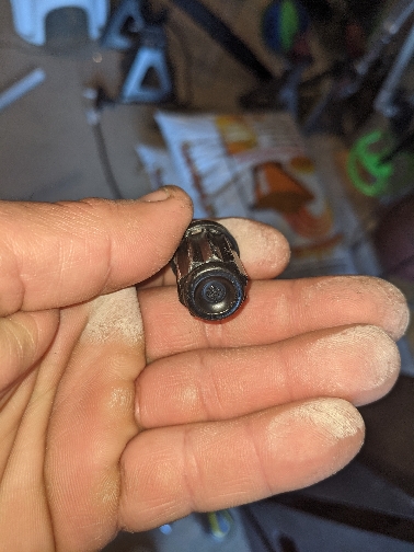

Help. Got new wheels and tires for my 09. Method nv305. Installed the fronts and noticed , I have a little less thread off the stud to grab. Is that ok? About 1/4 inch, maybe a tad more. I can still torque it properly...

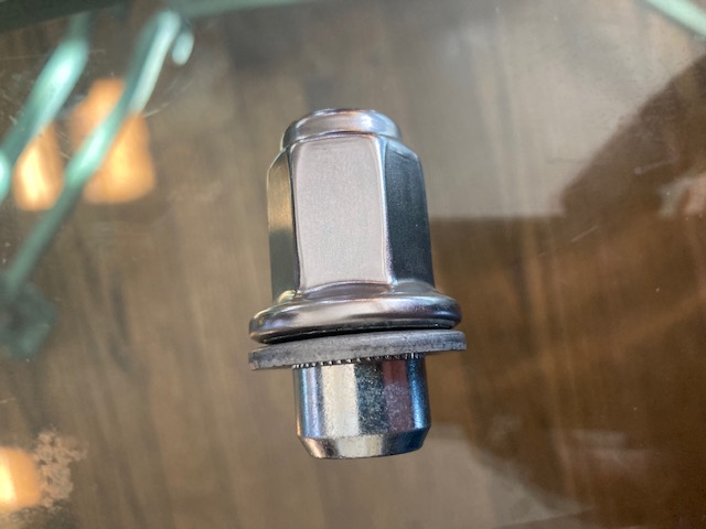

Is there 1/4” of thread above the surface of the lug holes? If so, you should be okay because the nuts are threaded to about 1/2” below the surface of the lug holes. I’m assuming you have more than 1/4” of stud sticking out of the brake rotors. There is about 1.5” of threading inside the lug nut.

Did you buy acorn extended thread lug nuts or are you using the shank style ones like in the picture above?

I looked up the wheel and they require acorn lug nuts. I see you ordered gorilla acorn nuts. You shouldn't need longer studs as ads2539 mentioned.
So what exactly is going on? Need a few more pictures of your issue.

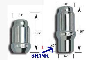

Long story short, they need to look like the ones on the right, not the left. This is a generic photo ignore the measurements.
