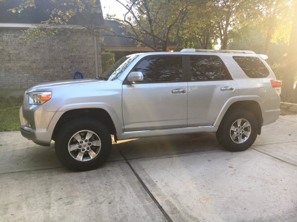

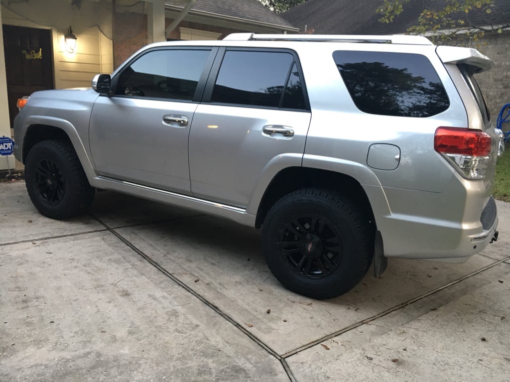

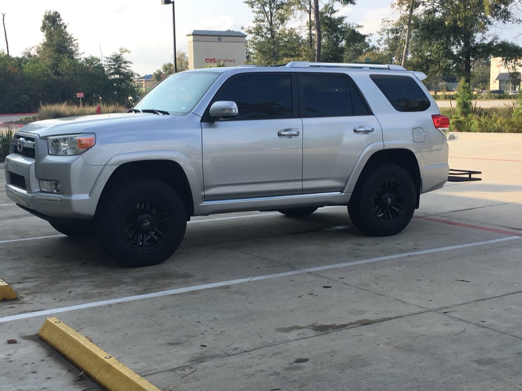

Finally got my new 275/70r17 Cooper AT3’s I installed today. I am running Bilstein 5100’s set at 2.5” front and a 1.5” daystar spacer rear. The wheels are MB TKO’s with a -6 offset. The tires rub the fender liners on the outer edge of the tire at full lock. I tried pulling the liner forward but can’t get it far enough to not rub at least a little. I know this will drove me crazy eventually so I’m considering throwing my stock wheels back on. Before I do I wanted to see if the general opinion was that it was the wheels causing the rubbing, as I will be pretty distraught if I go back to stock wheels and these tires still rub. I’m pretty bummed as I love these wheels on the truck, but don’t want to deal with the rubbing. I’m confused as it’s the outer edge of the tire that hits on full lock, I would think pushing the wheels out more would improve the situation not worsen it, but I’m not the brightest when it comes to offsets and spacers. I’ve read the tire thread and the fender liner mod threads and am still at a loss so any help would be appreciated before I spend the money to put these back on the stock wheels.
Pushing the wheels out makes them swing through a wider arc, so if anything it makes it more probable you will have rubbing. It sounds like you have wider wheels and pushed them out another 6mm. You also added a wider tire which exacerbates the problem. Did you already relocate the fender liner the 1" recommended forward? If so, did you also trim the fender lip forward to match the liner? Sometimes everything we try will still not work. It just varies too much from vehicle to vehicle. But we should be able to get you figured out.
I did move the liner forward however I doubt I netted a complete inch. Maybe 1/2-3/4”. The photos I could find were more TE vehicles which apparently have a different liner. I didn’t trip the fender lip as the tires weren’t coming anywhere near it. My liner has two “humps” or ridges that stick out further from the the rest and that’s where they rub. In drive it’s not terrible but in reverse they grab the lip of the liner and it’s pretty rough.

Thanks! UCAs are on the list and will probably get done within the next 6-12 months but not in the immediate future. I believe I still have the option to return these wheels to discount tire, of course I expect to pay for the labor and possibly a restocking fee, but if I don’t return them now I’ll likely lose the opportunity.

I believe the offset on your stock wheels is 15mm. If that is accurate going to a wheel with a -6mm had the effect of moving your entire wheel and tire package out by about eight tenths of an inch effectively increasing the radius of the curve it travels through when you turn the wheel.

Your wheel is the culprit. Bring the wheel out (neg offset) will make it WORSE. Simple geometry. Going back to stock will greatly mitigate, if not totally eliminate the issue. I'm currently at stock height with 275/70/17 without rubbing. Using stock wheel with lift will actually reduce rub because the tire's widest point will be lower where the wheel well opens up more.
Ended up going back to stock. Will keep an eye out for some TRD or at least TE wheels but for now I’m happy with it!
