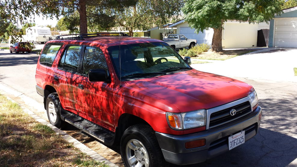

My buddy gave me his 96 4runner for FREE. He's the 1st owner and he puts in 333000 miles and never had any major engine breakdown until last week when I received a call from him about the car shaking and coming out with white smoke from the tail pipe. He took the car to the mechanic and the diagnosis was blown head gasket and its going to cost him about 1500 bucks. OK, long story short he gave me the 4runner for free and he ended up buying a brand new rav4. My question is should I fix the cylinder head or replace the engine with low mileage engine like those surplus engine from japan, either or its going to cost about the same. Any advice would be helpful....

if your going to keep it. i would look into replacing because 96 have a common problem with HG failure from use and over time. our 96 bought new, we have done 3 hg and it has 325K miles almost like yours.
but my 00 has never had a hg fail at 205K.
so if you keep it expect the hg to fail again or the other side to go.
sweet score tho man!!!
while your in there check when the TB and water pump were done last.
Put in a better used engine. I know these 5VZ-FE's last a long time, but 330k miles is pushing it! Sooner or later something else is going to fail on you. Plus a used engine with less miles on average will be more efficient (more HP/torque and better gas mileage than an engine with heavy mileage)
96, 240k mileage with no water in the oil. Original HG. These motors as a whole have HG issues, but older did have it more.

by the way it's a 4 cylinder 4x4. My buddy just had a major maintenance done on the car not long ago. But will definitely check/replace parts if necessary. thanks for advice...
It's a 4x4 4 cylinder with 3RZ engine. Thanks for your advice!
Yeah sorry must have missed that part.
If you are dropping in a new (to you) engine, you might want to consider fixing up the new one since the engine is already out depending on how many miles it has. I'm talking about checking the injectors, throttle body/plenum cleaning, removing excess oil deposits, replacing the valve cover gasket, etc. Nothing crazy but it's just so much easier to do when not mounted. Just a suggestion though, it really would depend on the state the new one is in.

OP, you have a rare color. Cardinal Red. Only available for the 1996 model year. I would replace the engine if the cost is the same and rebuild the old one over time.
