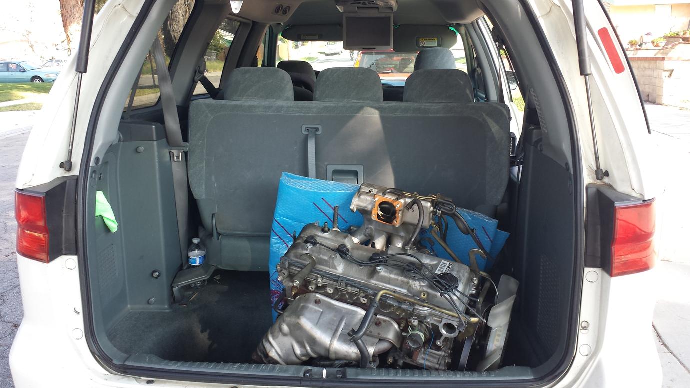

finally got my JDM engine.
no truck no problem!!! fits right in my mini van!!

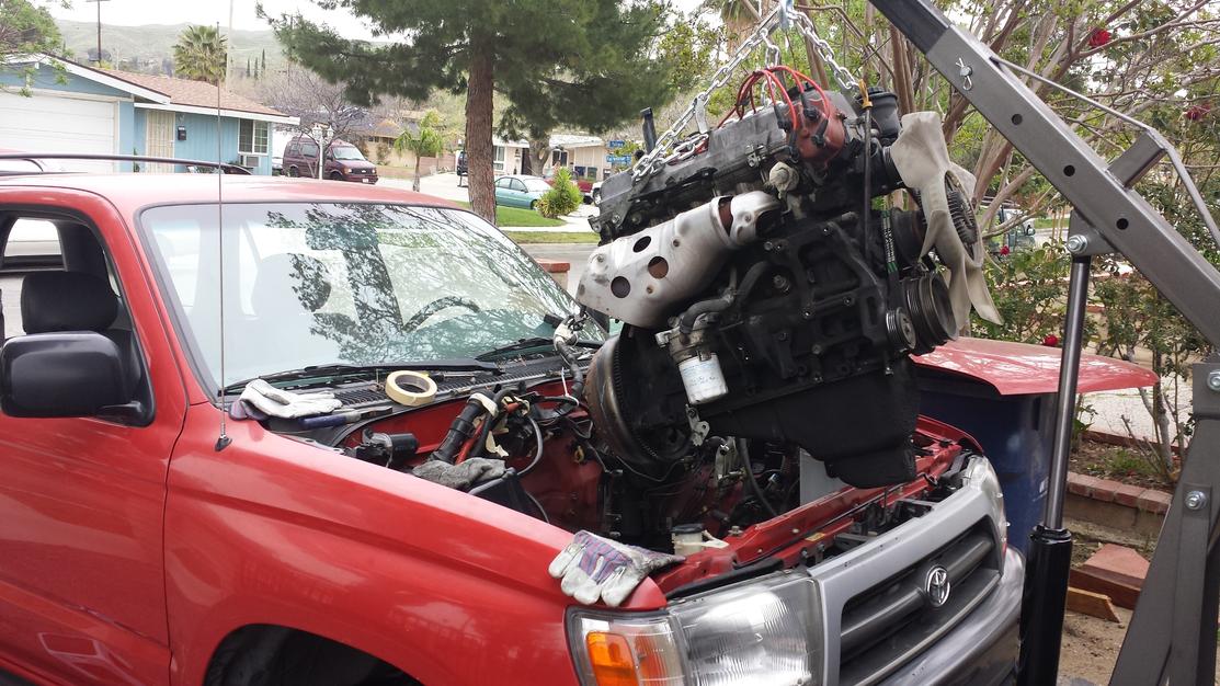

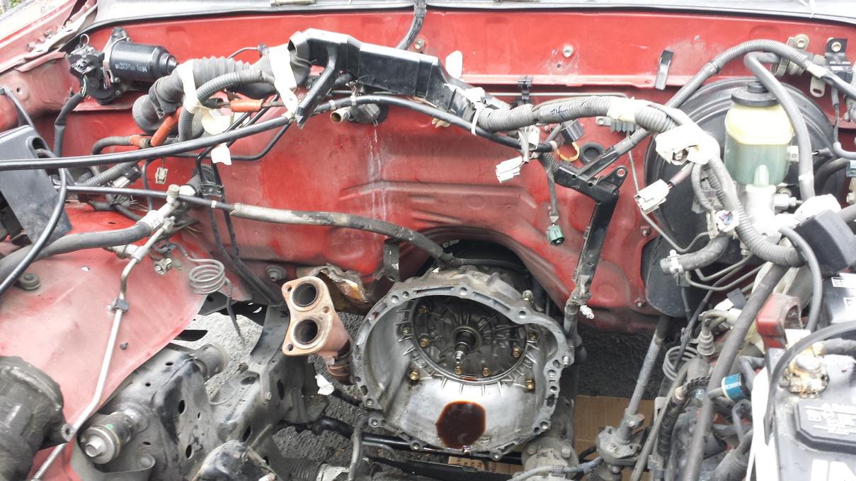

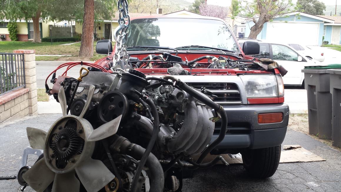

progress on my swap.
I'm not trying to do a write up but I would like to share some update photos on my engine swap.

The 3RZ is equally as good as the V6, those V6 owners just don't realize it, and as an added bonus they are way easier to work on.
You'll love it.
Swapping a 3RZ to a 5VZ is a step sideways in power and reliability, and a step backwards in cool factor.
Also, out of curiosity, what all went into swapping the coils packs to the distributor? Just bolted right up or what?
My car is a distributor type originally, therefor I have to find a distributor type engine which took me long enough before I could find it, most on the market are coil type. From coil to distributor just wont work because the harness are different also the head for the coil type doesn't have the hole for the distributor. This is all new to me so it's a learning process, I normally wrench on volvo and older mercedes.

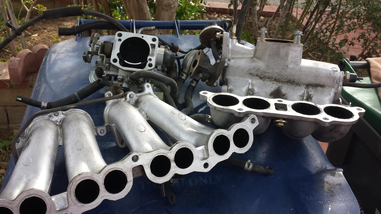

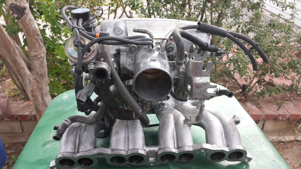

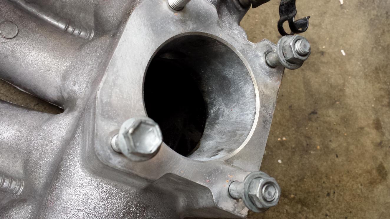

cleaning the throtle body and plenum
build up gunk over the years.
