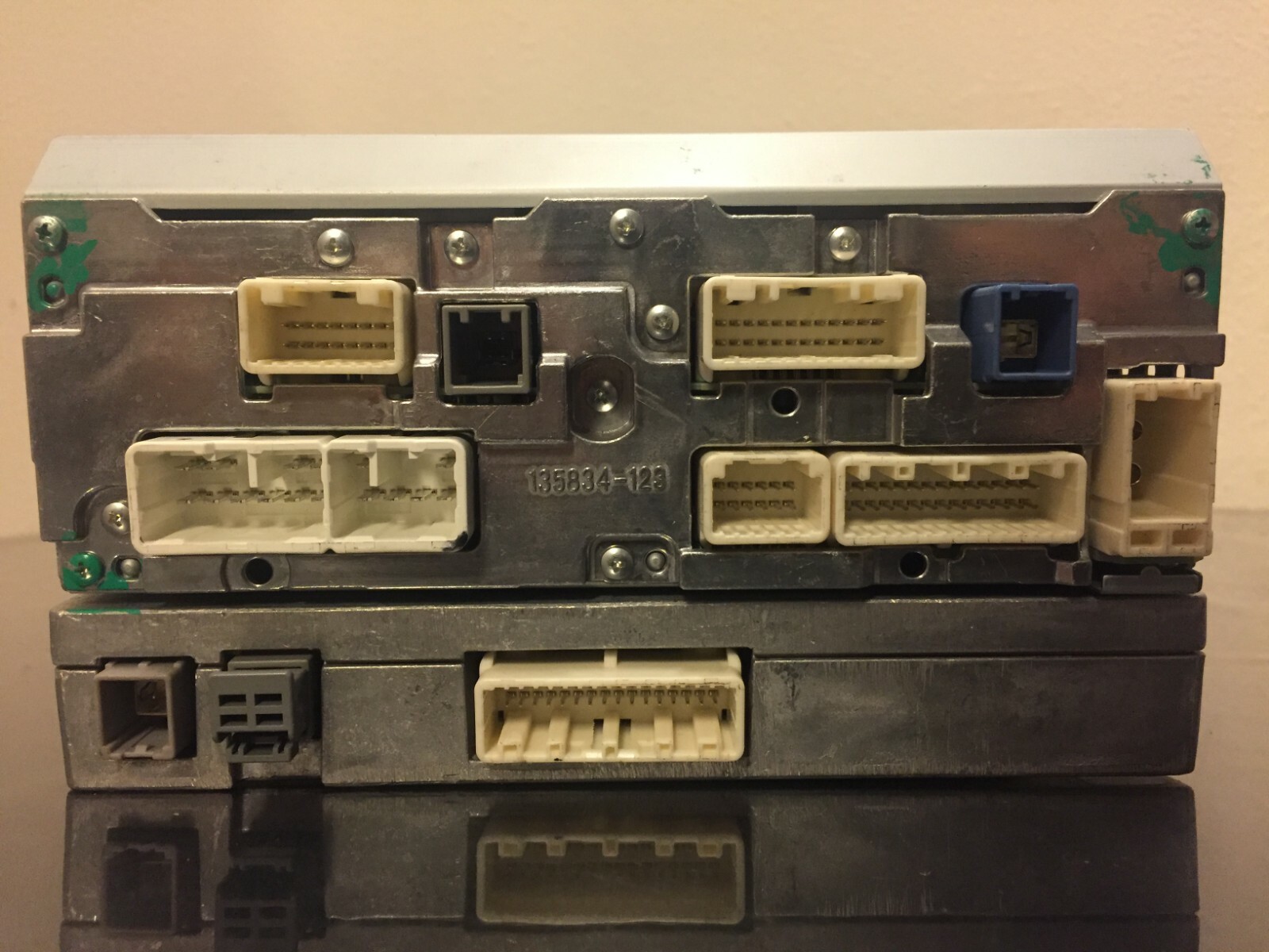

I have one from a 13 highlander had to trim the bezel, get an adapter for the antenna and clip the wire for the power antenna. The connectors are the same. Dont know if I would call it a cheaper option though. If you have questions I’d be willing to help.

If the measurements are the same as the two I installed in my 97, You have to cut and modify for any of them. Buy the adapter plugs and go to it. I think those are standard across all their radios.

You have to remove the amp and use two Toyota adapter connectors. Toyota makes two connectors to adapt new radios to older vehicles.

Edit. There is a section for audio and in it is a thread titled something like The Ultimate Scion Head Unit Thread. In there you will find probably too much info. But it will give cable adapter numbers etc. my build and repair thread goes over me installing the T1819 in my 97. There is zero difference installing that or a factory NAV unit. I have some cable numbers also.
