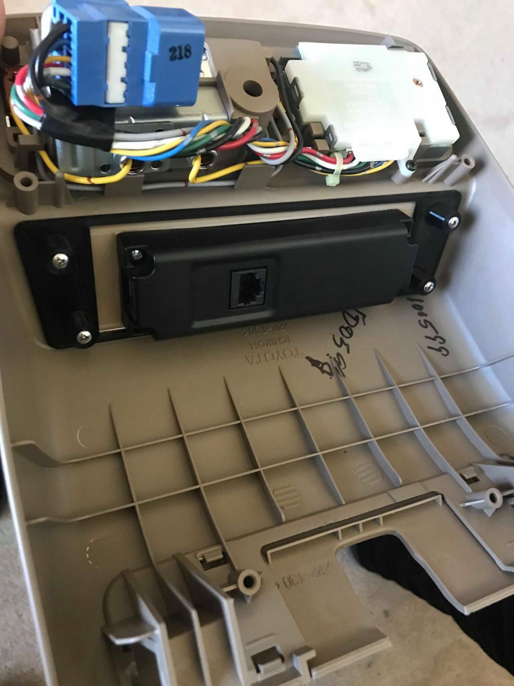

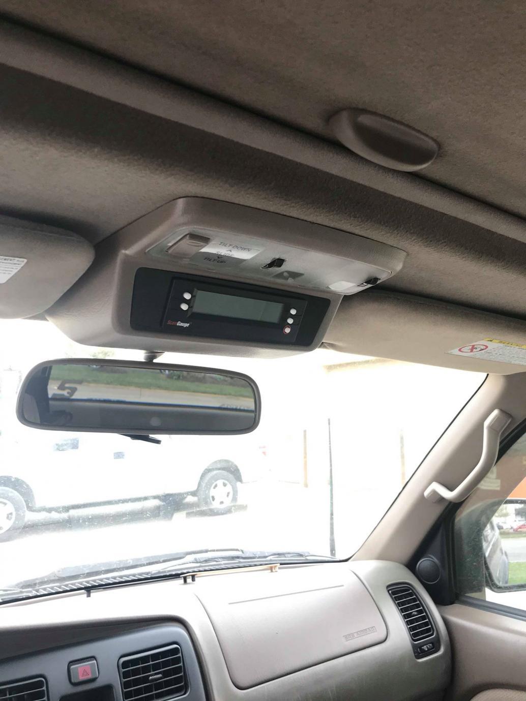

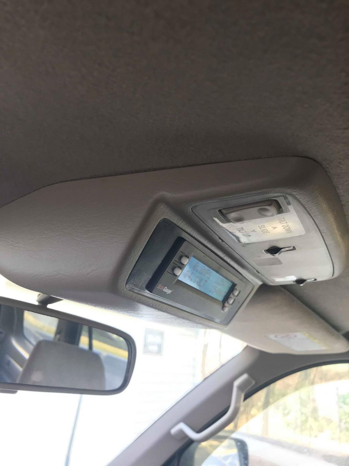

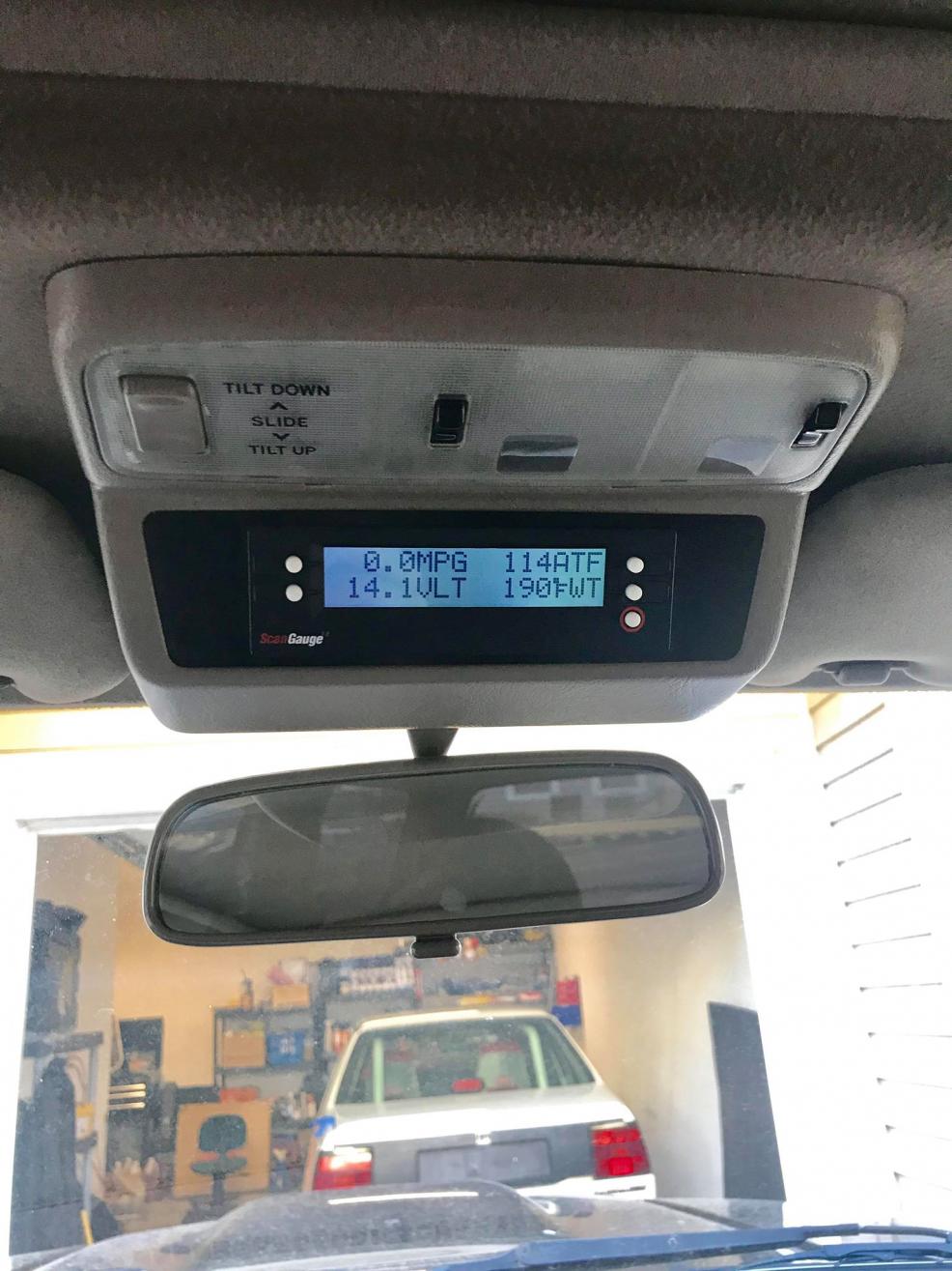

Hello everyone! I have just completed designing a Scangauge2 mount for use with a JDM Field Monitor Unit. This mount is completely designed and 3D printed by myself.
I realize not a whole lot of people have FMU overhead console standard in their vehicles, but they are easily found on eBay for around $30, and then you can install my mount into it.
I also used a simple ethernet extension cable for this to be able to hide the cable under the a pillar trim and headliner. If you'd like one for yourself feel free to PM me here or find my page on facebook: 2CM - Chris Chandler Making & Motorsports.

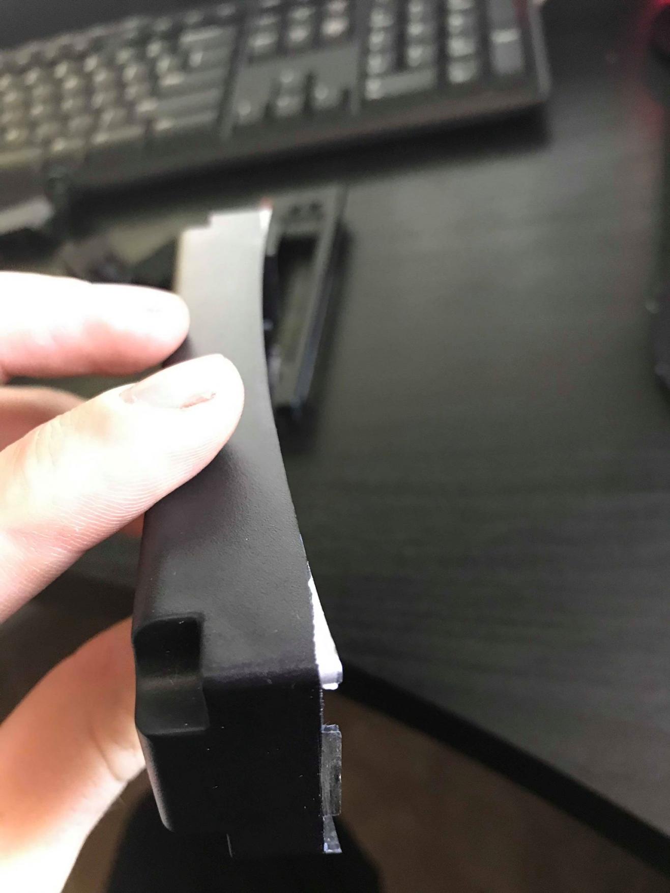

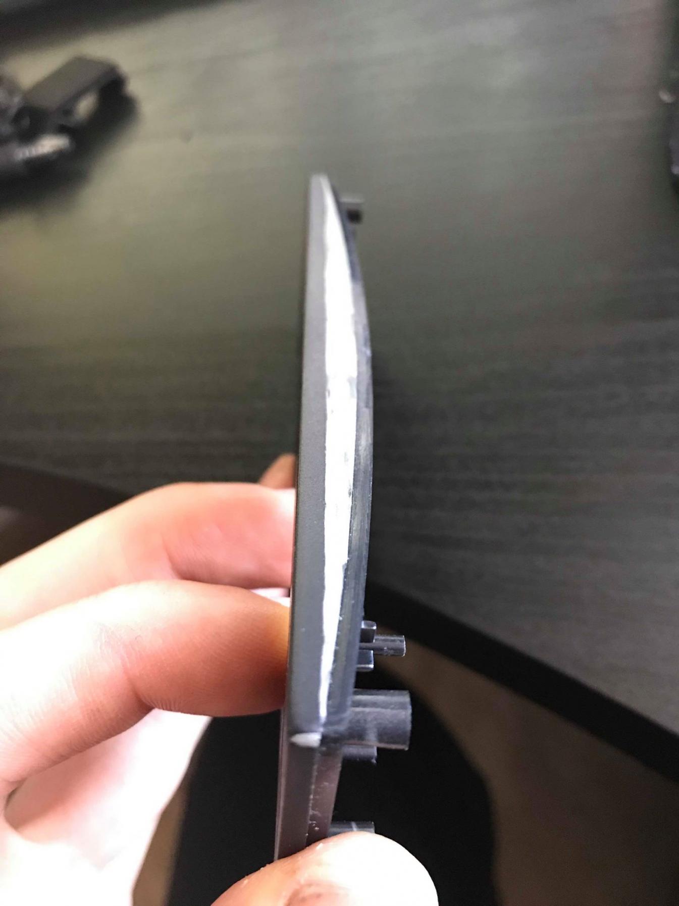

There is some modification you will need to do on the scangauge itself and those are the last two photos. It’s a pretty simple straight forward mod that shouldn’t take more than a few minutes with a dremel or even a file. You just need to remove the areas that are marked in silver so the SG can be sandwiched into the front plate. [MENTION=221997]Novashards[/MENTION] made a great writeup on the one he installed: https://www.toyota-4runner.org/3rd-gen-t4rs/254574-my-new-2000-limited-4x4-e-locker-3.html#post3268143

That's pretty cool. Looks good, nearly factory.
