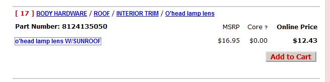

Now to find the Lens for the FMU I just got.
Yep, that's where I'm at too. Camelback does have them, only ~$13. Holding off on it till I need something else, it's about $10 in shipping just for it. Also need a donor harness so I can rewire the controls.

What's this lens you speak of? I'm guessing the cover that goes over the lights and around the controls, for you non sunroof guys.
It’s the lens hopless diamond posted the part number for.
Now to go over the wire changes needed for converting my dual switch sun roof controls to the newer single switch.
I have a local dealer who’s prices are good so I’ll drop by and order the lens. I’m also thinking about updating the maps on the 2013 Toyota Corolla nav radio I installed.
