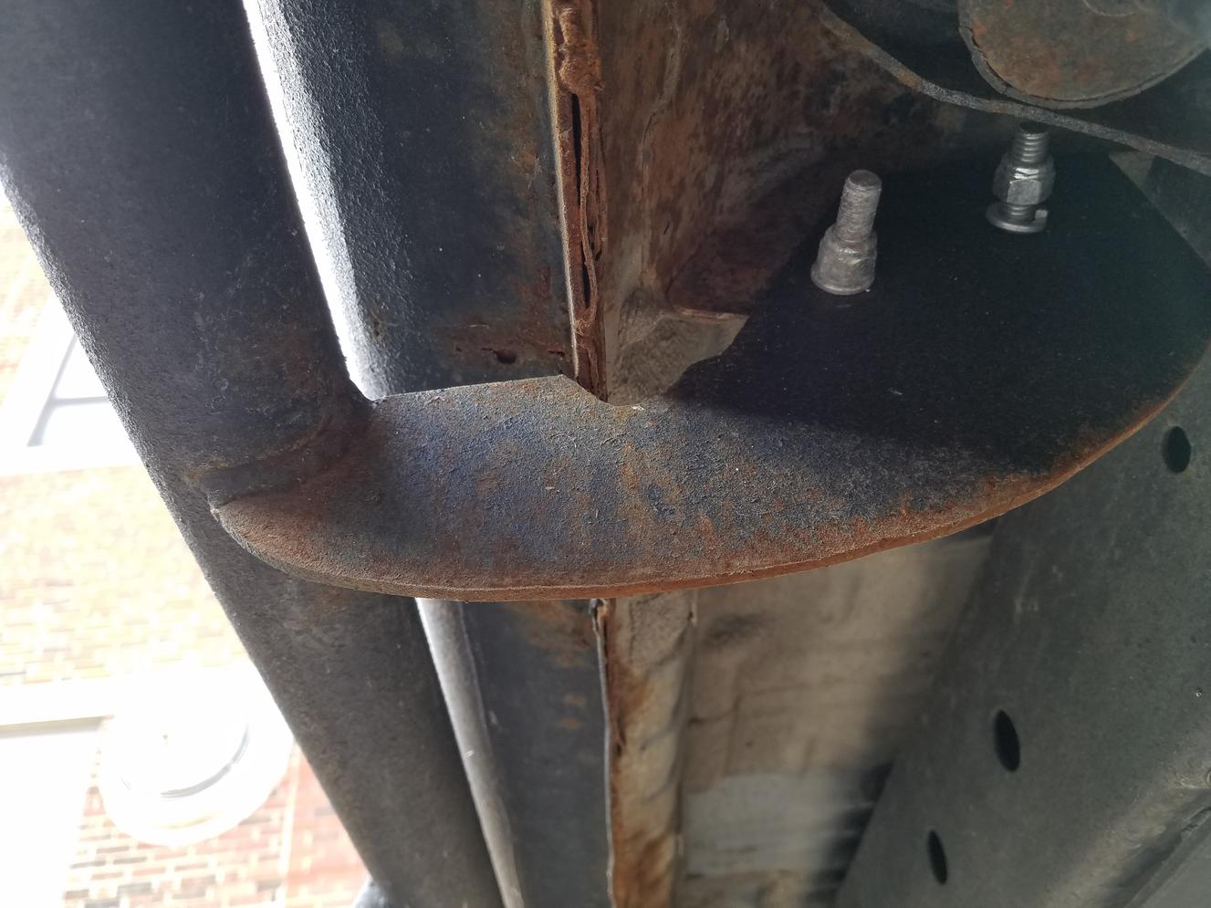

Bolted them to the original running board brackets. I'll work on pictures.

Don't mind the rust....
I'm interested to see a little write up on this. Might have a pair available for my from a friend and if I can modify this pretty easy myself I will commit to taking them off his hands.
Wow that mounts right on there... did you use the original brackets and then just cut some of it off?. Or did you fabricate the brackets yourself
I chopped off the original mounts and just fabbed some up quick like out of some plate steel that was laying around. It was a solid afternoon project. So to recap, you take a few inches off the front, chop the original brackets and fab your own, weld and drill and Bob's your uncle.
