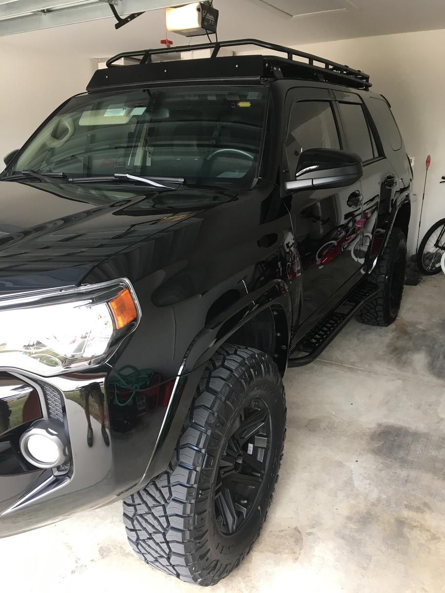

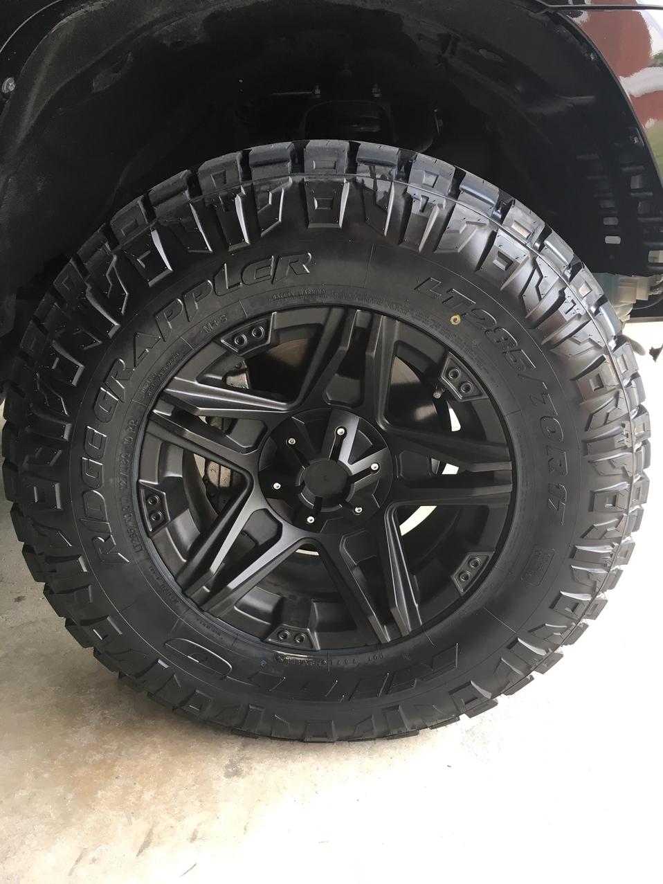

Pulled the Trigger
Got my Ridge Grapplers installed today. 285/75r17 C. $270 a tire installed
Initial impressions: Very quiet (But compared to some very long in the tooth Duratracs what isn't?)
Good street and highway manners.
Acceleration has taken a slight hit, picking up 11 pounds a tire will do that I suppose
They ride very stiff. The shop inflated them front and back to 40 psi and I could feel every little crack in the road. Dropped down to 38 front and 36 rear (what I ran my duratracs at) and seems better but will see with time. Sidewall is hardly flexed at that inflation. Keep in mind truck is loaded for daily use currently. full load is about 800-900 pounds more than that.
No rubbing at all so far but will have to see under full compression
Tires stand 33.6" tall at 38 PSI
Looking forward to seeing how they do in the wet/snow/ice/dirt
I'll report back as I get through some of those conditions

Well they sure look good....

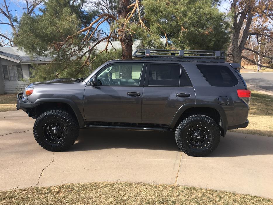

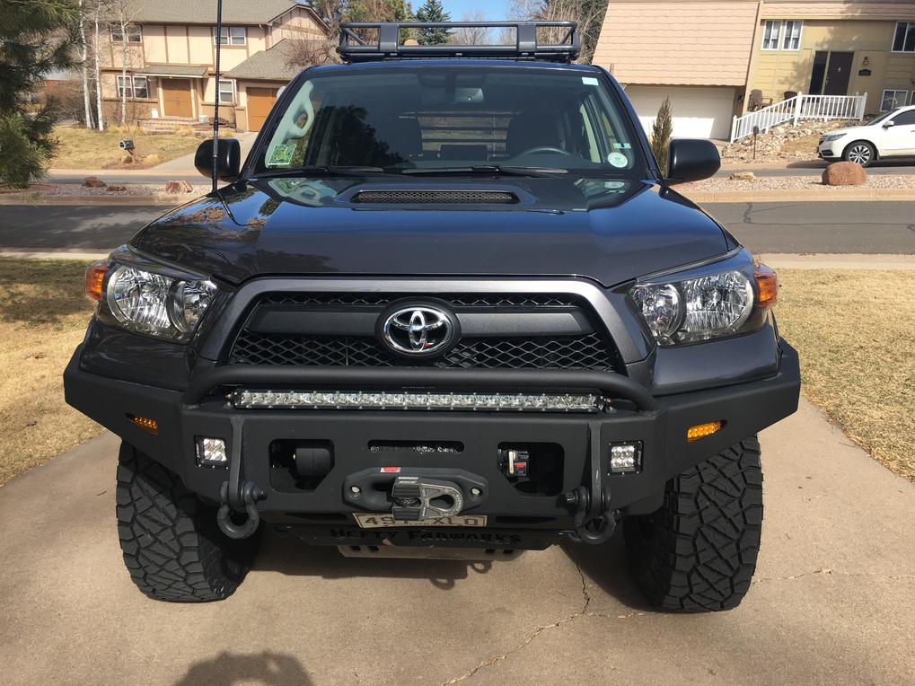

I just booted my Cooper MTP for Ridge Grapplers 285 70 17 E. I want to say the noise level is fantastic. There is almost no sound with the grapplers. My MTPs were so loud and harsh on pavement but now it feels like I'm riding on a cloud. Can't wait to test them off road. If anyone is hesitating on getting the E rated because of the fear of noise or harsh on road ride quality, don't.

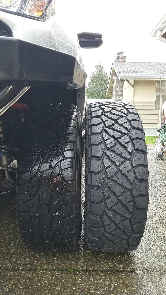

Mine were delivered today. Will be mounting them on Friday and hitting the trails on Saturday. Here is a comparison shot compared to my current 285/70/17 Cooper ATP.

Same experience here. 285/70/17 LR-E ride great.
