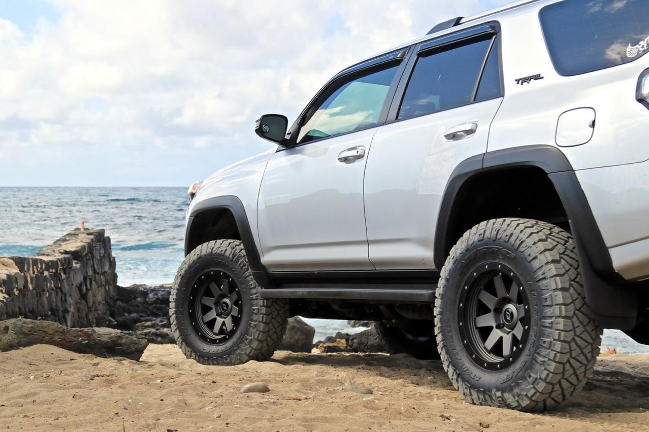

285/75R17 "C" installed on 17x8.5 SCS SR8 Wheels with 1.25" G2 Wheel Spacers. I'm really liking this setup. The SR8s are incredibly light, probably the closest to OEM weight available in an aftermarket wheel. Stoked on how it came out!

That looks great ! Do u have any issues with the tires rubbing with the spacers?
Thanks and yes it was rubbing more than I'd hoped so I took the spacers off. I got to the point of trimming where I was going to have to trim the inside pinch welds of the body. That 1.25" further out was too much. Not rubbing at all now though.

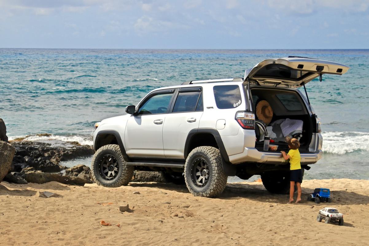

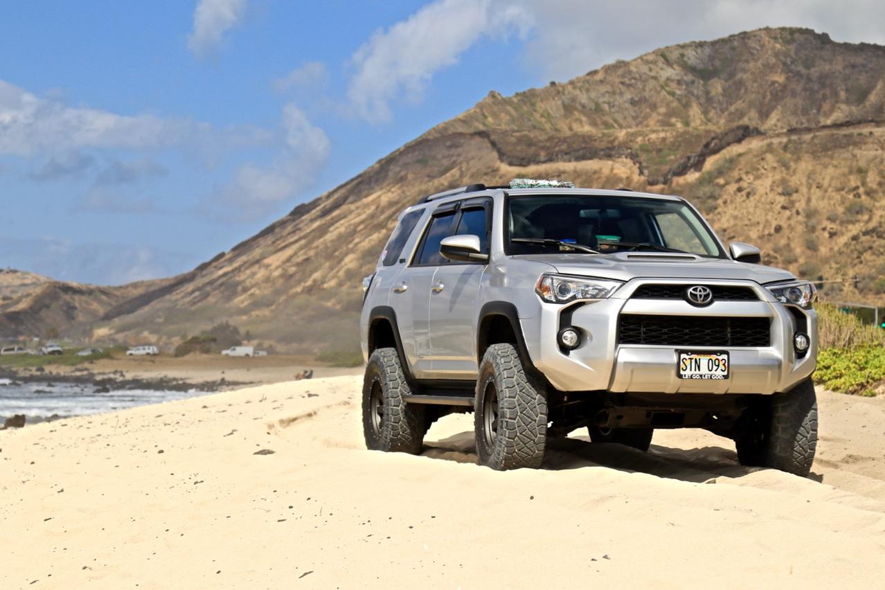

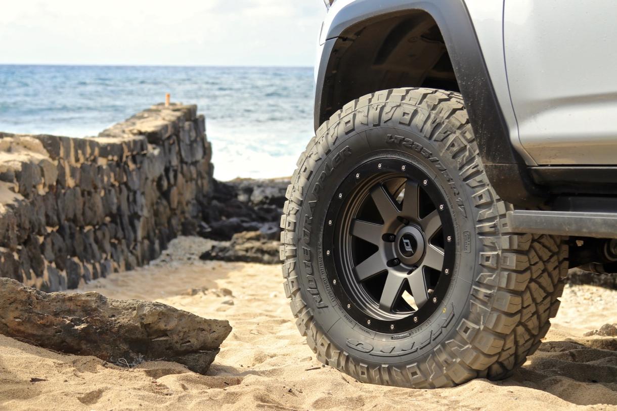

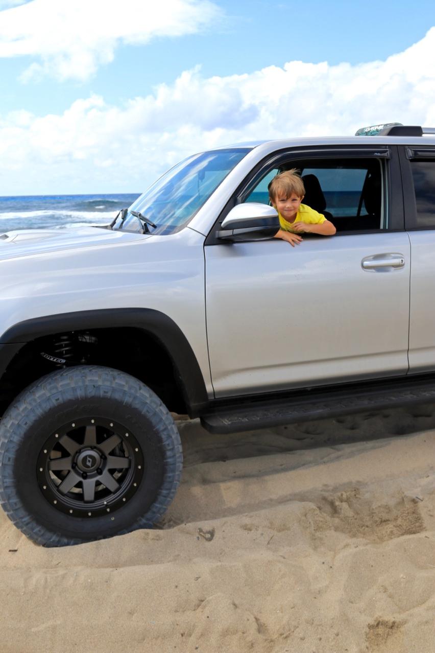

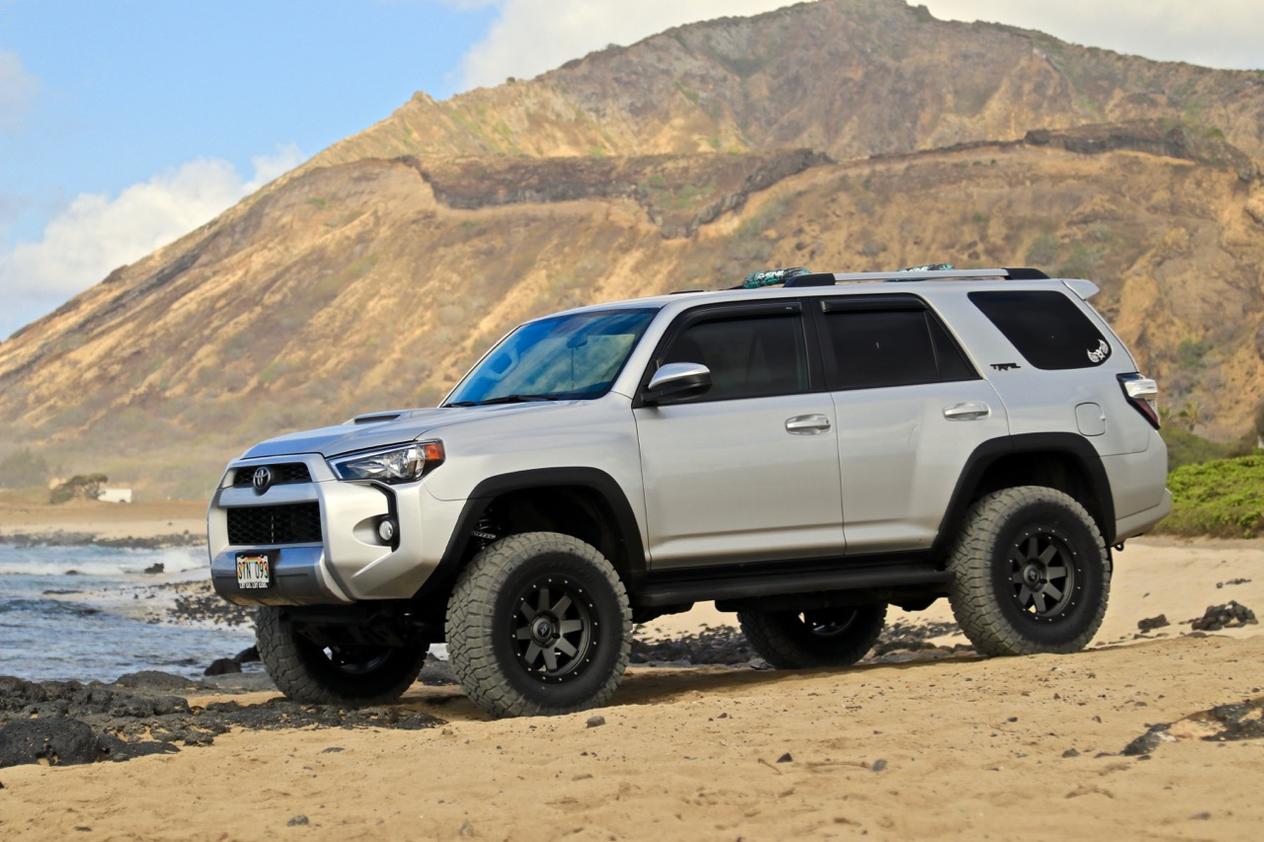

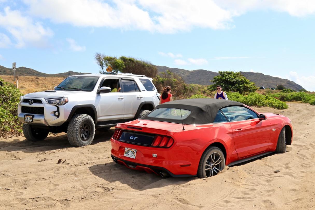

Got to soft sand test the new 34" Ridge Grapplers. They did very well, especially since they're at 34 psi. I would have air downed if I was planning on all day but just went for a couple hours with my son so "he" could play with his Axial RC Crawlers. Also stumbled upon a clueless tourist that apparently thought their rental Mustang was a 4x4. That took a solid 30+ minutes of digging the entire car out as they were to the frame front to back. We couldn't access their tow hook, which btw they don't have in the rear just in case you guys are ever in this situation as reversing them out was the only option. lol

They look great! Might be a tad big for what I want...how much lift you running? 3" front and 2" rear?

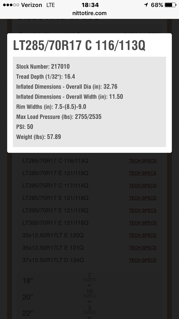

Nitto says they run 32.76" not 33.8" an inch is a big difference...that's what she said
He's running the 285/75/17 which are and inch taller than the 285/70/17.

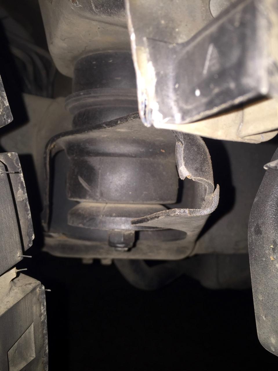

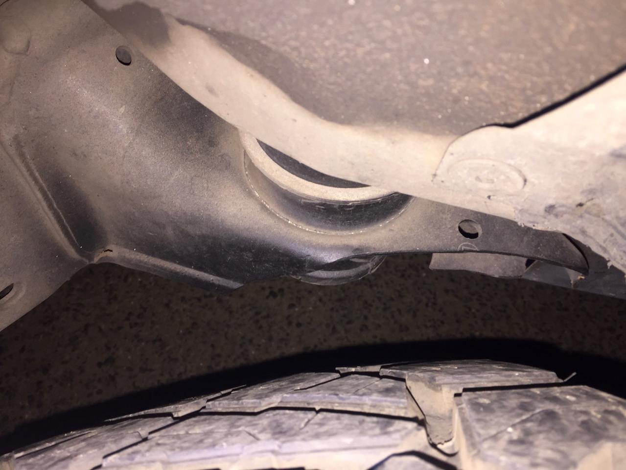

you making me wanna get 34's now lol,was thinking about getting sst pro..how much body mount chopping to fit those 34's ..any pics?
Yes, 3/2 suspension with 1" body lift as well but that doesn't make a difference about clearing the body mounts
Same for me after seeing 34s on other rigs as I had 285s for a year and they started looking too small. Definitely have to chop fairly deep to clear but worth it to me. I would have gone with the 295s as they're 33.5 x 12 but they don't offer them in C rated, only E
