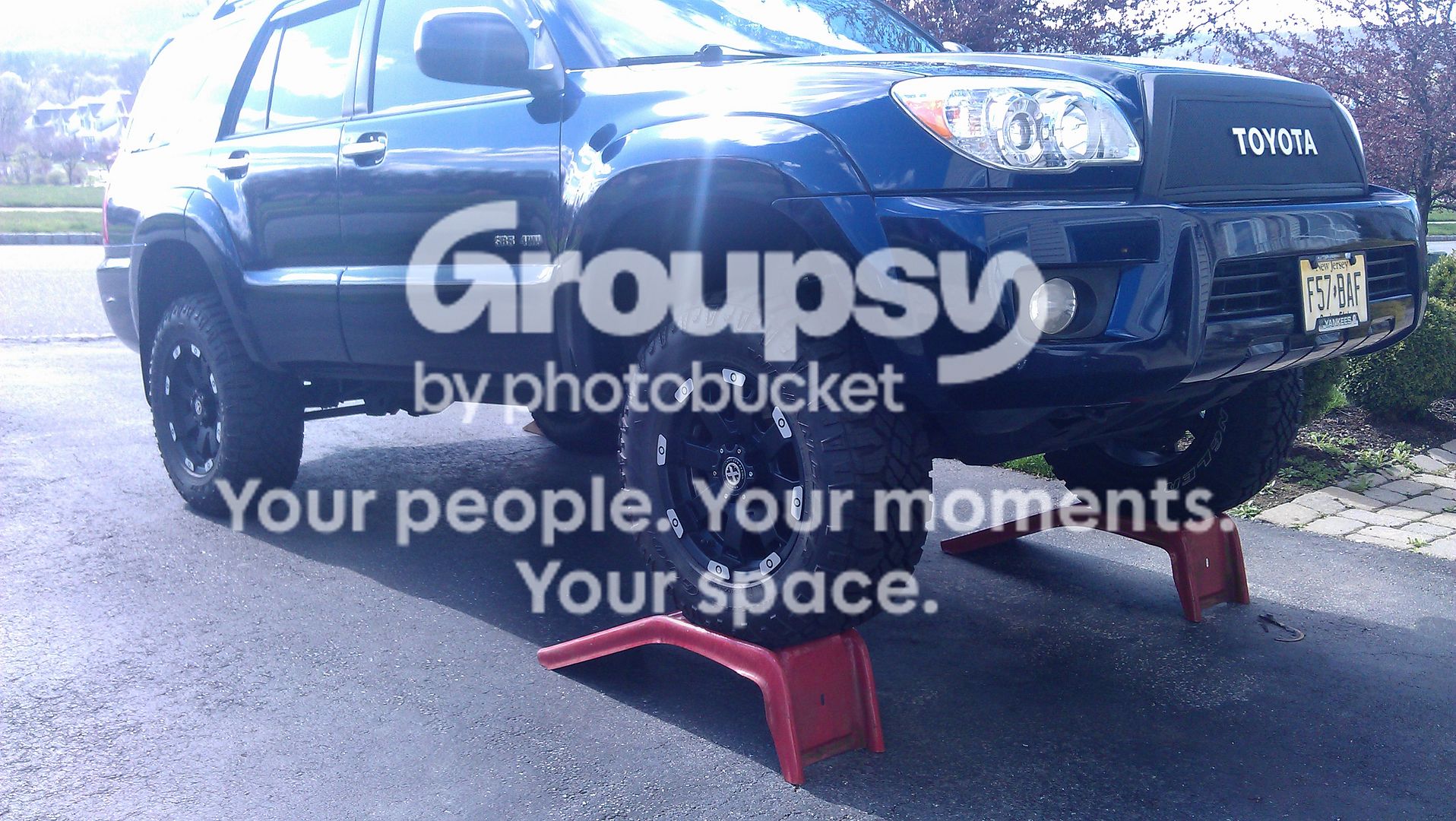

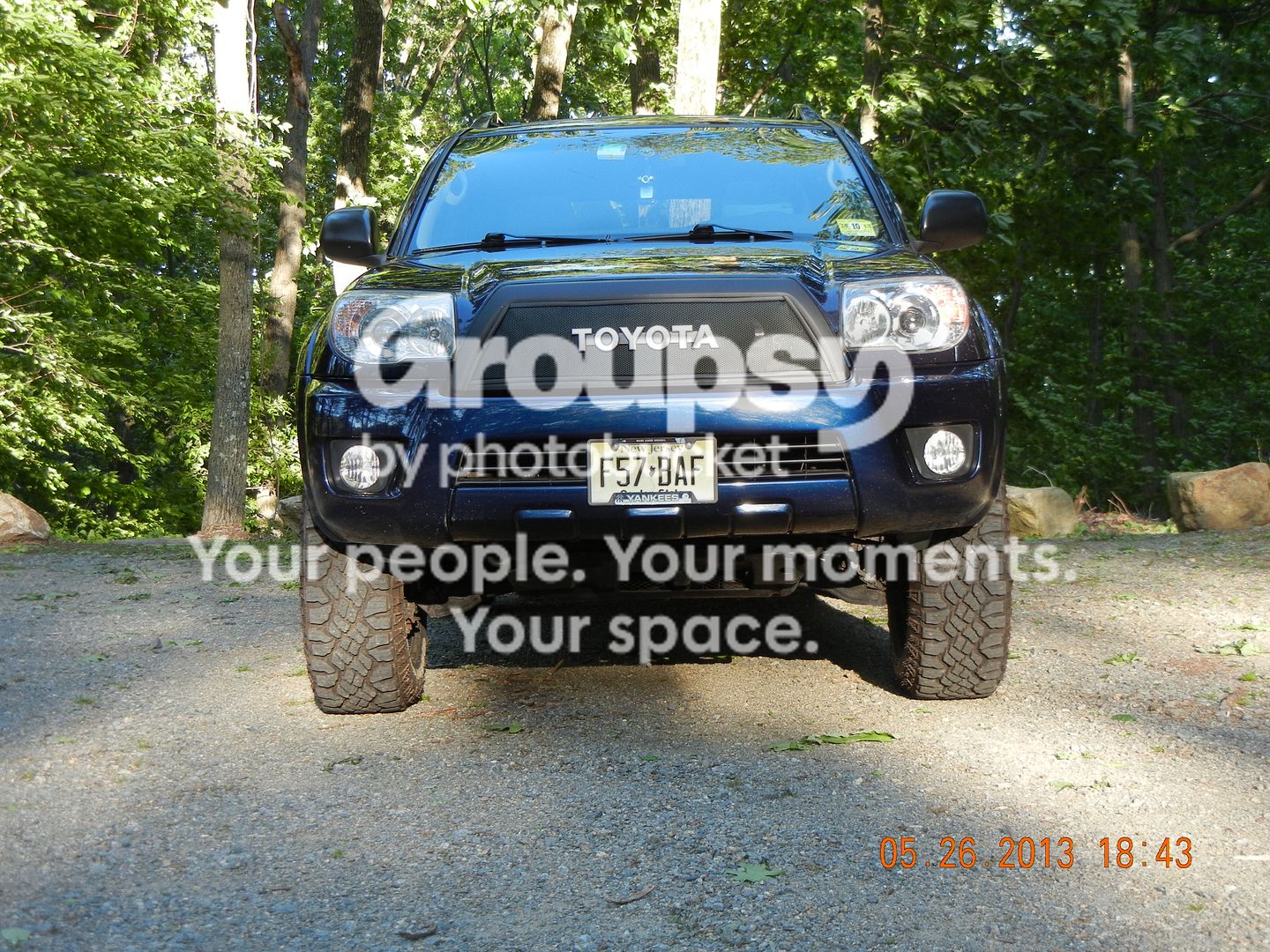

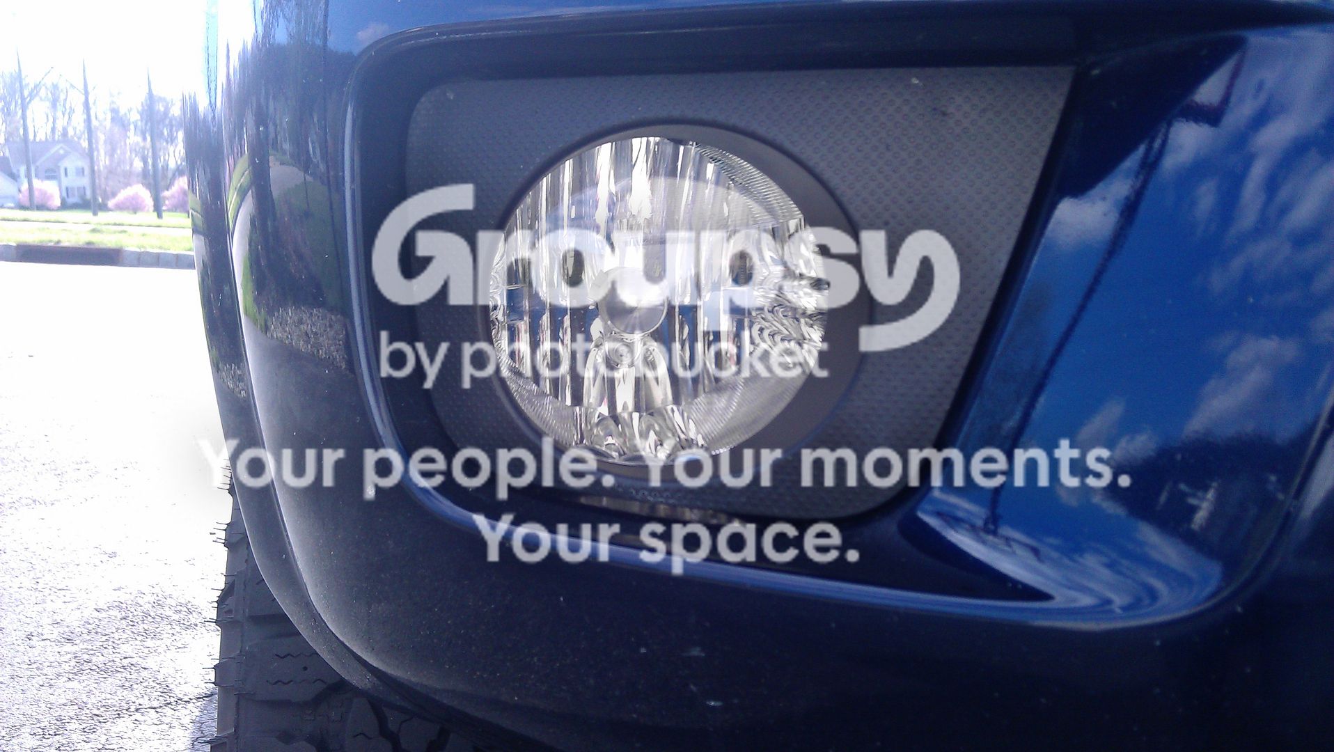

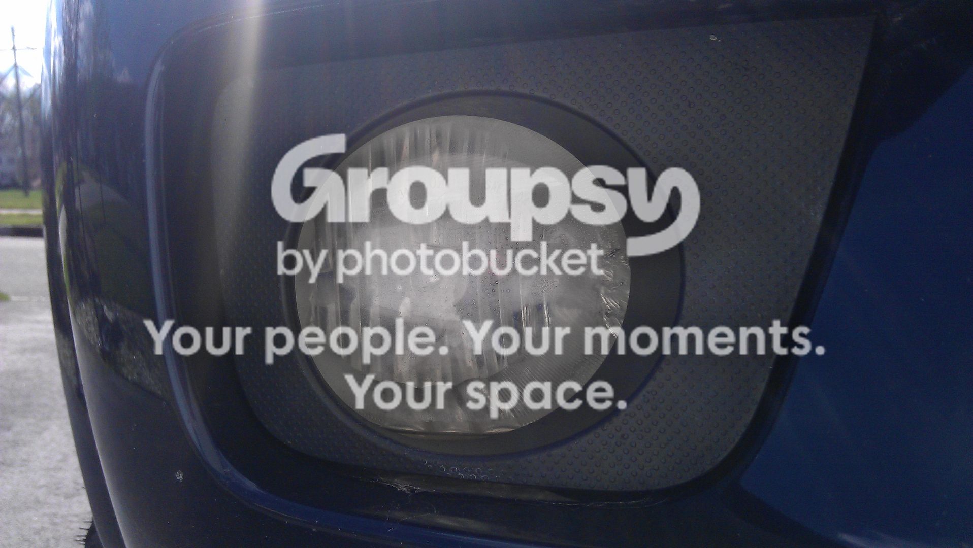

Installed the stock fog light housings I bought off [MENTION=77471]kevinpt[/MENTION]. Looks 20x better than my originals. Both had failed seals which took moisture in, plus they were foggy as hell. Putting it on the ramps allowed me to sit and kneel without having to lay underneath.
IMAG0864_zps3bdc0871.jpg~original
Before :puke:
IMAG0865_zpsa1b8563a.jpg~original
After:
IMAG0867_zpse103b84c.jpg~original
Before :puke:
After:
i also put mine on the ramps when installing my new ones. how long did it take to take the first one off?
my first one took like 25 min and the other was around 5.
glad you like them
glad you like them
Yesterday I looked under there for a few minutes to see where the clips are and was going to do it but it started to rain. So about 10 minutes for the first one today and 10 for the second one because I pulled the fender liner open to make it easier to access one of the clips. It was worth going through all that because with that angle it came off very easily. It looks like you took off the adjustment screw on the passenger side one? Just cus it was upside down, no biggie lol
Thanks again, I hope you can see how bad my originals were from the pic!

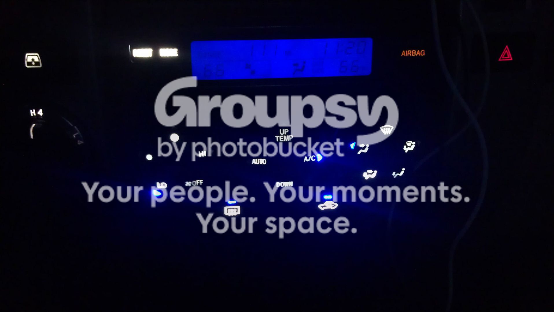

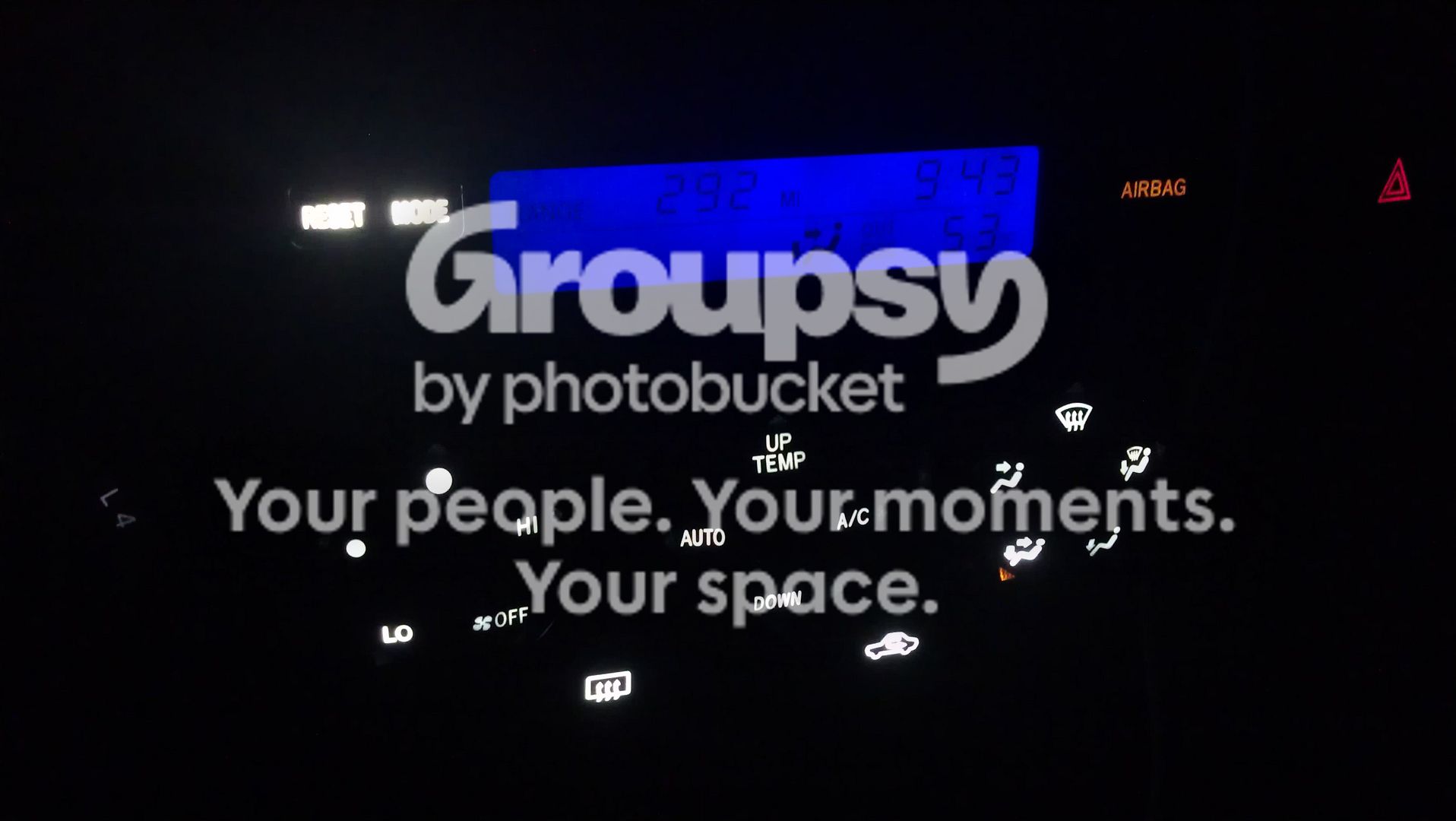

Made the screen blue last night. I like it a lot in contrast to the white! It was my first soldering experience, and I thought it was pretty fun. Next I gotta do the indicator lights.
Crappy cell phone pic but it shows the colors at least.
IMAG0882_zpsfee075a9.jpg~original
I have the exact opposite setup for mine. White Screen with Blue knobs. It's just something about the white and blue.

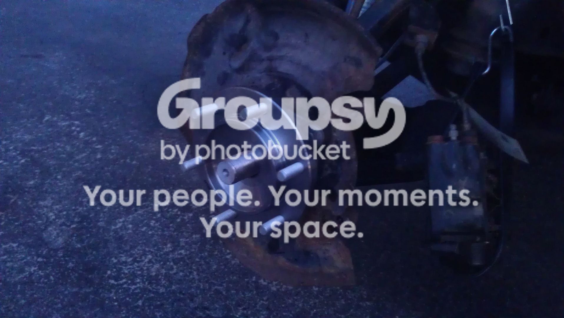

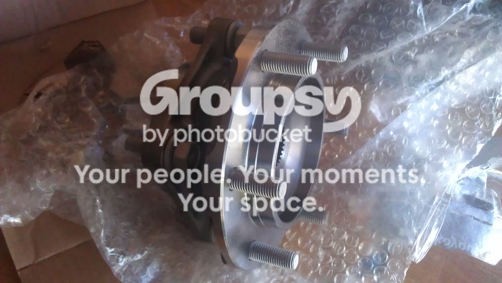

Both front wheel bearings conveniently decided to act up at the same time, with the driver side being much worse. The dealer quoted me $675 a side and I declined. I ordered full hub bearing assemblies from Blue Pit Bearings | 2003-2009 Toyota 4Runner Complete Front Hub Wheel Bearing and installed them myself in my driveway. I would highly recommend ordering from this site, Andy shipped them out very fast (I ordered at 11:30 pm and they shipped out the next day, I received them 3 days after ordering) and was very quick to respond to e-mails with questions. I spent an extra $50 per side to get OEM parts ($279 each).
New bearing fresh out of the box
IMAG0888_zps64b50aef.jpg~original

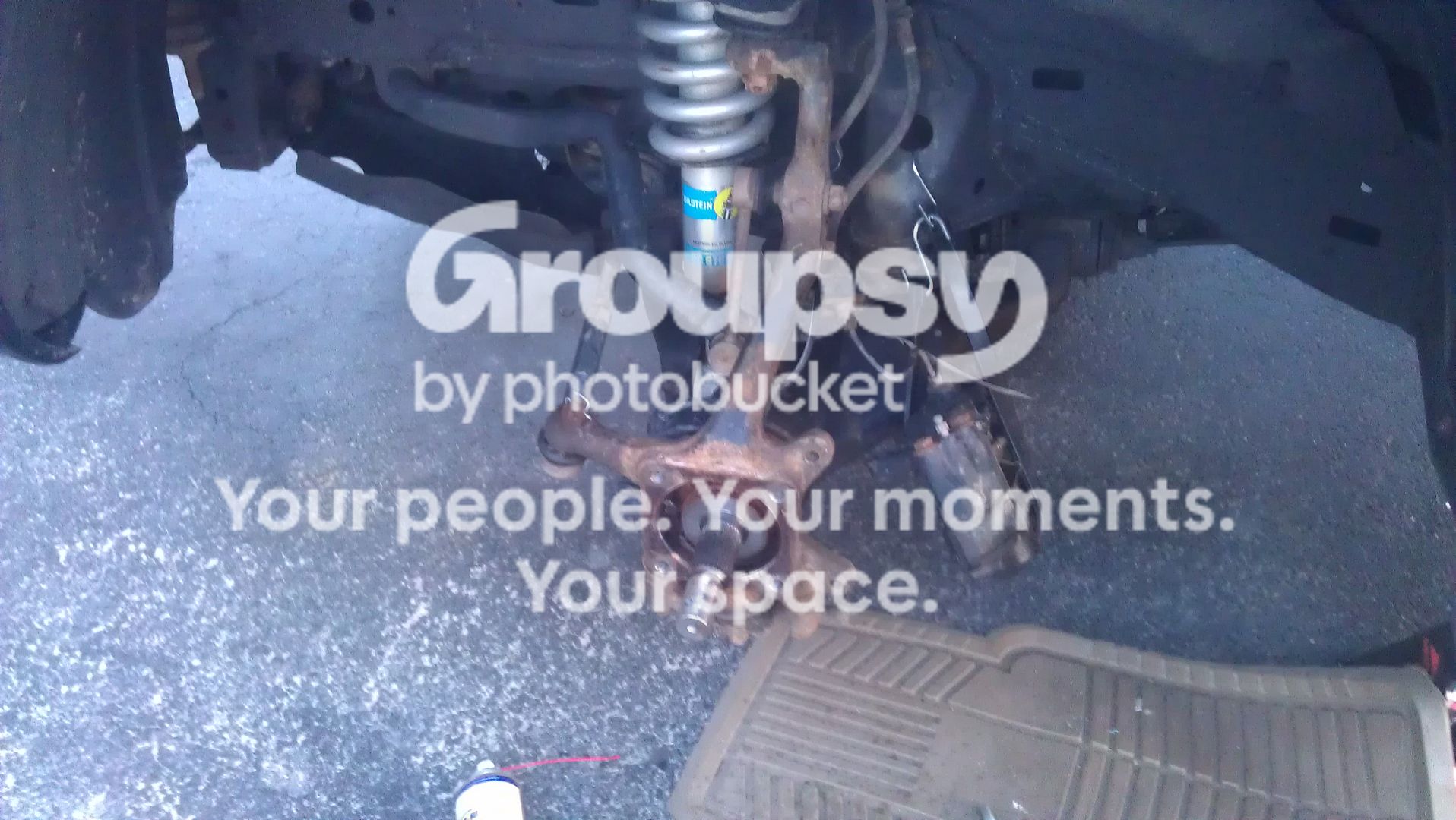

Old bearing removed
IMAG0891_zps2db3335d.jpg~original
New bearing mounted (before axle nut was put back)
IMAG0892_zpsfad3c311.jpg~original
With no help and no power or air tools, it took about 2 hours per side, I took my time.

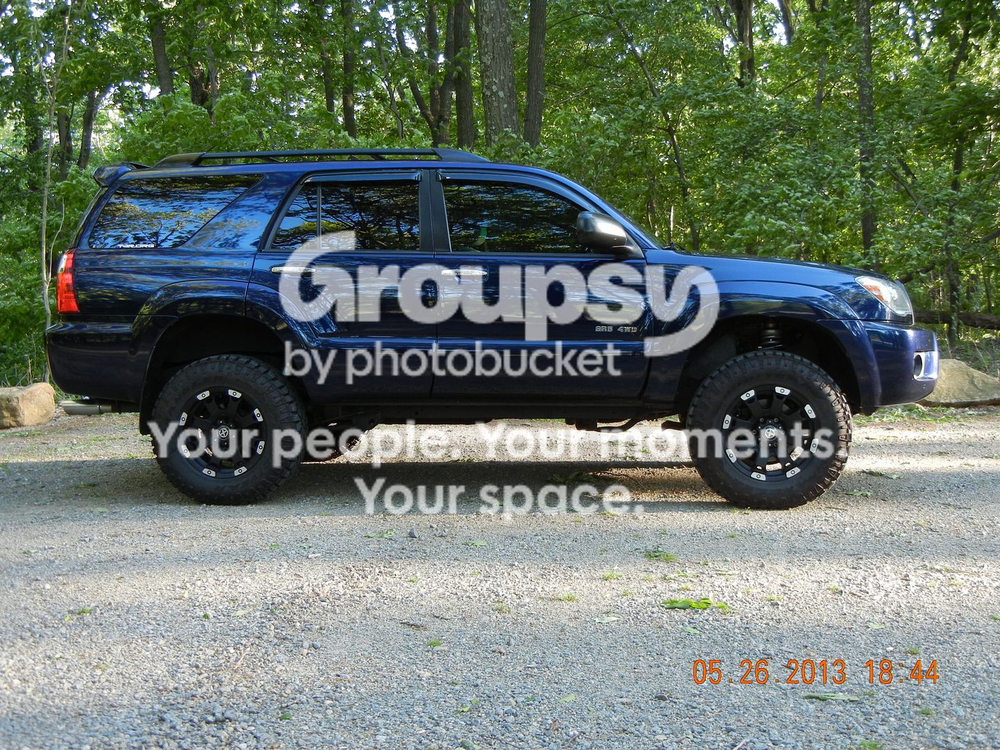

nice TOY
my 2005 is the same color. Just put on the ATXseries Assaults and Hankooks 265/70R17s. Ithink your 70'slook a tad small...but overall a tough look. ggoing to try the 3"spaceronly lift or if the tech convinces mre otherwise...
Thanks, I never thought they looked small, but some pics may indicate that. Everything looks better in person anyway (I've had numerous people ask if they were 33s). Good luck with your lift, looking forward to seeing some pics if you post them up! Also, if you have an '05 you likely have the Stratosphere Mica color. Nautical Blue Metallic came out in 2006 but the colors are very similar and I've found that you can only really see the difference in the sun. :)

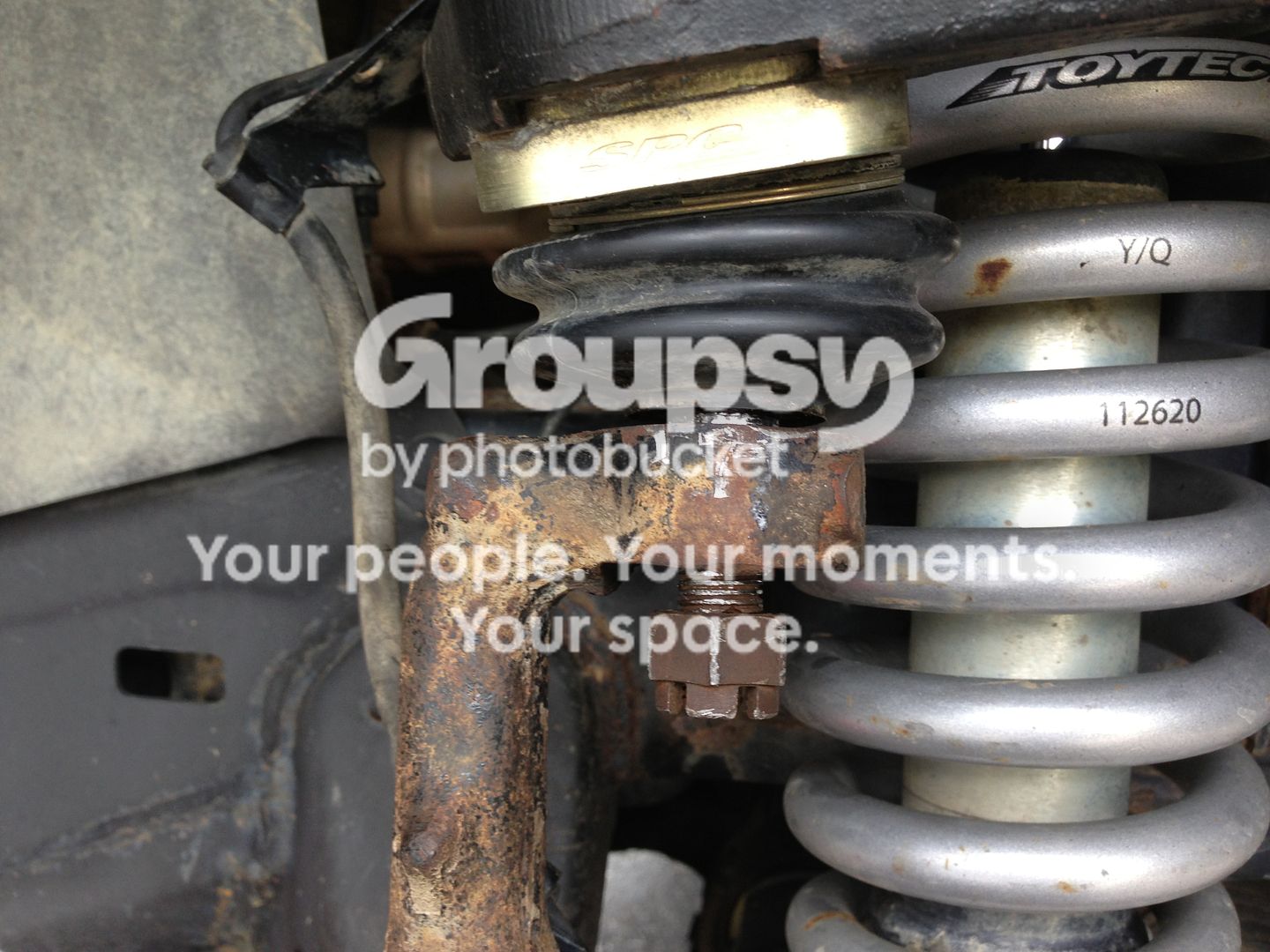

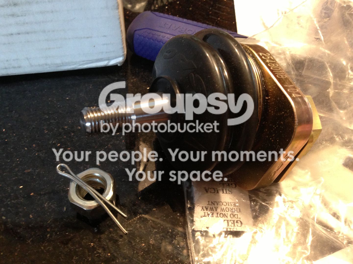

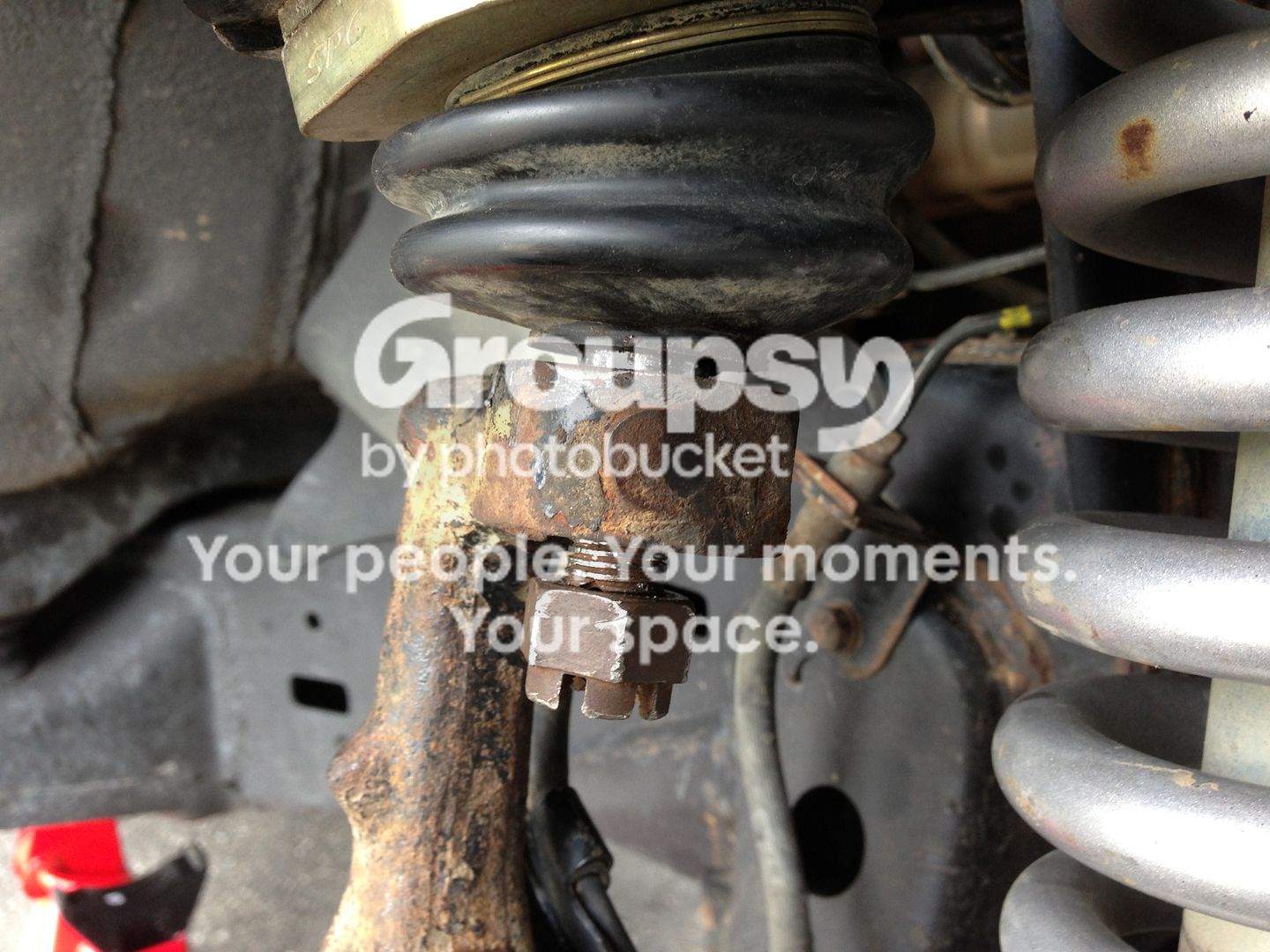

Replaced my passenger side upper ball joint because of the damaged threads on the old one. The Pitman Arm Puller must have bent the bottom of the threads very slightly, enough to not be able to put the nut back on.
Castle Nut Stuck:
null_zps187f1371.jpg~original
null_zpsf910de5d.jpg~original
New Ball Joint:
null_zpsc83e99b8.jpg~original
Got it aligned and it's all good to go!

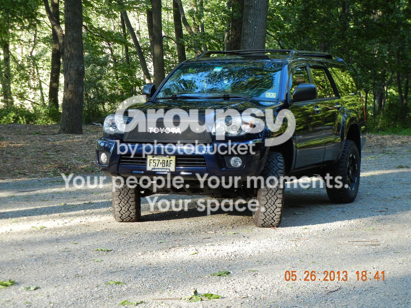

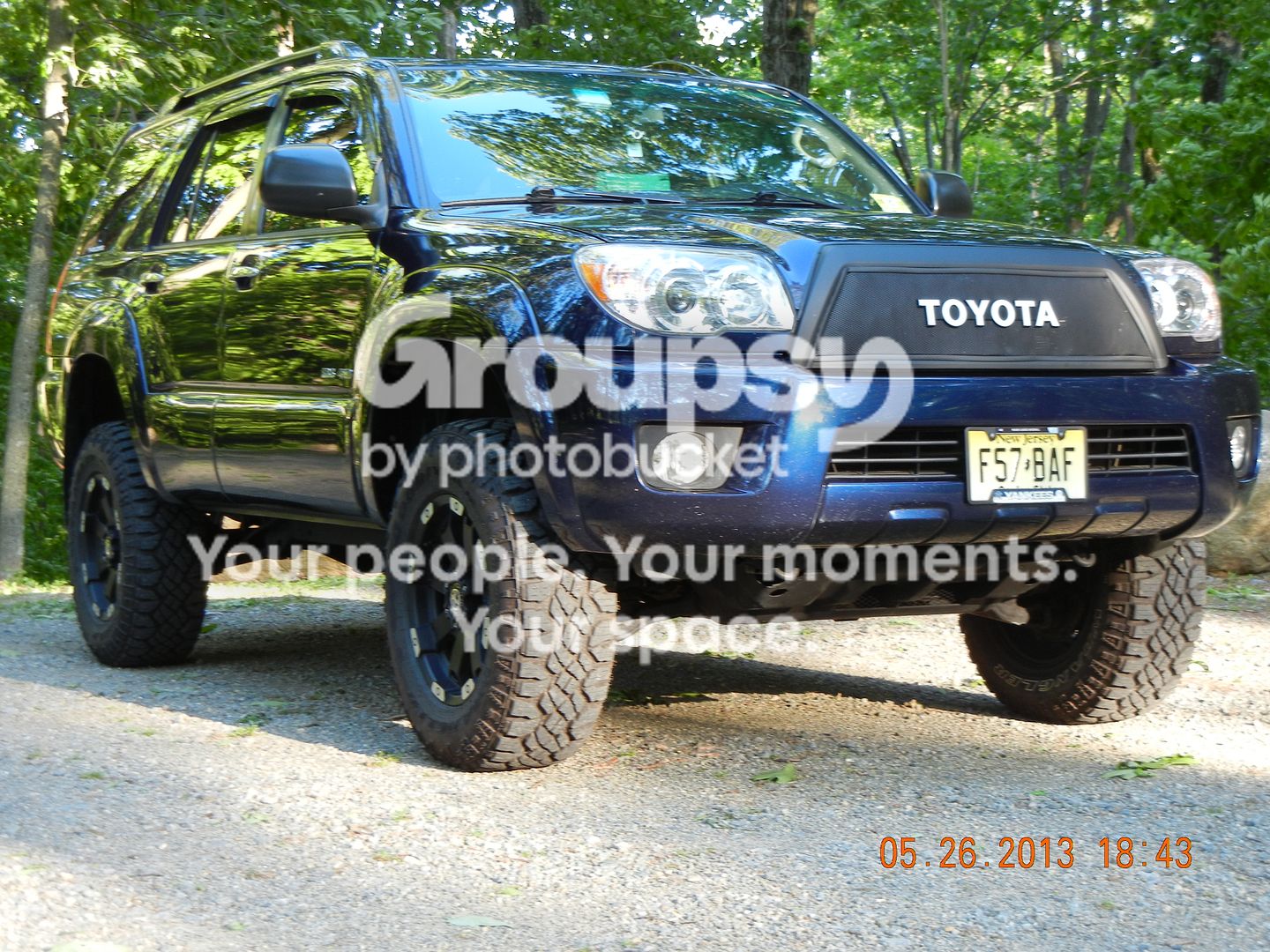

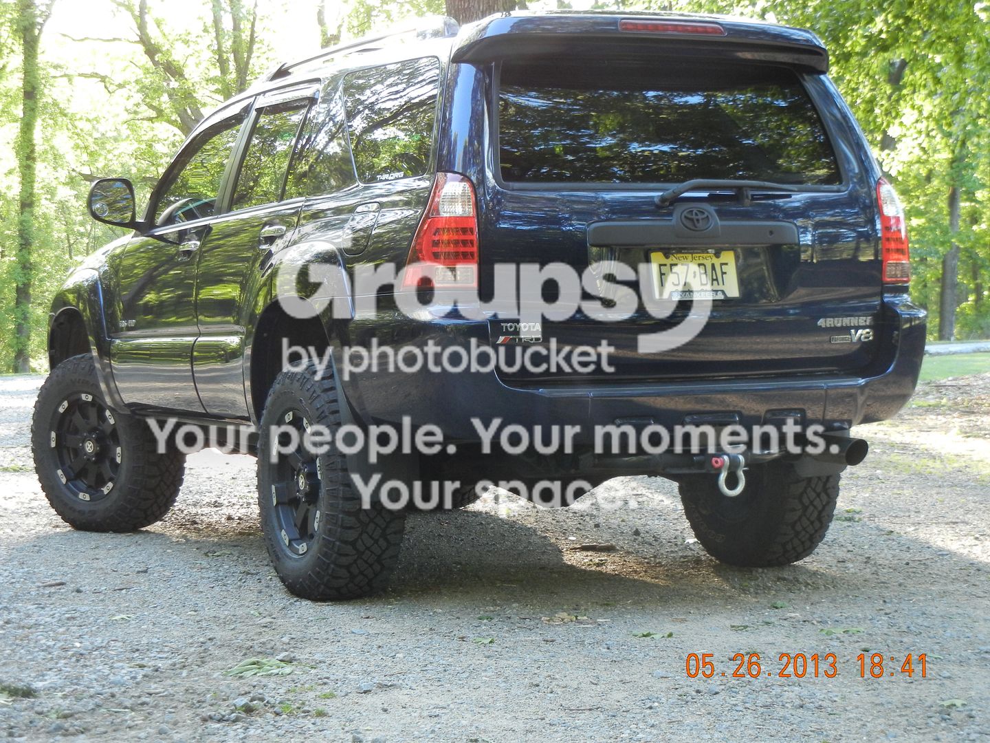

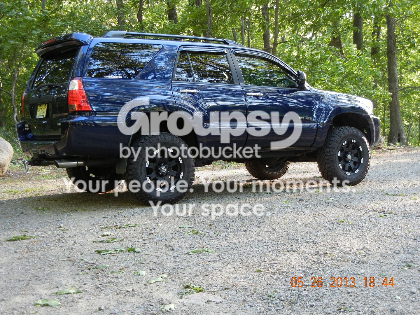

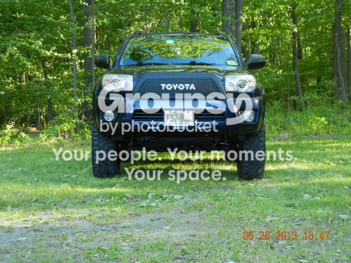

Decided I needed to do something about my lack of good pictures of this truck. Cleaned it up and took it on a little photo shoot.
DSCN1445_zps56938abd.jpg~original
How do you like the toytec setup? What height is your front and rear from the ground to the wheel well?
I love it so far. Had it on since October and it's been great so far. I actually never took measurements on it but I'll take some measurements tomorrow and report back.
