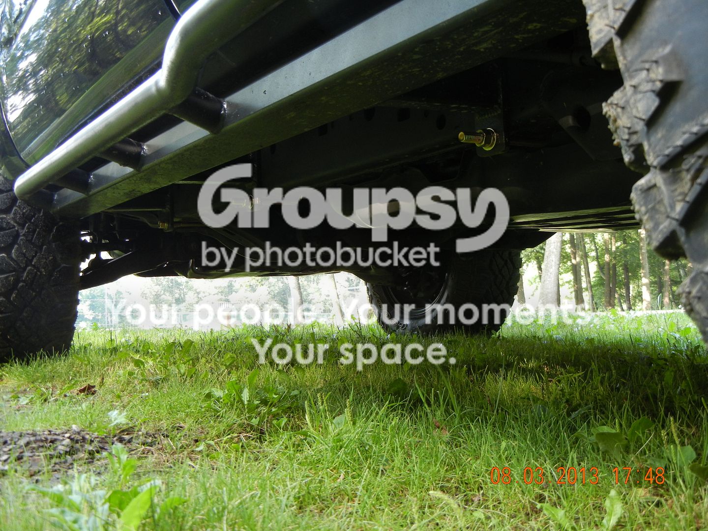

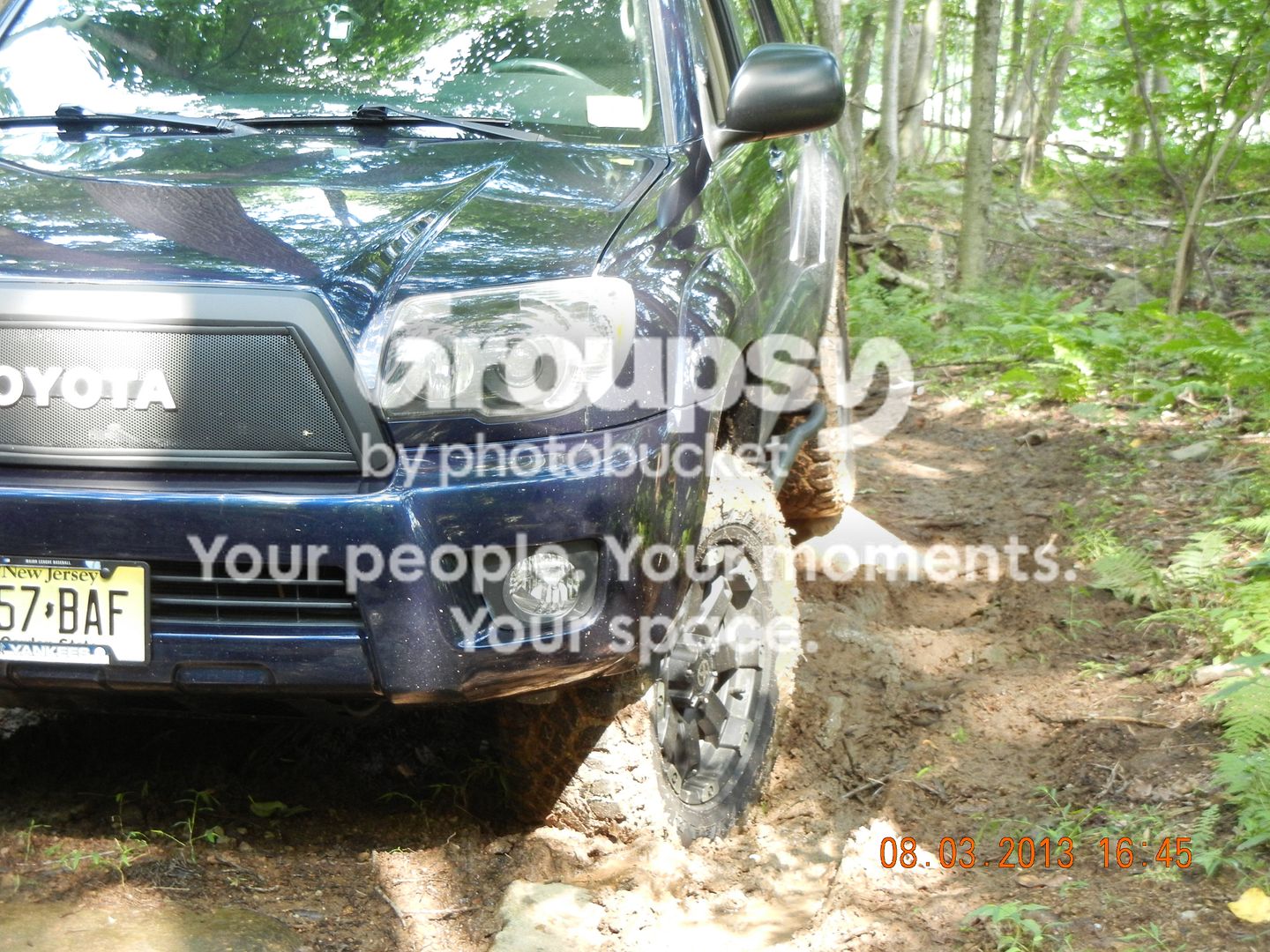

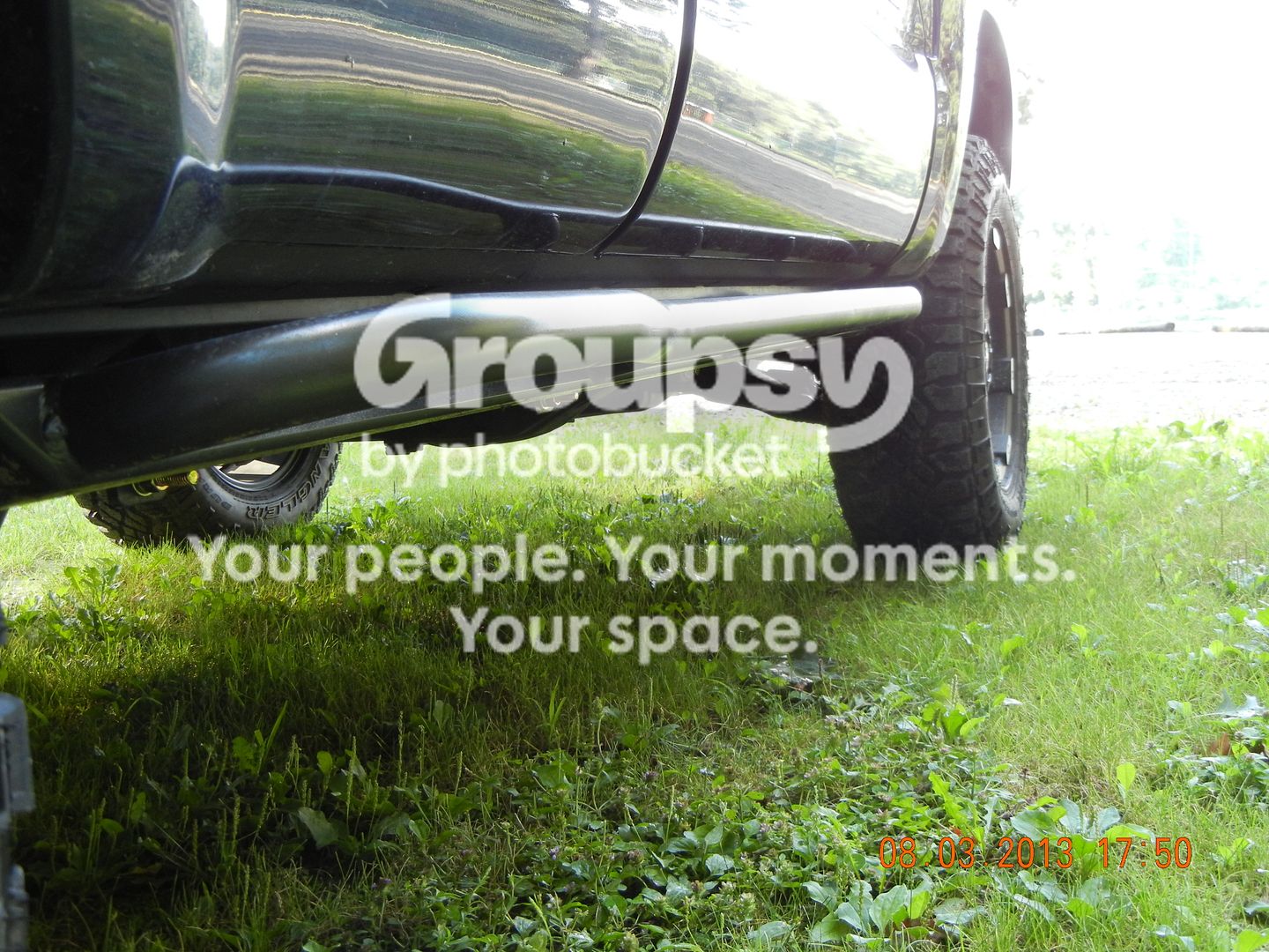

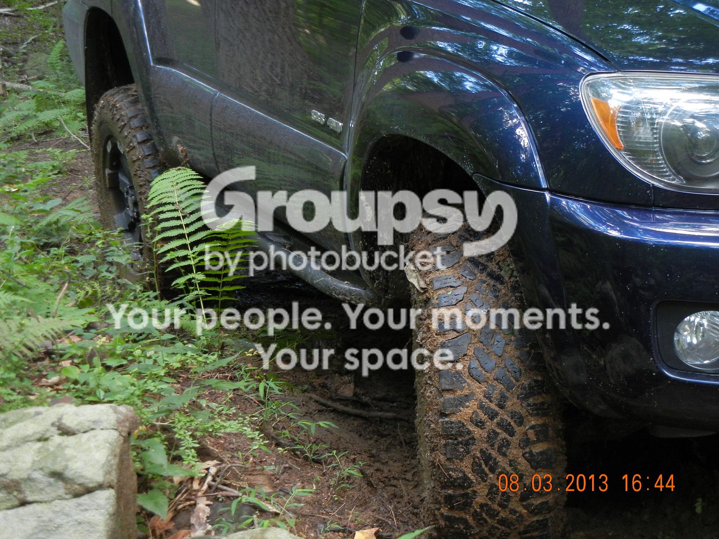

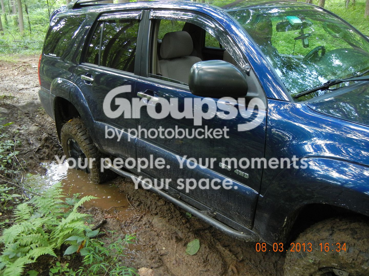

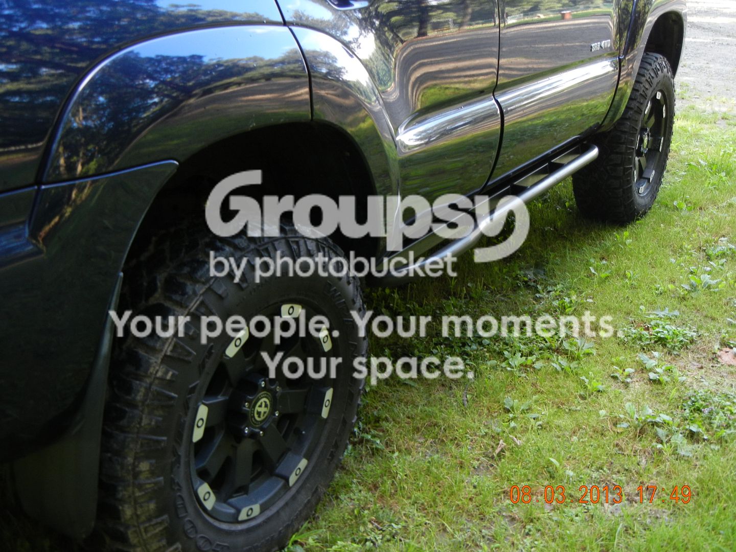

I have some more pics I can post up with the sliders on. I also got a chance to jack up the truck today using them as a jacking point, no problems, very sturdy!

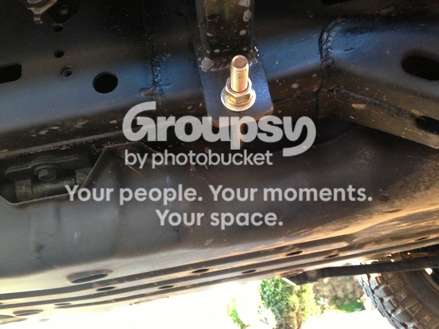

This is the mounting point by the gas tank as requested:

Good old thread revive...but Just picked up a set of these locally and hopefully install them in the following weeks. Can I ask how they held up for you or if you could use them as a jacking point?
They're holding up great. I plan cleaning them up and using POR15 after they got a little rusty over the years, just gotta find the time. They're solid and can definitely be used as a jacking point. I don't have a Hi-Lift jack so I don't regularly use them to jack up the truck but I have in the past.
