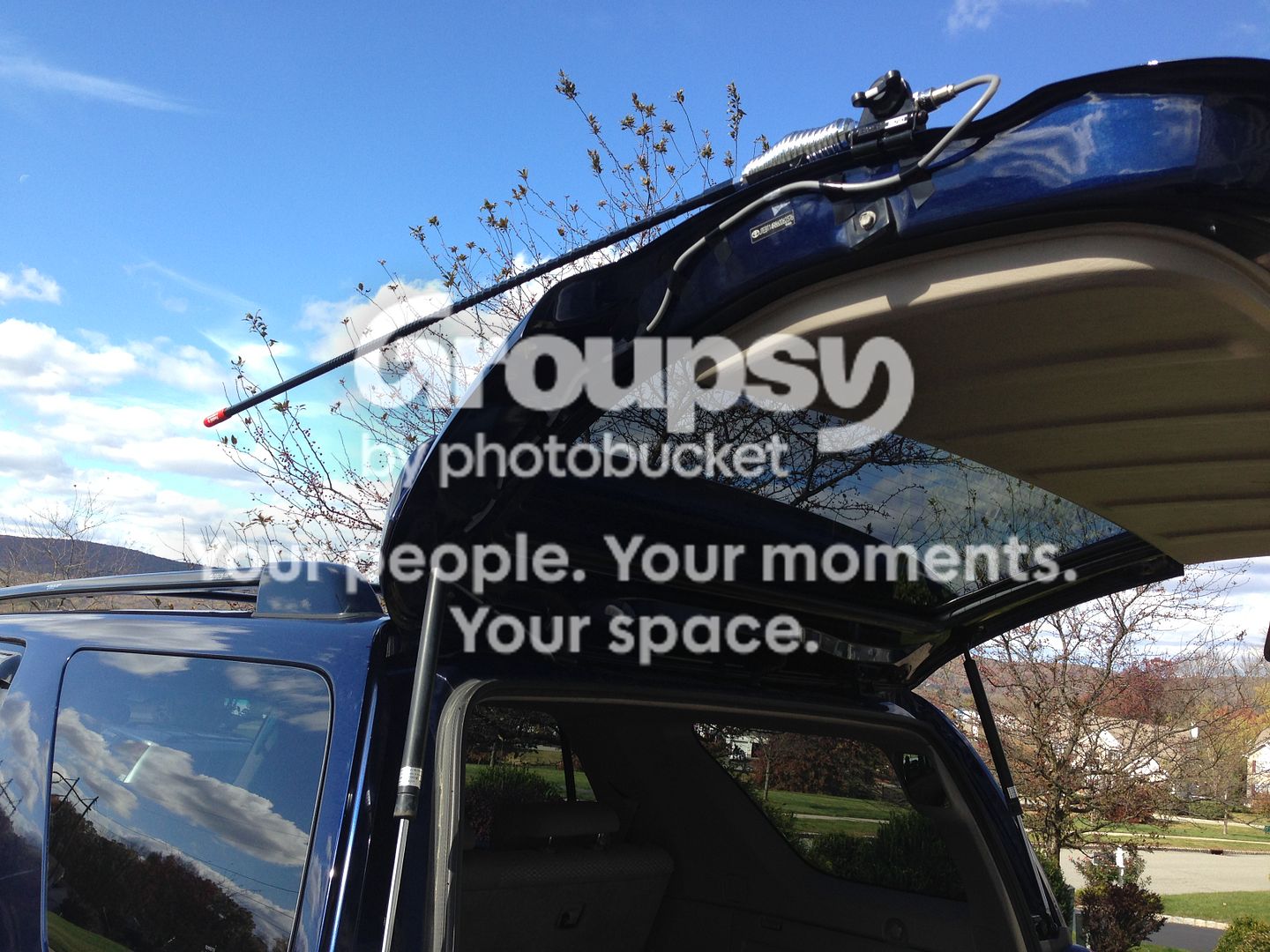

Installed my new CB Radio yesterday.
Radio: Uniden Pro520XL
Antenna: 3' Firestik

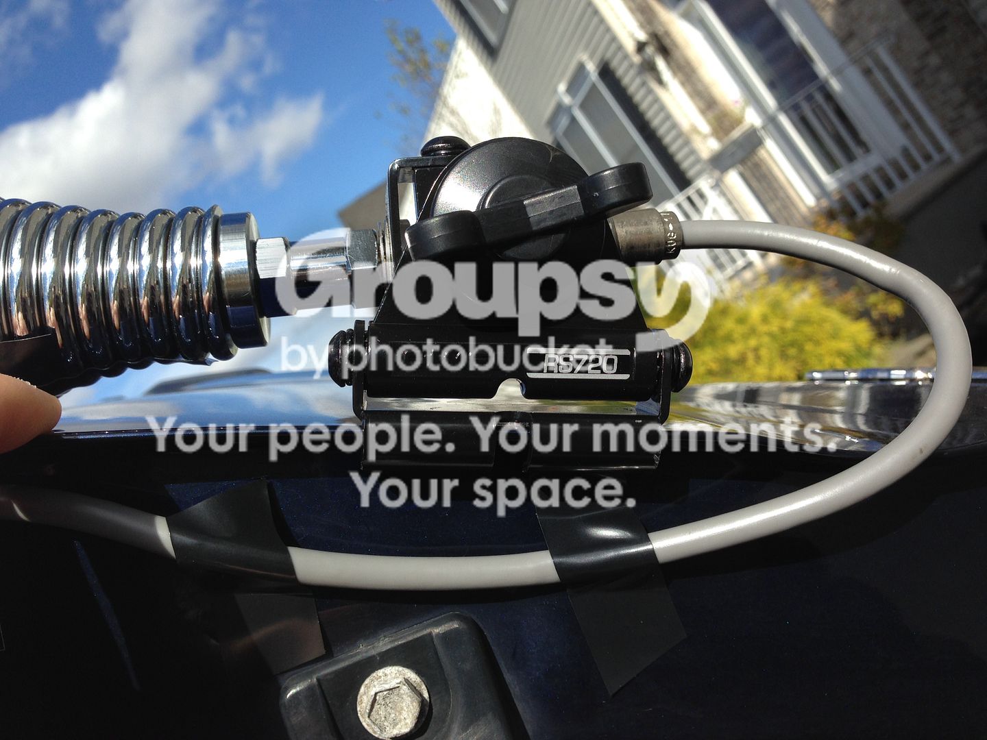

Hatch Mount: Comet RS720
null_zpsf5d4d5a2.jpg~original

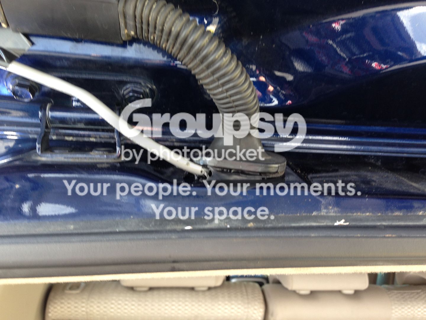

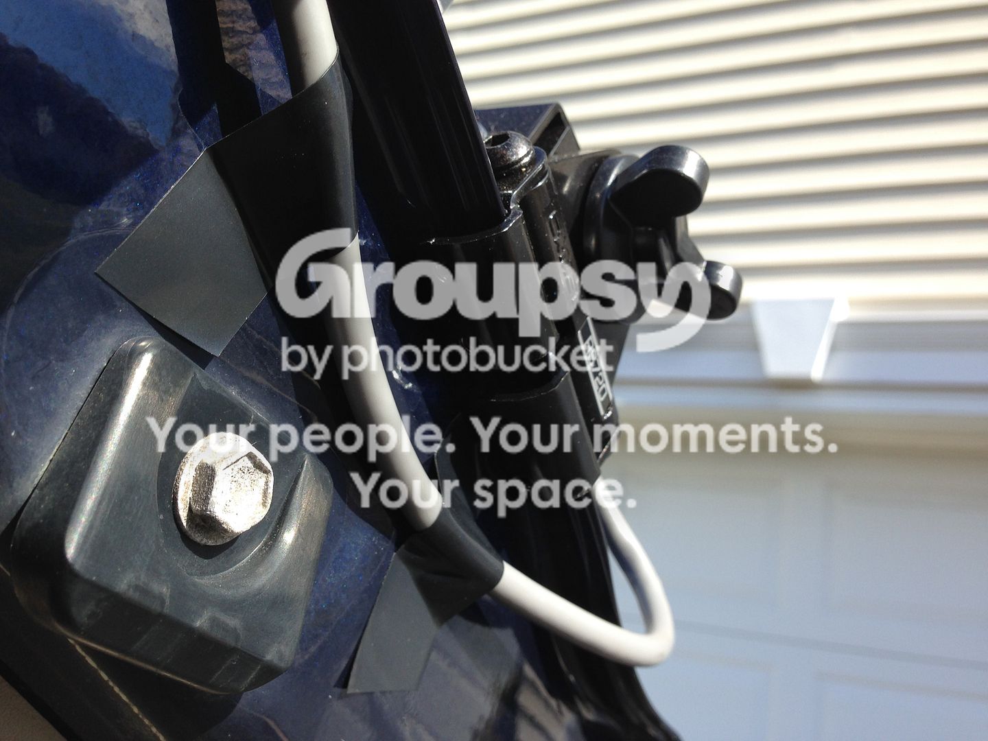

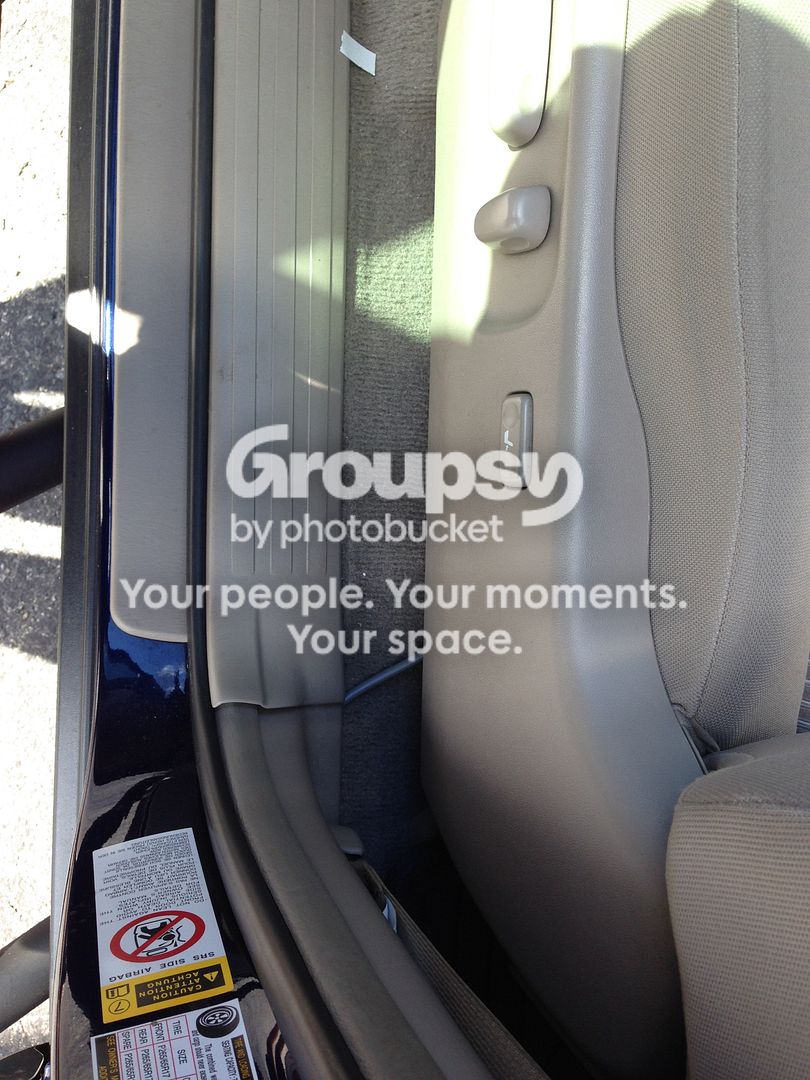

I wired the antenna through the grommet on the top of the hatch, above the headliner, inside the side body panels, down under the side kick plates and under the driver's seat. I used that Liquid Tape stuff to seal the opening in the grommet so no water or dirt gets in.
null_zpsf0c94a39.jpg~original
null_zps8a2bcefb.jpg~original

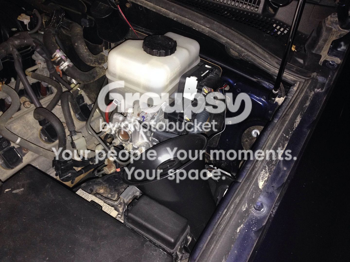

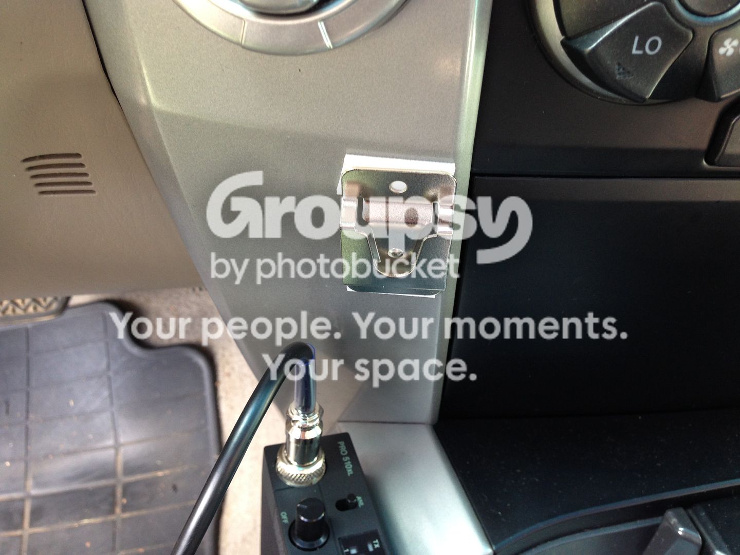

I hardwired the CB Radio to the 12V outlet in the center consol. I bought a spring for the antenna and a microphone holder at Radioshack. I put a couple strips of electrical tape on the back of the spring to avoid contact with the paint. As of now I just have the antenna wire secured with electrical tape since it's pretty strong. I'll probably look for some clips to stick on and clean the appearance up a bit but as of now this does the job. Onto the rest of the pics:

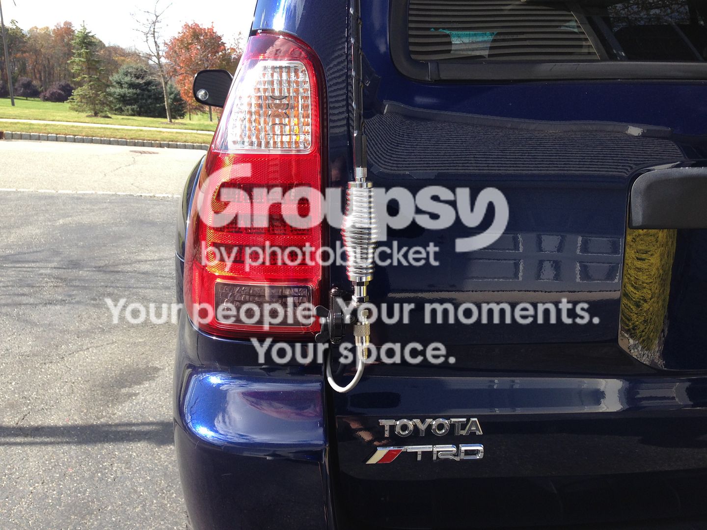

I also moved my antenna about 6 inches higher on the rear hatch and tuned it. I get great reception now and it's crystal clear.
